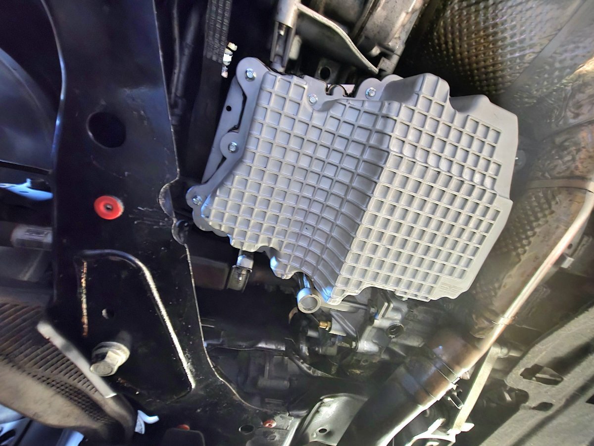

I finally found a great Ford Dealership not far from home "Ford of Long Beach" who not only told me the whole story of the horribly installed oil pans on 2015 - 2017 Ford Edge Sport with the 2.7L Ecoboost motor and how Ford had tried for years to fix the problem.
They had gone through many changes of the oil pan but still used RTV to seal it to the motor which never worked and of course this is a one time use oil pan and I had read of owners on their third and fourth pan change at over $1100 each time.
Anyway, they now have a fix in a new pan and gasket which not only did they sell me but gave me the discounted cost so I paid $300 for both parts and not $440 which made me very happy.
The part numbers should anyone be interested in fixing this annoying problem are...
Oil Pan. FT4Z6675-D
Gasket. FL3Z6710-B
I hope that this helps. I'm now off to the Auto shop to get the work done and get my wife off my back. image.gif.942e41a2d923c69a6732bd40ff20c407.gif
If you're in Southern California, Ford of Long Beach is the best.
Thanks to all,
Regards,
Doug.
