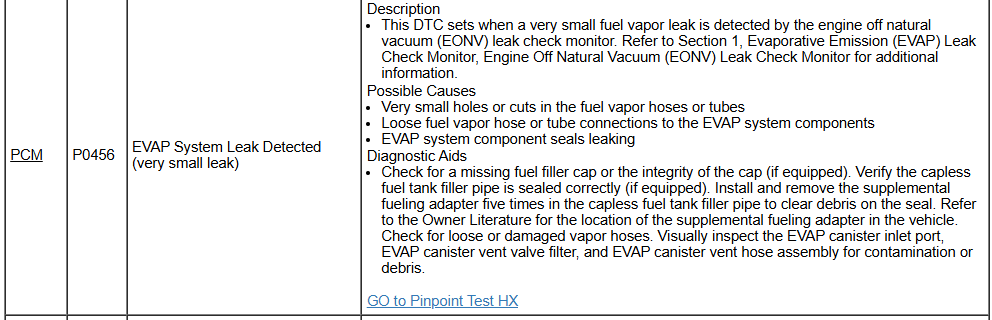

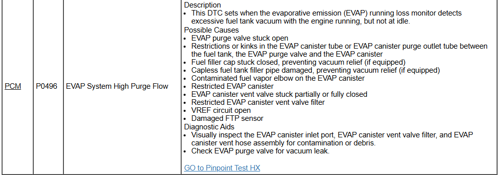

Edgernnr Posted June 14 Report Share Posted June 14 Hello. i search “canister purge valve” on ford parts. I got this. https://parts.ford.com/shop/en/us/engine/other-engine-parts/vapor-canister-purge-solenoid-p-cu5z9f945d?pdp=y is this right? Could they have it listed right by now?? Trying to find the right part. I got error code P0496 & P0456. 2020 edge 2.0 Quote Link to comment Share on other sites More sharing options...

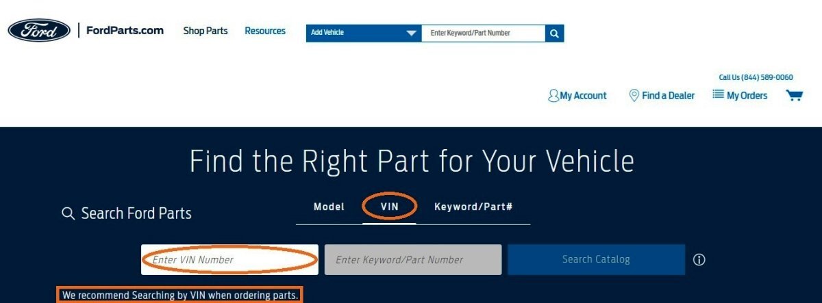

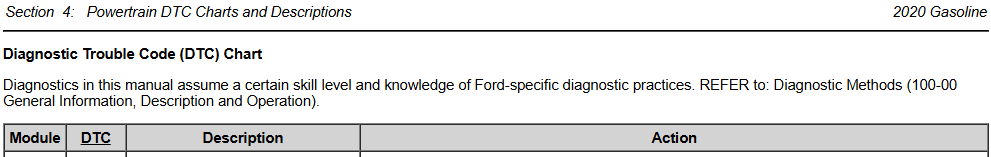

Haz Posted June 15 Report Share Posted June 15 (edited) Welcome to the Forum @Edgernnr! From the Ford Powertrain Control/Emissions Diagnosis (PC/ED) Manual... PC/ED Diagnostic Pinpoint Tests, and, Workshop Manual Evaporative Emissions component procedures, are attached below as PDF documents... Inputting your Edge's VIN at the beginning of your FordParts part search should yield the correct part and/or indicate the part is not correct for the specified VIN... Good luck! PINPOINT TEST Z - INTERMITTENT - PC-ED Manual 2020 Gasoline.pdf PINPOINT TEST HX - EVAPORATIVE EMISSION (EVAP) SYSTEM AND MONITOR - PC-ED Manual 2020 Gasoline.pdf Evaporative Emissions - Overview - Description and Operation - 2020 Edge Workshop Manual.pdf Evaporative Emission System Leak Test - General Procedures - 2020 Edge Workshop Manual.pdf Evaporative Emission Blocking Valve - Removal and Installation - 2020 Edge Workshop Manual.pdf Evaporative Emission Canister - Removal and Installation - 2020 Edge Workshop Manual.pdf Evaporative Emission Canister Purge Valve - Removal and Installation - 2020 Edge Workshop Manual.pdf Evaporative Emission Canister Ventilation Filter - Removal and Installation - 2020 Edge Workshop Manual.pdf Evaporative Emission Canister Vent Solenoid - Removal and Installation - 2020 Edge Workshop Manual.pdf Fuel Tank Pressure Sensor and Tube - Removal and Installation - 2020 Edge Workshop Manual.pdf Edited June 15 by Haz 2 1 Quote Link to comment Share on other sites More sharing options...
