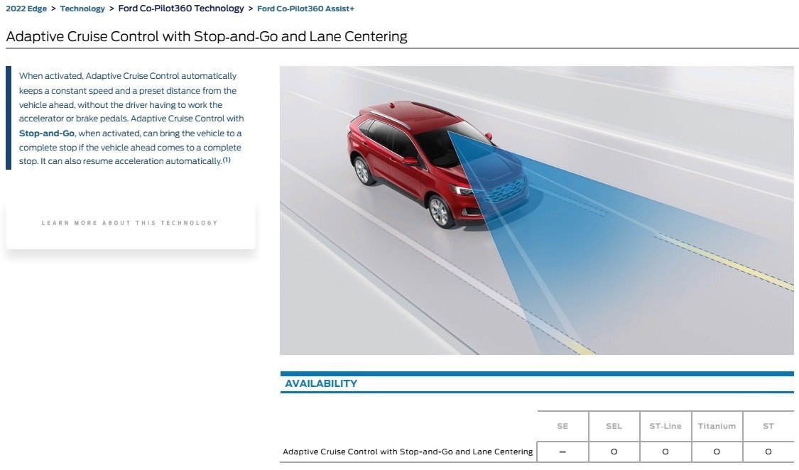

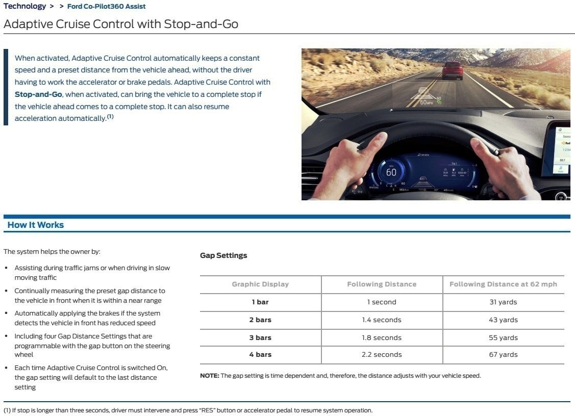

The following images describe the auto-braking feature your Edge's optional Co-Pilot 360 package provides...
2022Edge-Technology-AdaptiveCruiseControlwithStopandGoandLaneCentering.thumb.jpg.9bdad378389ca71d969eef55a17fbc27.jpg
AdaptiveCruiseControlwithStop-and-Go-FullerDetail.thumb.jpg.c70b0a2350e73ebbbcbb58099e184e40.jpg
You may want to explore submitting a claim to have the repair cost paid under the collision coverage of your auto insurance.
