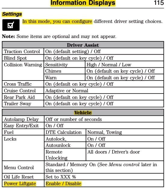

The auto/manual switch is in the menu structure, under settings->convenience.

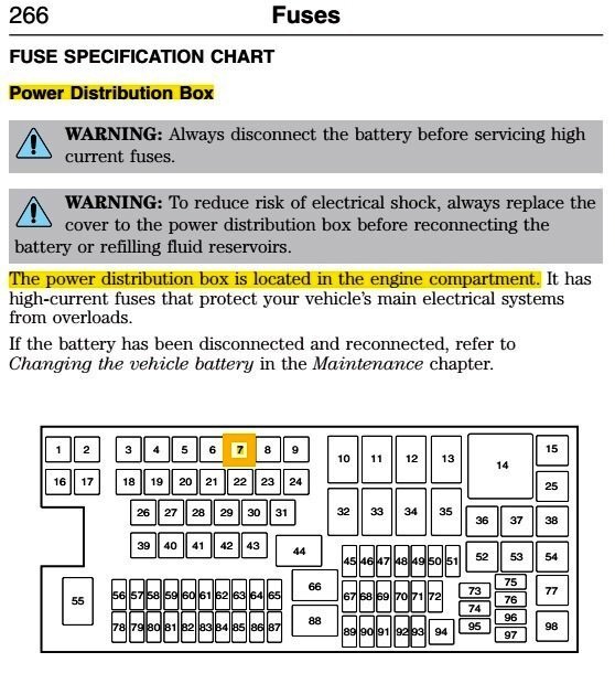

As @enigma-2 indicates, with us looking to the 2013 Edge Owners Guide pictured below (with relevant text highlighted in yellow )...
PowerLiftgate-Canbeenabledordisabled-2013EdgeOwnersGuide.jpg.6b3e2b72774b037a9fd0ce16a8651d06.jpg
InformationDisplay-SelectSettings-2013EdgeOwnersGuide.jpg.1abd329aa22c8abd7a477027ebdf5189.jpg
InformationDisplay-SelectVehicleandPowerLiftgate-2013EdgeOwnersGuide.jpg.b9c0a6bb36b0e340446a3146da07b2e1.jpg
However, before you disable your Edge's power liftgate, you may want to perform a Power Liftgate Reset to see if it eliminates the partial-opening issue...

But, rather than disconnecting the vehicle's battery to perform the Reset, removing the Fuse #7 in the Power Distribution Box for 20 seconds fully performs the Power Liftgate Reset and it only affects the Power Liftgate circuit...
PowerDistributionBox-InEngineCompartmentonLH(Drivers)Side-2013EdgeOwnersGuide.jpg.8f163a4d159b030774af4db951c11c6b.jpg
PowerDistributionBox-Fuse730ampPowerLiftgatecircuit-2013EdgeOwnersGuide.jpg.ec894e933e71db99d165e622c21ff5a6.jpg
Please consider reporting back here on what effect the Power Liftgate Reset has upon the partial opening issue.
Other diagnostic steps are available if the Power Liftgate Reset procedure provides no improvement.
