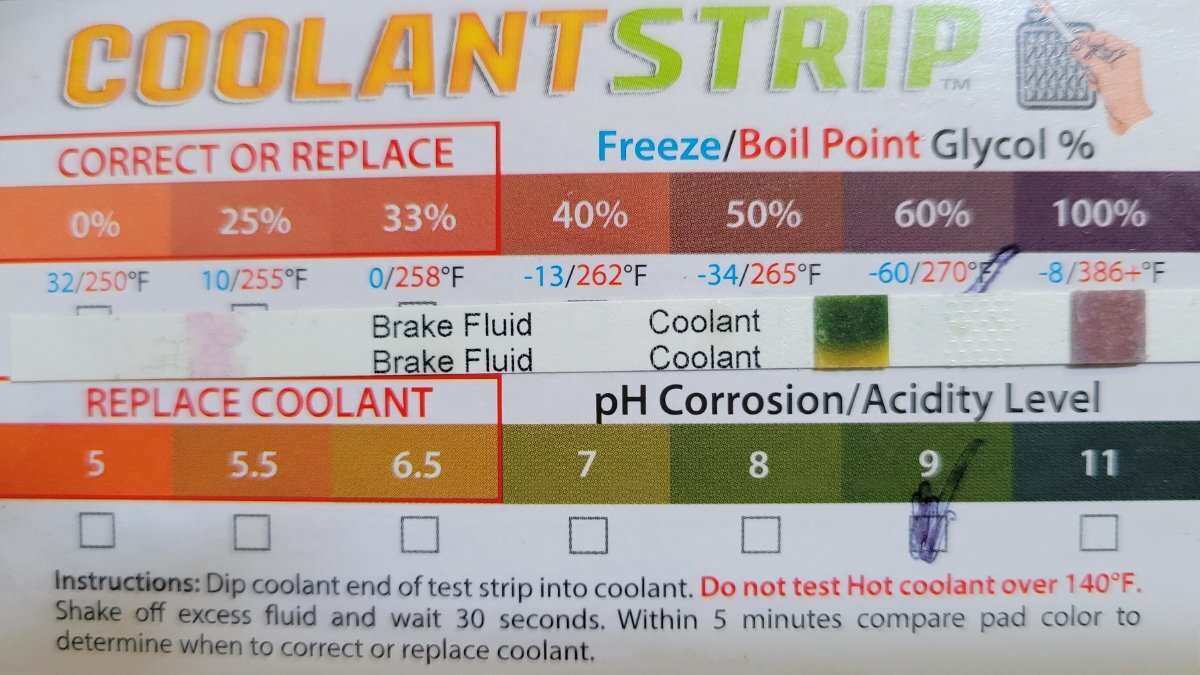

flymore Posted June 24 Author Report Share Posted June 24 Anybody try Phoenix Systems coolant test strips to see if you're changing coolant too early or too late? Quote Link to comment Share on other sites More sharing options...
flymore Posted June 27 Author Report Share Posted June 27 My Phoenix Systems coolant test strips arrived today. Results show my coolant is still ok after 2 years. I'll keep watching it. Quote Link to comment Share on other sites More sharing options...
