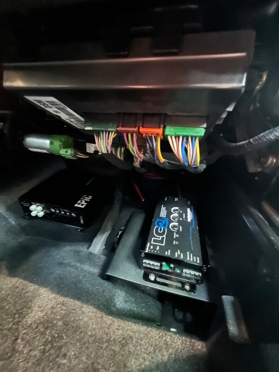

Today I mounted the amp and LOC under the seat.  I bought a piece of plexiglass from Lowe’s and cut it slightly larger than the amp.  I then put it under the carpet and screwed the amp down to it.  I screwed the LOC down to the plastic cover that covers the seat control module.  I fished the amp power wire under the carpet and it is ready to be cut and hooked up.  At this point, I am ready to ground the amp, hook the power wire, hook up the sub speaker wires and hook the signal and RCA cables up.  Since I am using two AudioControl components, they included a power wire harness with the amp along with an imbedded one amp fuse, to power the LOC, simplifying the install.  All I have to decide is whether to let the amp automatically sense the signal and turn on both components or run a remote turn on wire.  Pics in the next post showing progress and hopefully to help someone else planning to do an install.

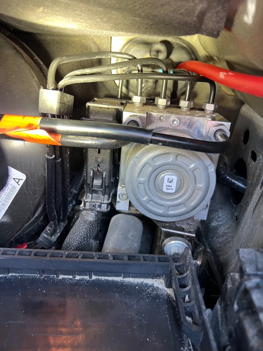

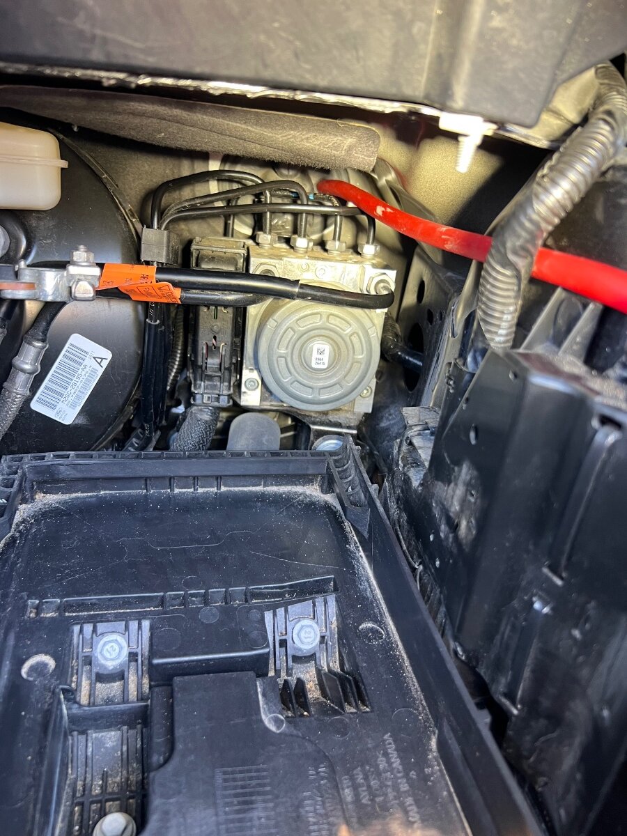

Power wire run… Don’t know how some did this without removing the battery.  Took 10 minutes to remove the battery and it gives full access to the grommet, although the brake fluid distribution block does sit somewhat in front of it.  I poked a long screwdriver through the divot and then taped a 12 gauge wire to my 4 gauge wire and pulled in through from the engine side into the cabin.

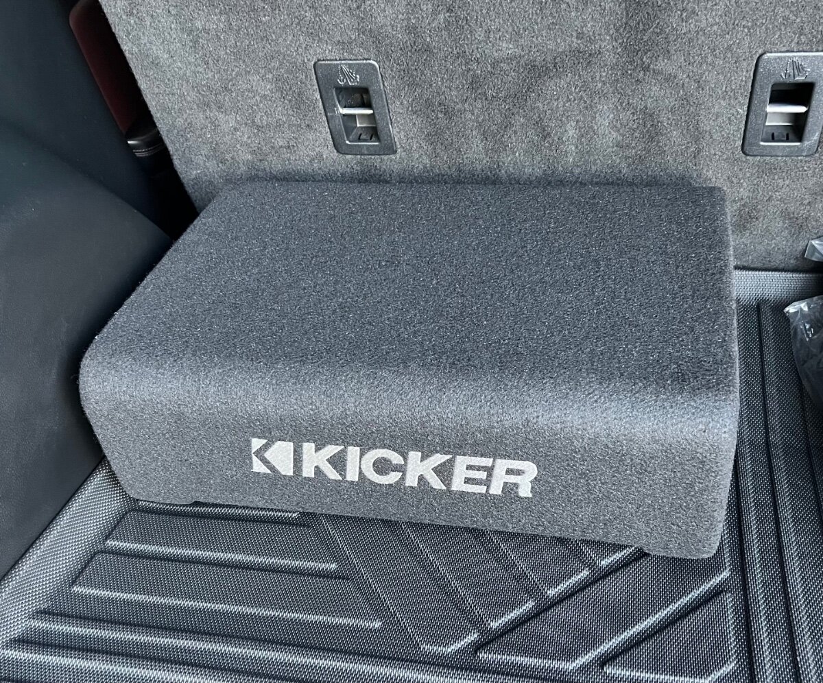

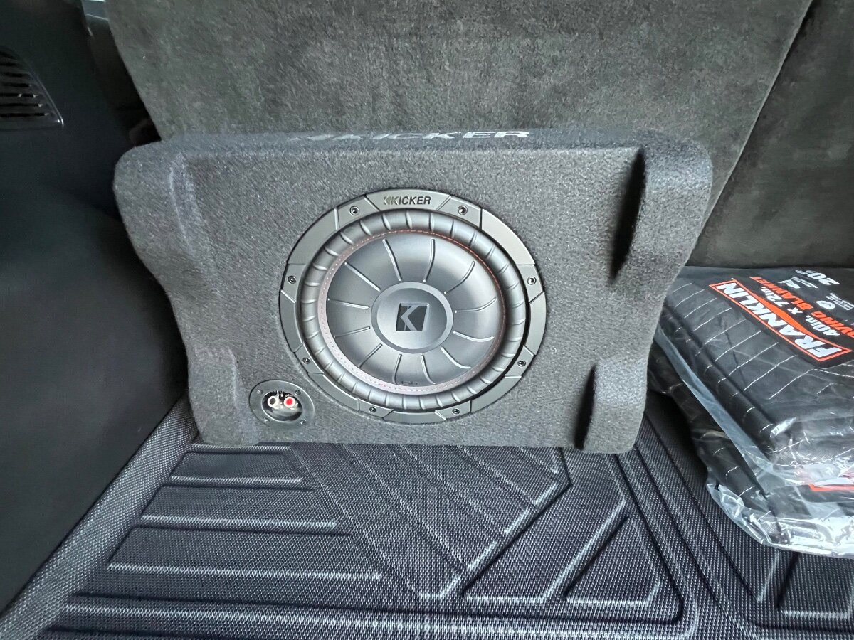

The Kicker sub, 48CVTDF102, 10” CompVT sub rated at 350 watts RMS @ 2 Ohms.  This was originally bought to go in my Acadia as it fit perfectly between the second row captains chairs on the floor.  That install never happened and the sub sat brand new on the shelf, until now.
Edited by 22CarbGrayElite

Just seen your post, otherwise I would have spoken up sooner.
This may be a mistake.
Taken from page 192 of a 2022 owners manual:
WARNING: Vehicle modifications involving braking system, aftermarket roof racks, suspension, steering system, tire construction and wheel and tire size may change the handling characteristics of your vehicle and may adversely affect the performance of the electronic stability control system. In addition, installing any stereo loudspeakers may interfere with and adversely affect the electronic stability control system. Install any aftermarket stereo loudspeaker as far as possible from the front center console, the tunnel, and the front seats in order to minimize the risk of interfering with the electronic stability control sensors. Reducing the effectiveness of the electronic stability control system could lead to an increased risk of loss of vehicle control, vehicle rollover, personal injury and death.
If the amp and LOC prove to be an issue, I will move them to the cargo area.  I have installed amps under the seats of a 2014 Impala I once owned and never had any problems.  We shall see, good to know regardless.
