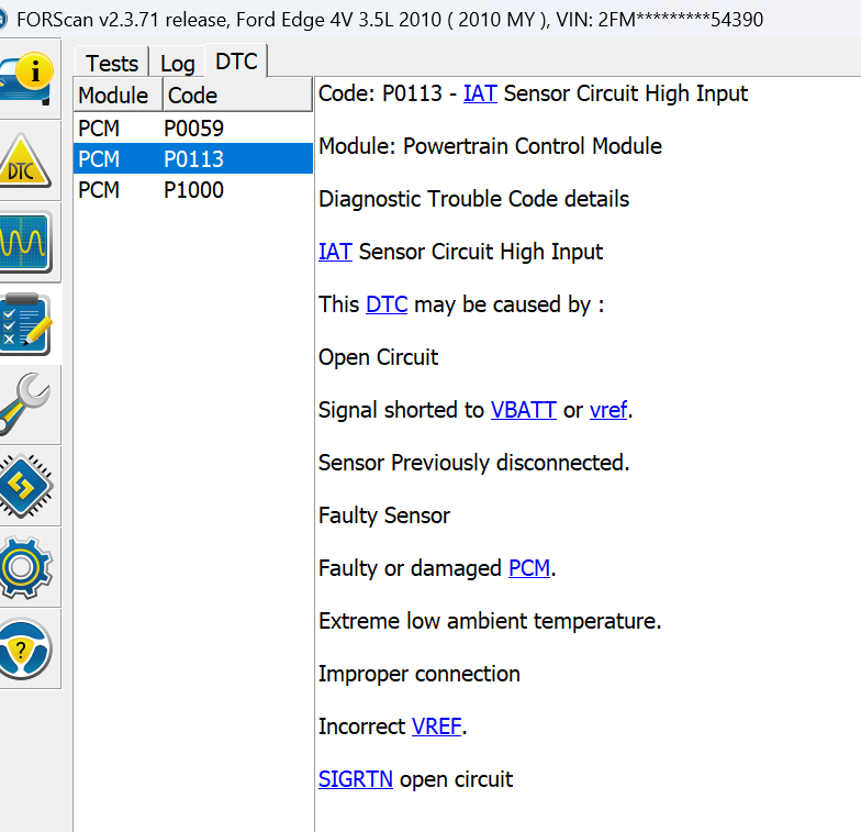

lalondem_98 Posted 18 hours ago Report Share Posted 18 hours ago I changed the 3.5l using a 2010 engine installed into a 2010 ford Edge, I re-used my wiring harnesses, I fixed 3 coils connectors (due to locking tab broken), i fixed 1 camshaft position connector (due to locking not working, I removed and re-inserted the sensor). The engine started a few times for a few minutes and died suddenly and softly (no noise or explosion!). Now I cannot start it anymore, I pulled out one spark plug and I have no spark when I ground the bottom electrode. When the engine dies the battery voltage is around 12.2 volts, the alternator is new and my Dewalt battery charger says the alternator is good. Any idea? When the engine ran for a few minutes it was always smooth and quiet, not rough or noisy (I had a big smile on my face that vanished when it died!) Quote Link to comment Share on other sites More sharing options...

lalondem_98 Posted 14 hours ago Author Report Share Posted 14 hours ago Thanks for your reply, I am using Forscan, the PCM self-test with the ignition key ON and engine OFF would be good but it does not go too far as it encounters problem with the IAT (Intake Ambient temperature)...let me check into that. For the alternator it is a rebuilt one, not an OEM. For now my question would be: what can cause a no-spark condition at an individual spark plug if the individual ignition coil is good? Quote Link to comment Share on other sites More sharing options...
1004ron Posted 10 hours ago Report Share Posted 10 hours ago Clearly the alternator isn't working and its possible that could be causing some or all of the issues preventing the engine from running when the battery drops too low. Those codes would not prevent it from running. Is the power to the coils with just the ignition ON ? Quote Link to comment Share on other sites More sharing options...
