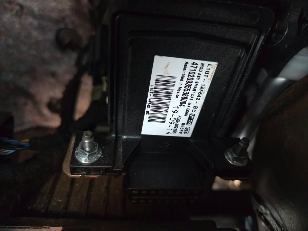

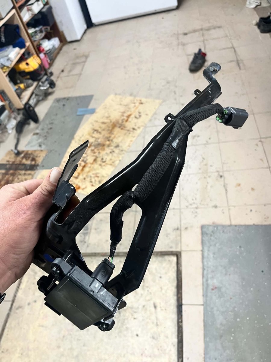

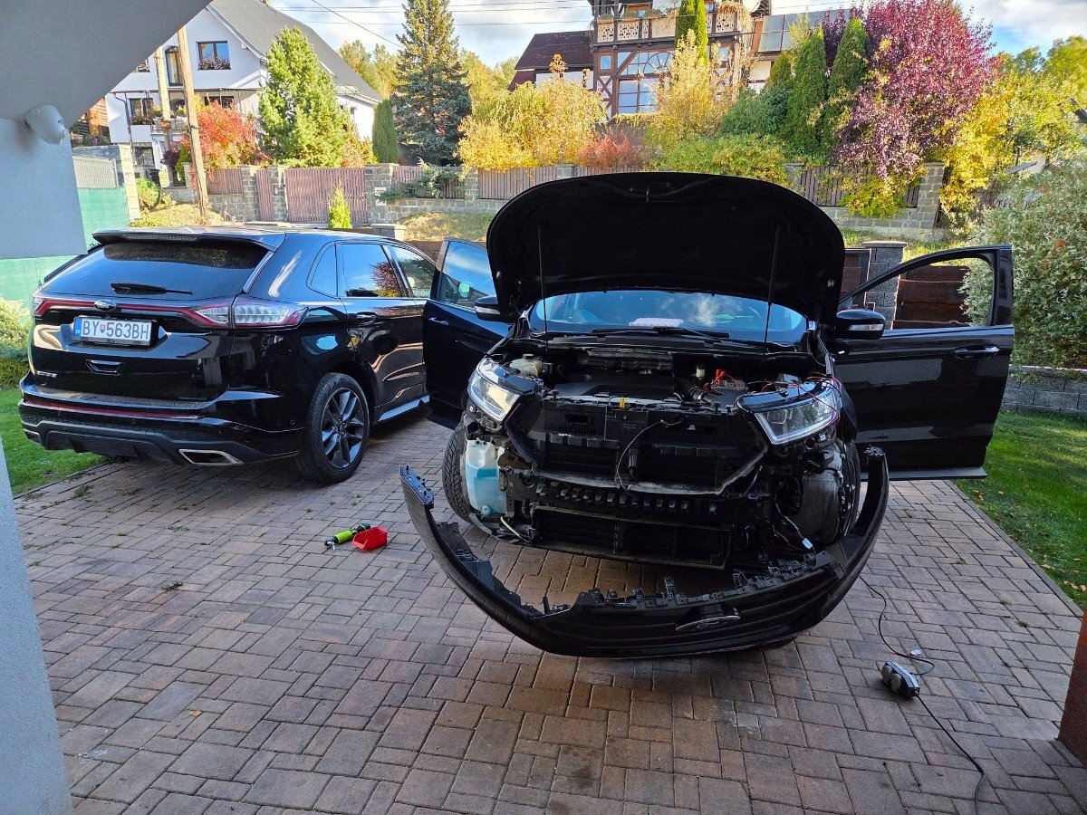

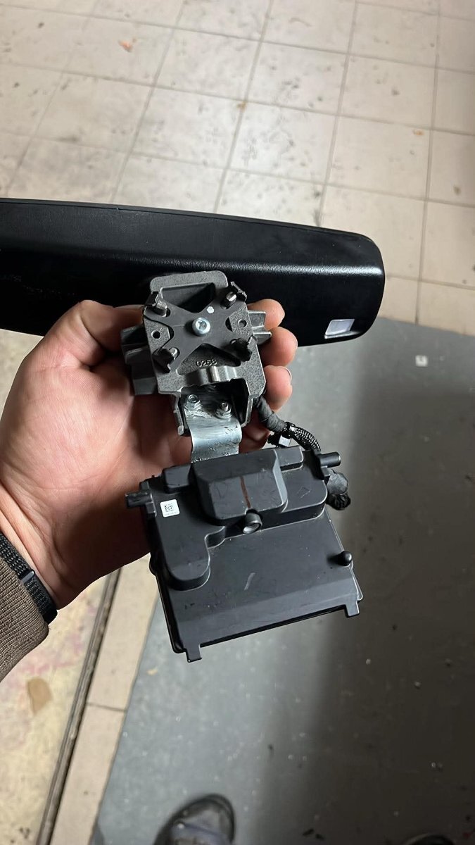

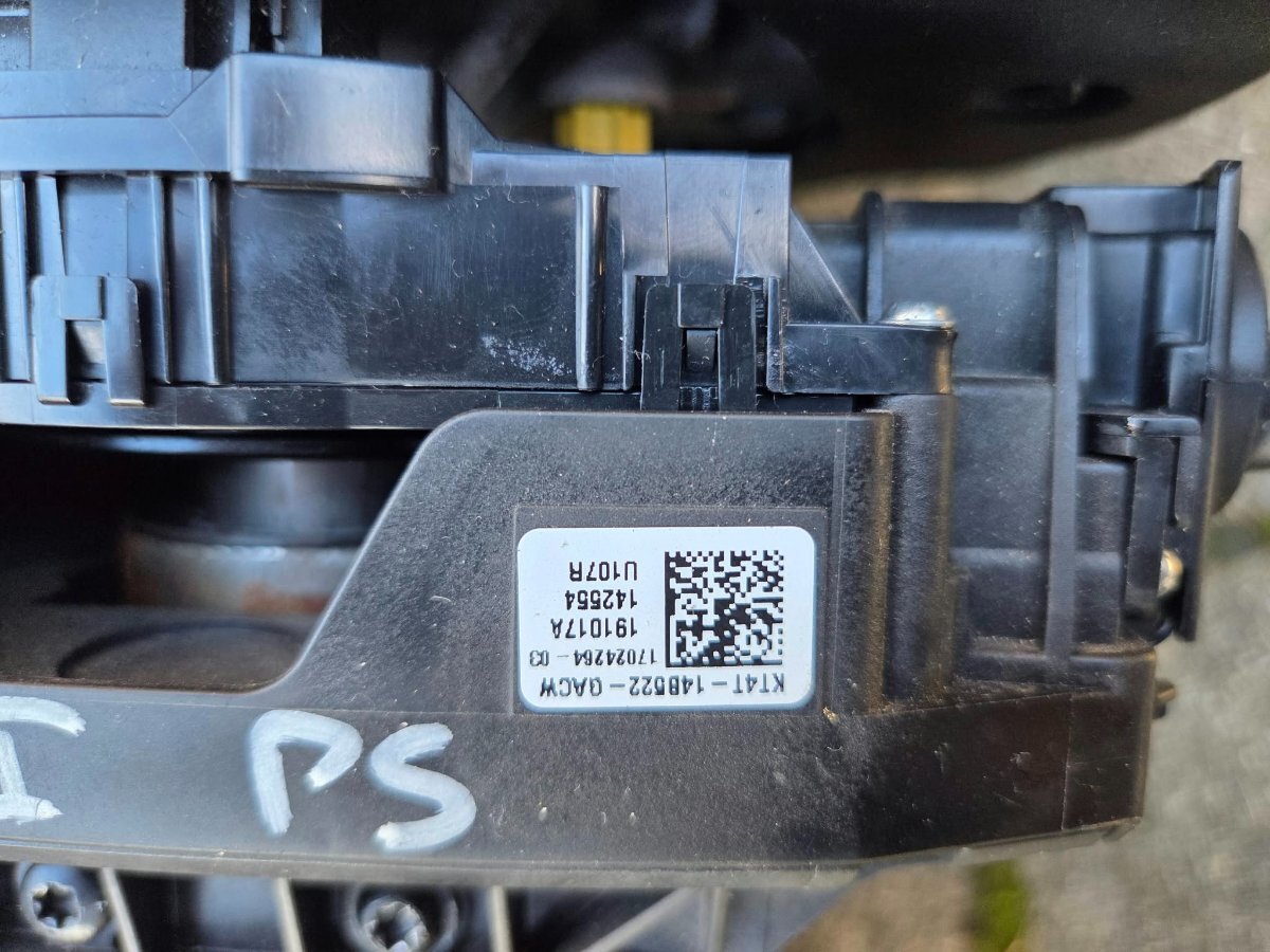

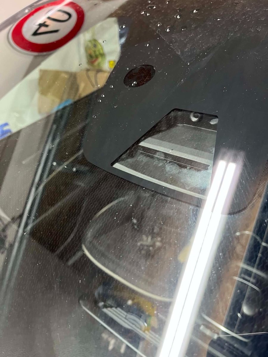

I’ve started the retrofit: currently installing the CCM with its own bracket and the IPM-A with its own bracket; I’m swapping the SCCM for button compatibility and adding an HCM module from a Galaxy so the matrix headlights work—the bus wiring had to be changed as well. I still need to swap the PSCM, but I have to put that on hold since I’ll be away for three weeks. I’ll add the configuration and all the details—including the parts used and more detailed photos—after the replacement is done.
-----------------The adaptive cruise control and lights are already working; for lane centering, I still need to replace the PSCM.
