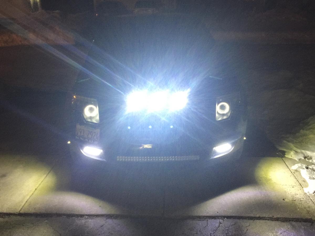

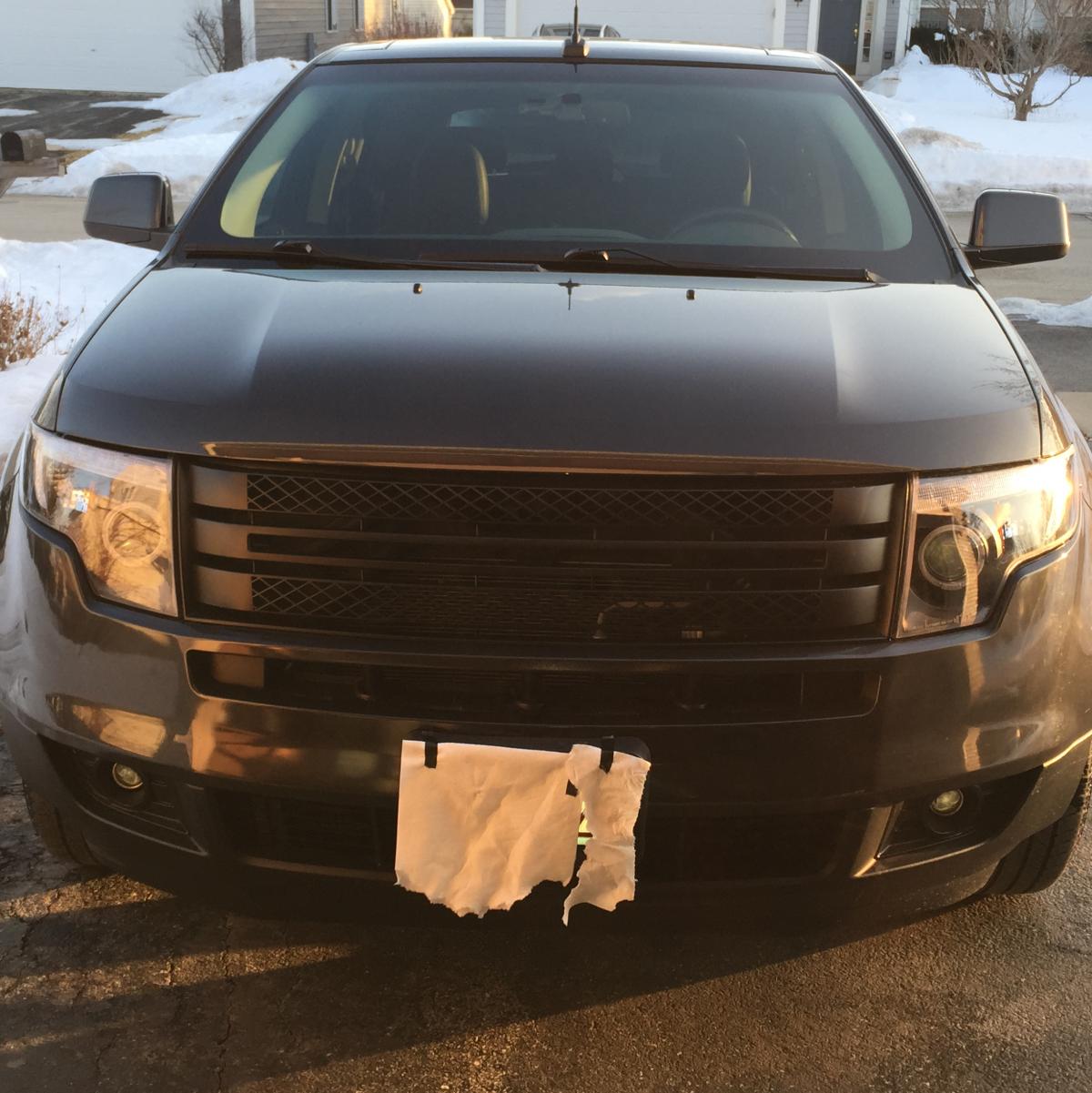

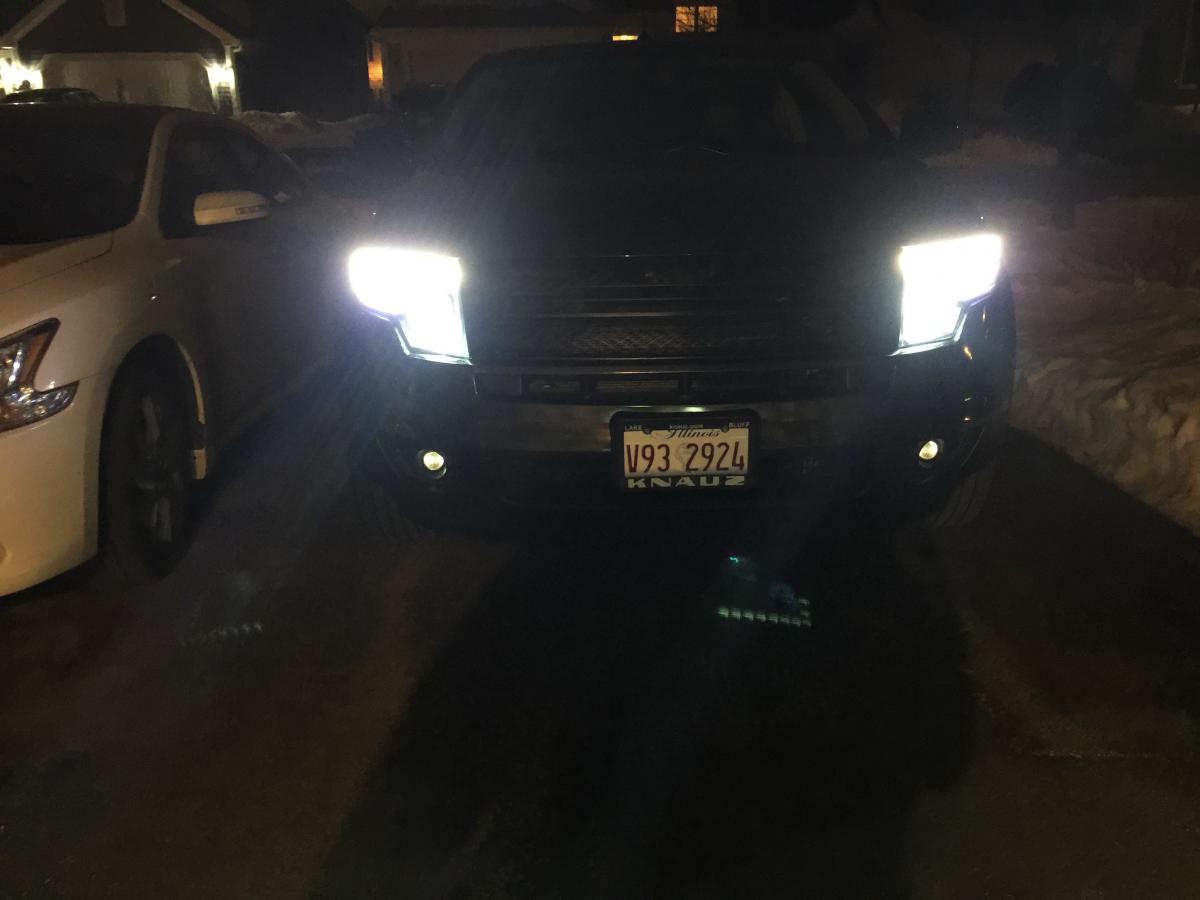

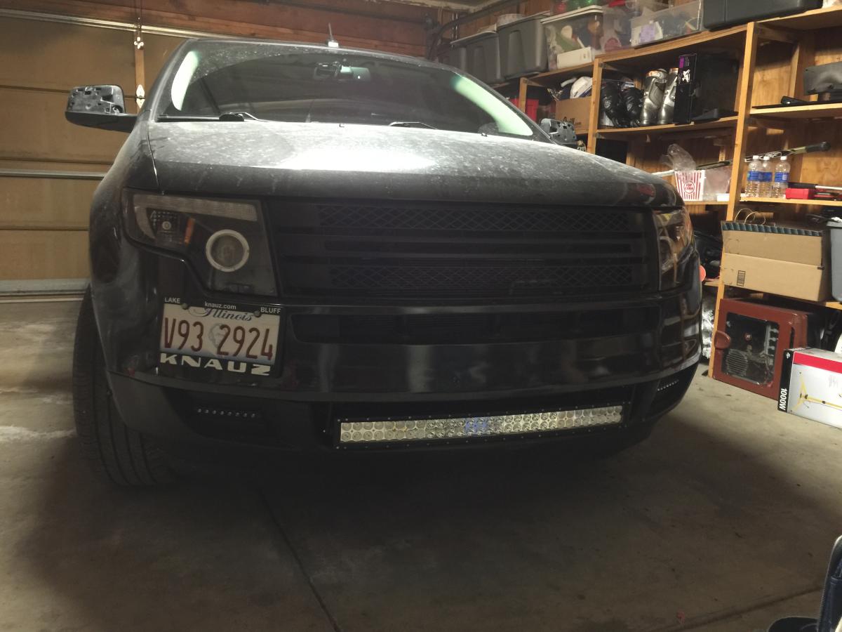

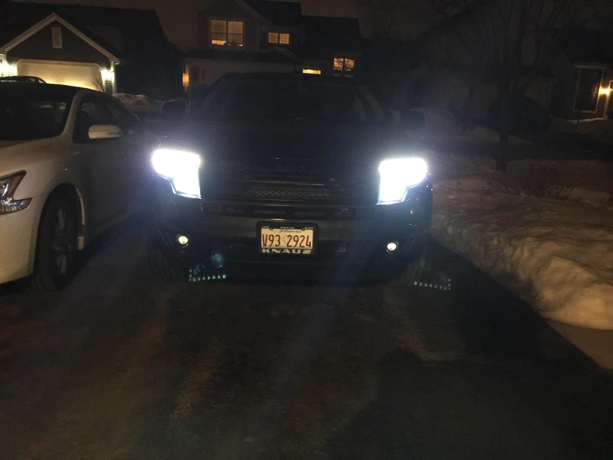

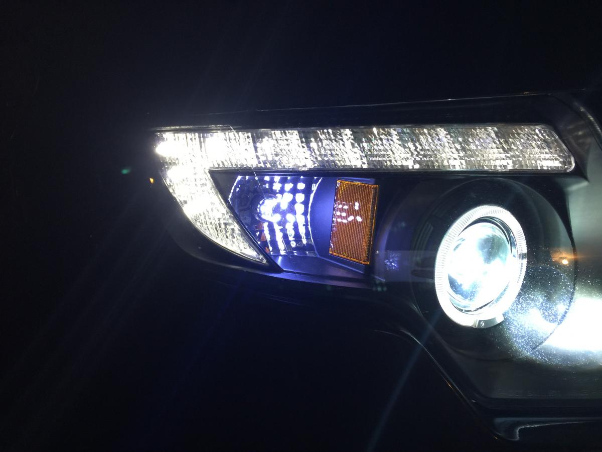

You have a picture of how they actually look on a real (not showroom) car?
yea go here http://www.fordedgeforum.com/topic/13407-what-have-you-done-towith-your-edgemkx-today/page-14
Page 14 and 15 i have a few different posts with the light on and off and different angles and so forth. just follow the transformation pics i tricked my edge out pretty heavily. Unfortunately mostly iPhone pics so they aren't the best pics to look at but you'll get the idea of how they look. you'll also notice the top led bar in the headlight not on in if the later pics that because i rewired to turn signal wire so that the halos shine by themselves at night with my led driving bar.
