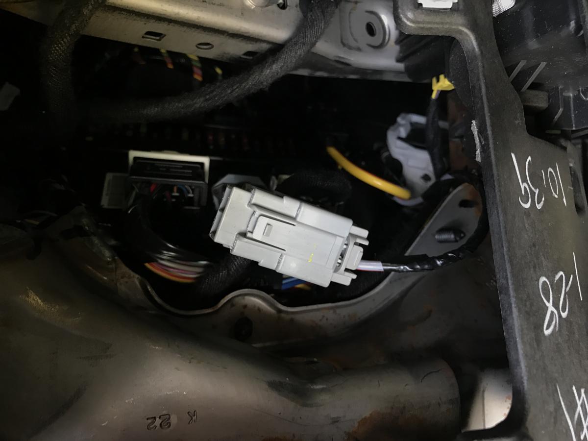

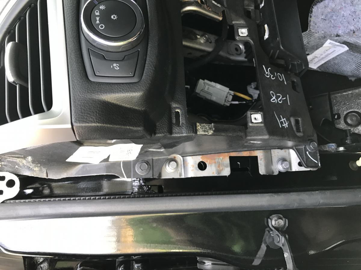

So I decided to dig in and see if I could find out whether I had this antenna installed or not in my 2015 SEL today. Attached are some pictures of my findings, or lack there of anyway.
I expected to find an antenna between the drivers door and dash, but saw nothing. Also looked behind the dash for a module, but once again saw nothing. I did find a grey plug with a grey/red wire that was tied to another harness and capped off, maybe this is the connector I'm looking for somehow.
So, if anyone wants to pitch in and help, pop the little sunglass holder out and look behind it for this grey/red wire, and see if it's plugged into anything. The sunglass bin is held in with 4 clips that can be popped out with a small 90 degree pick or a flat head screwdriver.
I'm hoping somehow that the module is located elsewhere, and that the antenna connects to this empty plug, but maybe that's wishful thinking.

Already did that,, it shows an antenna and that's it. Doesn't show what the antenna connects to, nor which vehicles already have it in place.

You should see a "T" harness coming off your OBD port. Then you should have the VSS (vehicle security sensor) box attached to the second OBD port.
The remote starter aerial antenna connects to the TPMS sensor in the rear LH quarter panel.
At least that's how it did in the 2013 & 2014 edge.
https://accessories....aerial-asy.html
That is for the old body style 11-14.  The reason it likely shows 15 is the 11-14 platform was still used for some countries in 15.
North America the 15-16 are the same and 11-14 are the same.
In the Edge the gateway module that the post-factory OEM kit plugs into is way up under the dash to the upper right steering column.  Kinda a pain to get to.  It doesn't plug or "T" into the obd connector.
