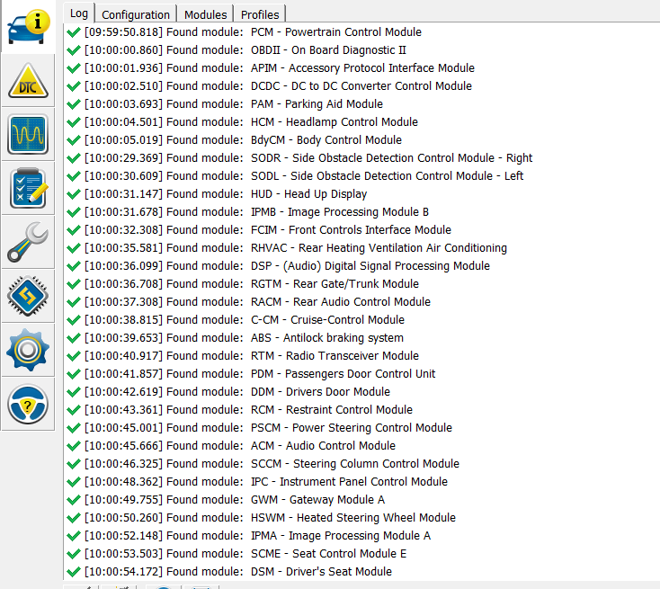

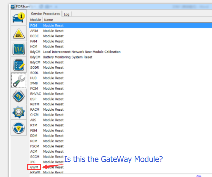

It sure does, I been in contact with him, ask him if it compatible with a UK model,
He said as long as I have the gateway module that the device plugs into,
I can't find it on mine,
but am sure forscan tells me I have a gateway module A
