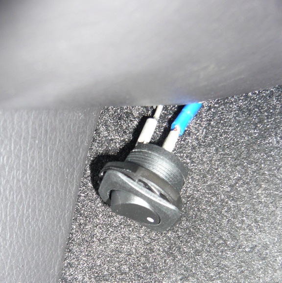

Lex Talionis Posted May 20, 2008 Report Share Posted May 20, 2008 (edited) (add disclaimers, risks and caveats here about what damage you could do or warranties you could void by doing a trick mod like this) As promised.. I built and put a switch inline that allows me to switch off all internal lights with 1 push. I removed the 15a fuse #9, took the 15a fuse and modified and cut open the fuse (no need for the fuse function as I need the circuit to NOT be complete at that fuse, but up stream at the inline fuse, I just needed it as a means to make a connection into the fuse box) and soldered onto it the 2 wires so the fuse box connection is more clean and precise then jamming 2 wires into the open fuse holes, put an inline 15a fuse (exactly what is removed, this way, still have a fuse in case and it completes the circuit), attached a nice black 20a rated rocker switch which blends in perfect. Here are photos. Enjoy Here is the entire mechanism. Switch, wires, modified fuse to plug into the fuse box. Maybe ugly, but like everything under the dash, it works. Here is the switch just in the area I 'think" I will be mounting it down by the fuse box/feet area. I have not 100% decided if I will mount it there or not. This was proof of concept, and it worked just as I expected it would. So, I will, when I decide just where I want it (I have not decided if I want it obviously seen like up near the dash dimmer roll switch or hidden and kind of out of the way known only to me) I will drill the .75" hole needed and install it with the nice included trim piece that will make it look like a factory all black matching rocker button. UPDATE: I ended up flush mounting the switch down below the fuse box panel. Cannot even see it unless you go looking for it. I decided I did not want people accidentally pushing it and it makes it known only to me to activate and initiate the light cut off. Next, I will likely do a puddle lamp switch as well and mount right next to it as if you leave the doors open or trunk open, the puddle lamps stay on at night so as wickedstangs said, fuse #10 also needs addressing to make this a complete system. Edited May 21, 2008 by Lex Talionis Quote Link to comment Share on other sites More sharing options...

wickedstangs Posted May 21, 2008 Author Report Share Posted May 21, 2008 (add disclaimers, risks and caveats here about what damage you could do or warranties you could void by doing a trick mod like this) As promised.. I built and put a switch inline that allows me to switch off all internal lights with 1 push. I removed the 15a fuse #9, took the 15a fuse and modified and cut open the fuse (no need for the fuse function as I need the circuit to NOT be complete at that fuse, but up stream at the inline fuse, I just needed it as a means to make a connection into the fuse box) and soldered onto it the 2 wires so the fuse box connection is more clean and precise then jamming 2 wires into the open fuse holes, put an inline 15a fuse (exactly what is removed, this way, still have a fuse in case and it completes the circuit), attached a nice black 20a rated rocker switch which blends in perfect. Here are photos. Enjoy Here is the entire mechanism. Switch, wires, modified fuse to plug into the fuse box. Maybe ugly, but like everything under the dash, it works. Here is the switch just in the area I 'think" I will be mounting it down by the fuse box/feet area. I have not 100% decided if I will mount it there or not. This was proof of concept, and it worked just as I expected it would. So, I will, when I decide just where I want it (I have not decided if I want it obviously seen like up near the dash dimmer roll switch or hidden and kind of out of the way known only to me) I will drill the .75" hole needed and install it with the nice included trim piece that will make it look like a factory all black matching rocker button. I 'might' go check Radio Shack and see what neater switched they might have (illuminated for example). UPDATE: I ended up flush mounting the switch down below the fuse box panel. Cannot even see it unless you go looking for it. I decided I did not want people accidentally pushing it and it makes it known only to me to activate and initiate the light cut off. Next, I will likely do a puddle lamp switch as well and mount right next to it as if you leave the doors open or trunk open, the puddle lamps stay on at night so as wickedstangs said, fuse #10 also needs addressing to make this a complete system. Wow Lex awesome write up and thanks for the info. I didn't know there were still drive-ins! Ya when you have kids you will find them:) Quote Link to comment Share on other sites More sharing options...

pilotdog68 Posted April 17, 2016 Report Share Posted April 17, 2016 (edited) (add disclaimers, risks and caveats here about what damage you could do or warranties you could void by doing a trick mod like this) As promised.. I built and put a switch inline that allows me to switch off all internal lights with 1 push. I removed the 15a fuse #9, took the 15a fuse and modified and cut open the fuse (no need for the fuse function as I need the circuit to NOT be complete at that fuse, but up stream at the inline fuse, I just needed it as a means to make a connection into the fuse box) and soldered onto it the 2 wires so the fuse box connection is more clean and precise then jamming 2 wires into the open fuse holes, put an inline 15a fuse (exactly what is removed, this way, still have a fuse in case and it completes the circuit), attached a nice black 20a rated rocker switch which blends in perfect. Here are photos. Enjoy Here is the entire mechanism. Switch, wires, modified fuse to plug into the fuse box. Maybe ugly, but like everything under the dash, it works. Picture_3.jpg Here is the switch just in the area I 'think" I will be mounting it down by the fuse box/feet area. I have not 100% decided if I will mount it there or not. This was proof of concept, and it worked just as I expected it would. So, I will, when I decide just where I want it (I have not decided if I want it obviously seen like up near the dash dimmer roll switch or hidden and kind of out of the way known only to me) I will drill the .75" hole needed and install it with the nice included trim piece that will make it look like a factory all black matching rocker button. UPDATE: I ended up flush mounting the switch down below the fuse box panel. Cannot even see it unless you go looking for it. I decided I did not want people accidentally pushing it and it makes it known only to me to activate and initiate the light cut off. Next, I will likely do a puddle lamp switch as well and mount right next to it as if you leave the doors open or trunk open, the puddle lamps stay on at night so as wickedstangs said, fuse #10 also needs addressing to make this a complete system. Picture_2.jpg Picture_2.jpg Old post but this was very helpful info for me since once of the reasons we bought an SUV instead of a car was so that we could take it to the drive-in. I copied Lex's example almost to the 'T'. 1. Purposefully blow or cut-out fuse 2. Trim down top of fuse to access metal pins 3. Solder wire to one, and ATM fuse holder to other ($3 each at walmart) 4. Attach female slide connectors 5. Mount rocker switches to kick panel. (repeat) voila! top switch toggles dome light fuse, bottom switch for the puddle lights. Edited April 17, 2016 by pilotdog68 1 Quote Link to comment Share on other sites More sharing options...
