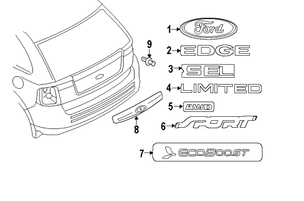

tmbubell I went back and look at the pic you posted with the busted trim piece...WOW! How did they do that? I had no problem taking the entire piece off the car and over to my work bench. I was then able to remove the camera and its wiring. I really looks like they left it bolted to the lift gate and tried prying it off. I removed the interior panel from the lift gate to access the 4 nuts holding the camera piece to the gate. Took about 10-15 mins.
I replaced the entire trim piece from the rear lift gate and swapped my camera over to the new piece. listed as number 8 on the one diagram.
Mine is doing the upside down image thing. I found a TSB but it's states the problem happening in cold weather. So I might just wait till the temps drop, then take it to the dealer.
If it just the camera you can get that part from a ford parts site for a little over $100 shipped. It's easy to replace, as I've taken mine out to replace the chrome emblem strip its attached to. I'm not sure if once you replace the camera a software reboot is needed.
