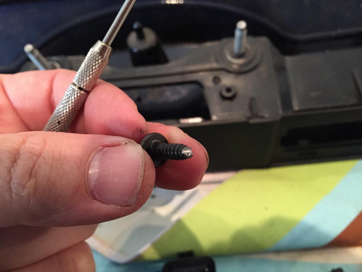

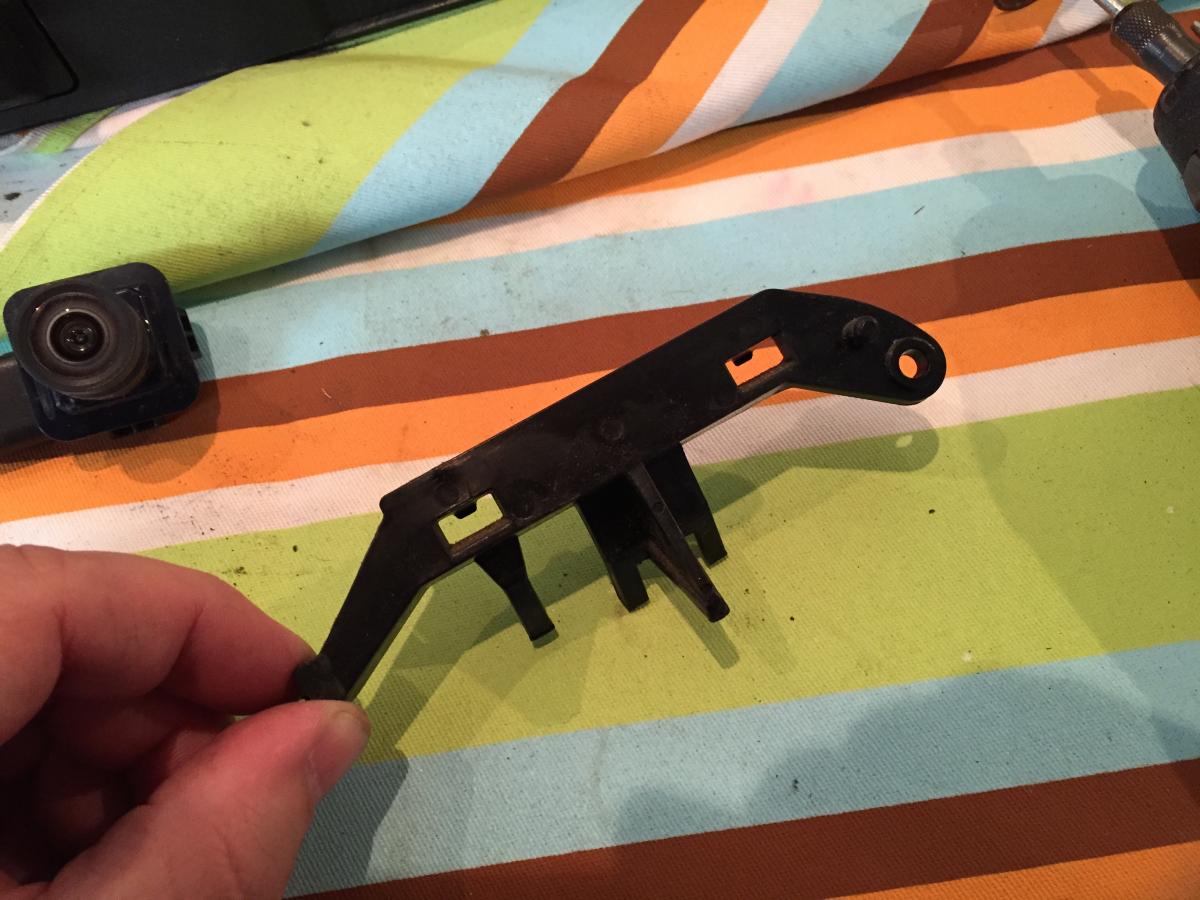

You are correct. The red arrow is the tip of the threads of the screw. I used a dremel tool to cut a slit in the screw and back it out. It was easy to start with the tips of my fingers for reassembly then worked it the rest of the way in with the flat tip driver. That one and only screw holds the little plastics arm in place which holds the camera in place.

For anyone that is having camera issues and wants to swap out the camera (if thats the defective part) here is what I did to get the camera out. First remove the 4 screws in the hand grip area of the lift gate. Next pop off the big interior panel. Kinda have to tug a bit but is will come off. locate the 6 nuts across the back of the trim piece and remove. Now find the the 2 plastic push clips on either end of that row of nuts. Squeeze with a needle nose and push out. Undo the small black wire connector and the flat grey one. I popped out the plate lights and wire harness prior to any of this.. Now that its off the ONLY way to get the camera out is to remove bracket holding it down....this is tricky. This is the bracket. It has one star head screw holding it in. You will see the back of it in that hole. Getting to the front will only happen with tiny tools. OR...you can do what I did and Dremel a slit in the tip of the screw and use a tiny flat head to back it out. No guts no glory LOL I reassembled in reverse order..camera/ bracket/ screw(if for some reason you royally screw up in removal I suggest a very small nut and bolt combo to reattach the bracket) wire harness/ lights.... So one thing I noticed when ordering a new camera is that there is 2 listed a older dated one and and a newer one. Im going to try the newer one and see what happens. I base this fix souly on reading other forums and people having this issue fixed at the dealer, stating that the fix was replacing the camera and reprograming it to get the guide lines working. DISCLAIMER: I take no responsibility for anyone who screws their car up. Attempt at your own risk!
