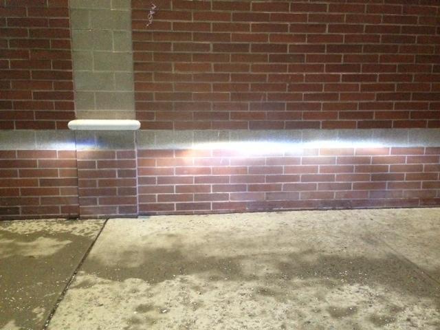

  3. So I finally got around to adjusting the lights and when I pulled up against a building I noticed that my beam pattern from the drivers side light looks a little off. There seems to be a section where both lights are aimed and then about 3 feet to the left of the drivers side concentration point is another hot spot. You can see what I'm talking about in the attached picture. I know that the wire return on the bulb is not facing downward, but not sure what is causing this additional hot spot and / or if this is normal. I don't think this could be something caused by the crappy HID kit I bought, but let me know what you all think. Thanks again, -Russ

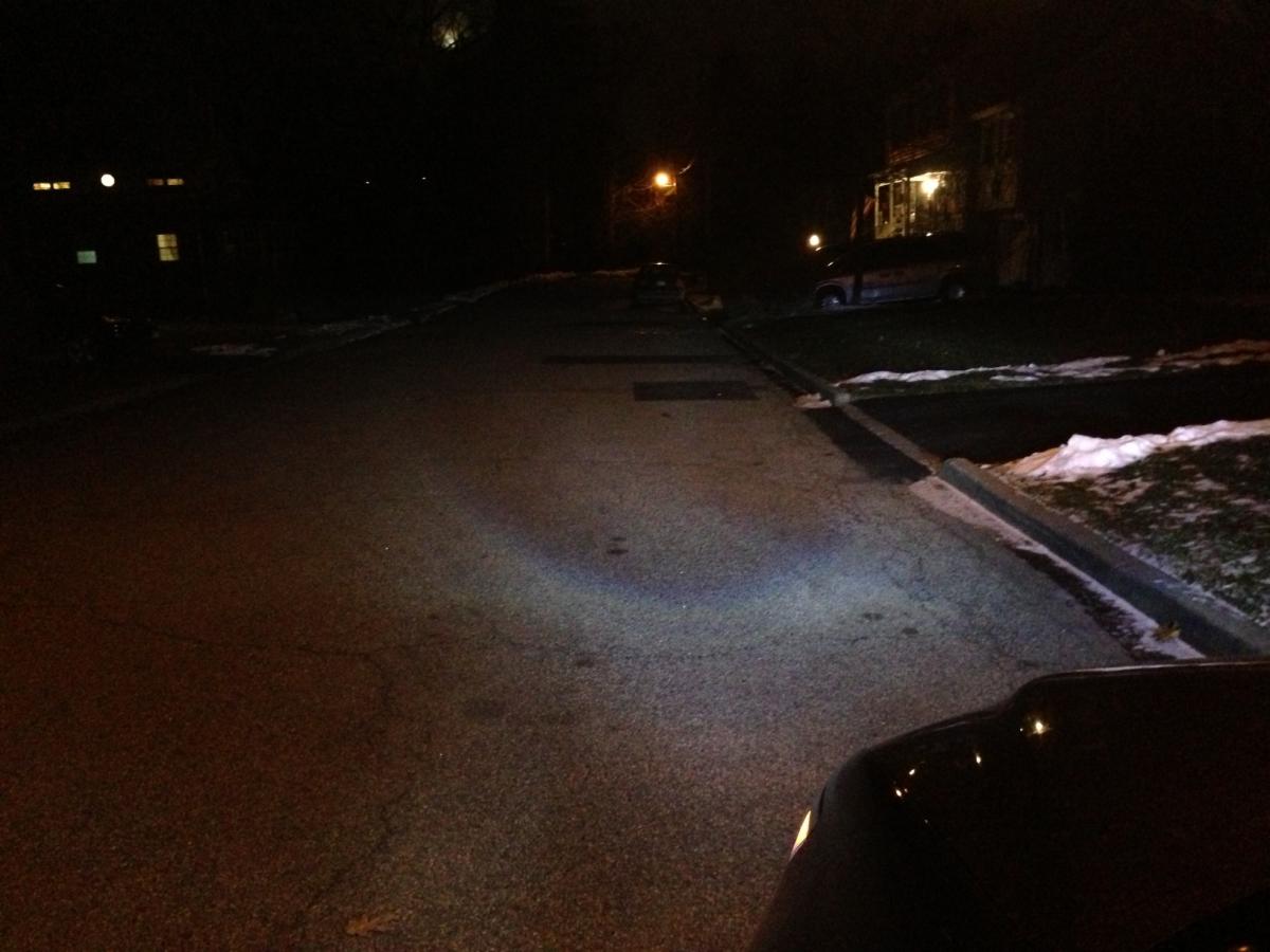

  11. Hello again, so I just installed my 5k bulbs and can notice a difference from the 6k already. I made sure that both bulbs were in correctly and that the return wire was not on the bottom but when I turned on the lights I saw a little half circle shape in the light pattern. Attached is a picture, any idea of what it might be? I don't think it looks normal. Thanks, -Russ
