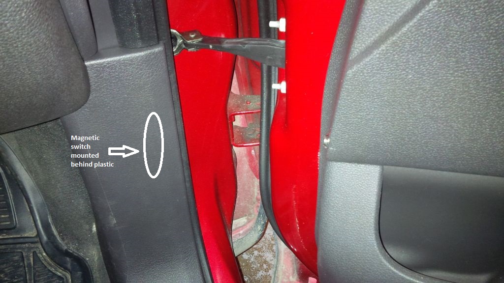

I was having the same door-ajar issue but mine was the front passenger door. I have come up with a pretty simple work-around that should last the life of the car. I was thinking about finding a push-button type switch that I could mount in the main door post but I knew that would involve drilling into the post, something I really didn't really want to do as it's pretty intrusive. But then I thought about using a magnetic switch instead. A magnetic switch is something easy to find. They are used in lot's of security alarm systems for monitring doors and windows. They are usually designed with pin-outs for both normally-open (N.O.) and normally-closed (N.C.). They have a a magnetically sensitive reed switch that moves open or closed when a magnet is close by. The Edge door-ajar switch is looking for a GND when the door closes. Placing another switch in parallel with the door-ajar switch is all you need to do. There are two wires that come from the switch inside the door on the door latch mechanism. For the passenger door the wire you want to find is the white 22 AWG wire in the bundle coming out of the door. you can get access to this bundle by removing the (door sill plate) the plastic trim covering the front pillar area of the door opening. This will allow you to see the wiring bundle where it enters the car from the door up next to the glove box. There are two white wires in the bundle, a 20 AWG and a 22AWG. Look for the thinner of the two. This is the wire you need to splice into. (At this point if you don't care about the interior lights coming on when you open the door and you just don't want to see the door-ajar warning any more you can simply add a simple normally-open switch with one side of the switch attached the the white wire and the other to a GND. Turn the switch and the door-ajar warning will go away as you've now grounded the sensing wire at the Body Control Module. I simply added the switch so the warning went away and I left it that way until I was ready to install the magnetic switch. When I was ready to add the magnetic switch I just paralleled the new switch across the switch I'd previously installed. I placed the magnetic switch inside the plastic trim just beside the top fastener clip. I afixed the switch with some decent double-sided tape. I reinstalled the trim. Then I then took a small but powerful neodymium magnet and moved it around the outside of the trim near the area where the switch was installed behind the trim until I could tell it was closing the switch. (I had a DVM across the switch at this point so I could see when the switch was closing) Once I was confident I had the right spot using some silicone adhesive I glued the small magnet to the plastic door trim directly across from the switch. Now when the door closes, the magnet is brought close enough to the magnetic switch that the door sensor receives a GND and the door-ajar warning is gone. It works perfectly and only cost a few bucks. If anyone is interested I will provide some pictures. BTW, for the driver's door the wire you'd be looking for in the the driver's door wiring would be the 22 AWG Green with a Violet stripe. I'll get some pictures and post them soon. The magnetic switch is readily available in most hardware stores. They look like this: http://www.amazon.co...h/dp/B0009SUF08 You'll only need to use the part with the connections as the other component contains the magnetic and I think you'll need a more powerful magnet like "B" or "C" on this page: http://www.leevalley...ge.aspx?p=32065 You want it to be large enough to close the switch but small enough not to be too noticeable. Here are a few pictures of the above project. The magnet is siliconed to the door panel. I've circled the area where the magnetic switch is mounted in behind the plastic trim panel. You can locate the white wire easily behind the panel and trace it along to where you can splice into it. There is also a nearby grounding point for the other side of the switch.

Here are a few pictures of the above project. The magnet is siliconed to the door panel. I've circled the area where the magnetic switch is mounted in behind the plastic trim panel. You can locate the white wire easily behind the panel and trace it along to where you can splice into it. There is also a nearby grounding point for the other side of the switch. -

I was having the same door-ajar issue but mine was the front passenger door. I have come up with a pretty simple work-around that should last the life of the car. I was thinking about finding a push-button type switch that I could mount in the main door post but I knew that would involve drilling into the post, something I really didn't really want to do as it's pretty intrusive. But then I thought about using a magnetic switch instead. A magnetic switch is something easy to find. They are used in lot's of security alarm systems for monitring doors and windows. They are usually designed with pin-outs for both normally-open (N.O.) and normally-closed (N.C.). They have a a magnetically sensitive reed switch that moves open or closed when a magnet is close by. The Edge door-ajar switch is looking for a GND when the door closes. Placing another switch in parallel with the door-ajar switch is all you need to do. There are two wires that come from the switch inside the door on the door latch mechanism. For the passenger door the wire you want to find is the white 22 AWG wire in the bundle coming out of the door. you can get access to this bundle by removing the (door sill plate) the plastic trim covering the front pillar area of the door opening. This will allow you to see the wiring bundle where it enters the car from the door up next to the glove box. There are two white wires in the bundle, a 20 AWG and a 22AWG. Look for the thinner of the two. This is the wire you need to splice into. (At this point if you don't care about the interior lights coming on when you open the door and you just don't want to see the door-ajar warning any more you can simply add a simple normally-open switch with one side of the switch attached the the white wire and the other to a GND. Turn the switch and the door-ajar warning will go away as you've now grounded the sensing wire at the Body Control Module. I simply added the switch so the warning went away and I left it that way until I was ready to install the magnetic switch. When I was ready to add the magnetic switch I just paralleled the new switch across the switch I'd previously installed. I placed the magnetic switch inside the plastic trim just beside the top fastener clip. I afixed the switch with some decent double-sided tape. I reinstalled the trim. Then I then took a small but powerful neodymium magnet and moved it around the outside of the trim near the area where the switch was installed behind the trim until I could tell it was closing the switch. (I had a DVM across the switch at this point so I could see when the switch was closing) Once I was confident I had the right spot using some silicone adhesive I glued the small magnet to the plastic door trim directly across from the switch. Now when the door closes, the magnet is brought close enough to the magnetic switch that the door sensor receives a GND and the door-ajar warning is gone. It works perfectly and only cost a few bucks. If anyone is interested I will provide some pictures. BTW, for the driver's door the wire you'd be looking for in the the driver's door wiring would be the 22 AWG Green with a Violet stripe. -
