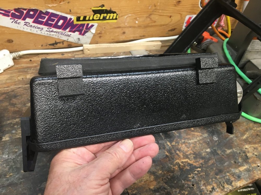

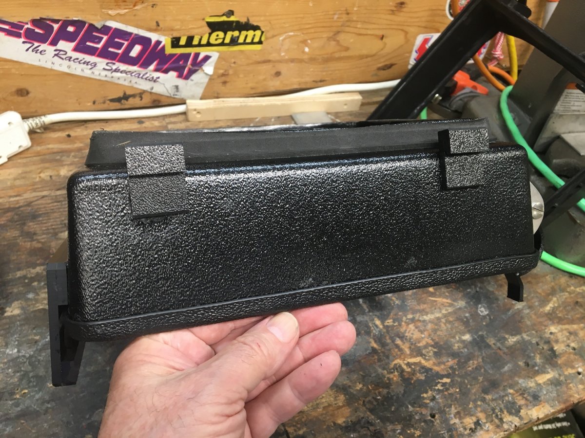

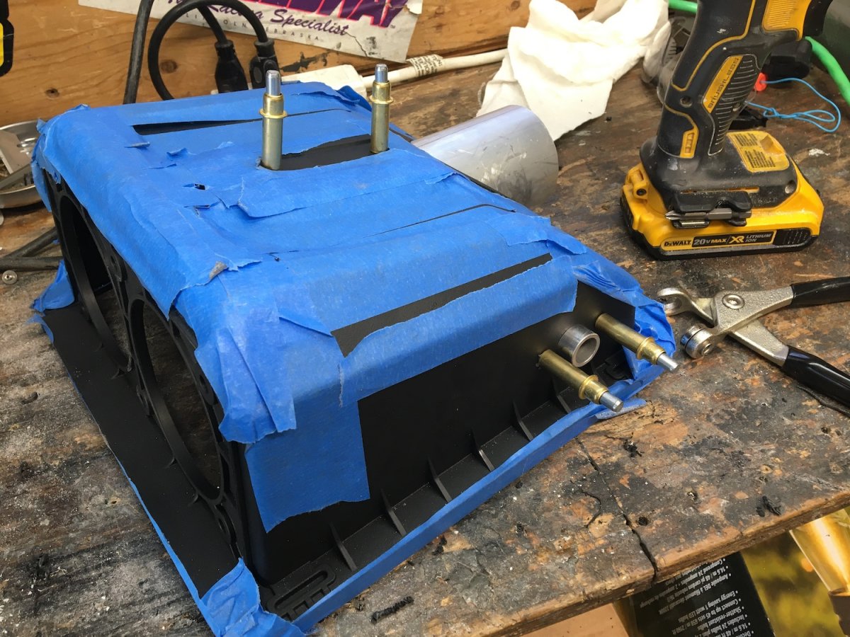

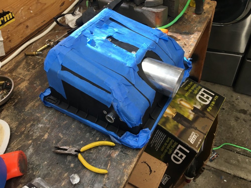

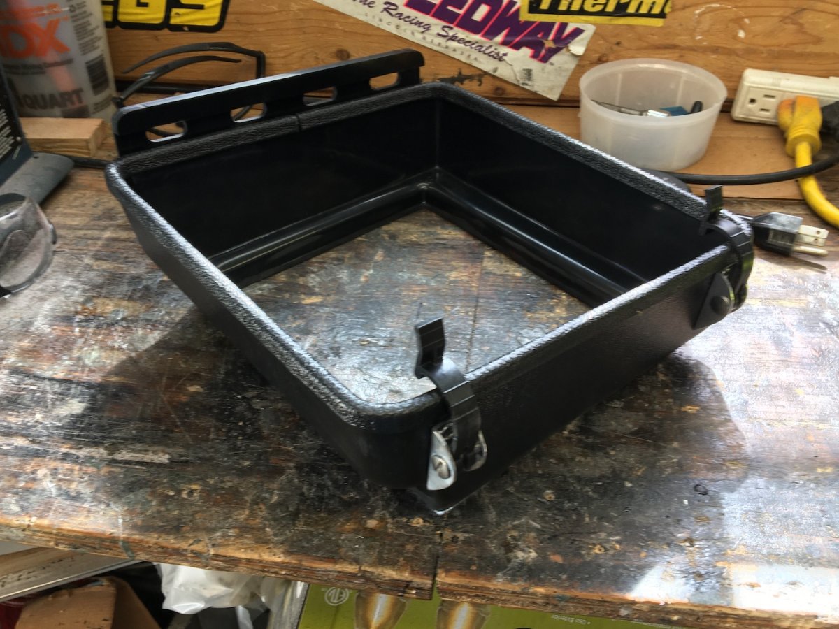

  4. It was a quiet Friday night and the air filter had arrived, so I went back to work and finished up the side that hooks up to the car. These are the tabs that go to the front. These are the J-Hooks that the OEM air box clips to. The Adaptor is now complete. It needs to cure overnight to achieve 80% strength.

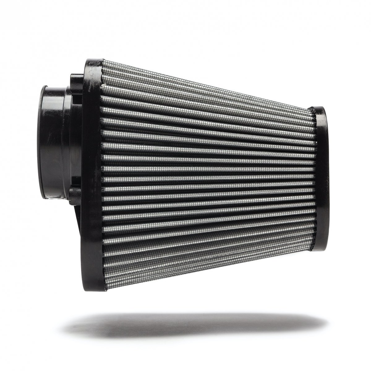

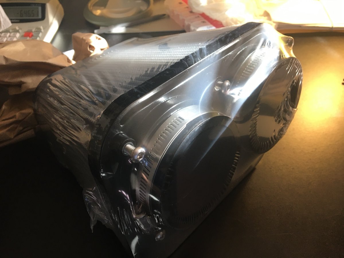

  5. The Oiled, Washable, Reusable, Air Filter came in today. I will keep it wrapped and boxed up as it the last thing to install before shipment.

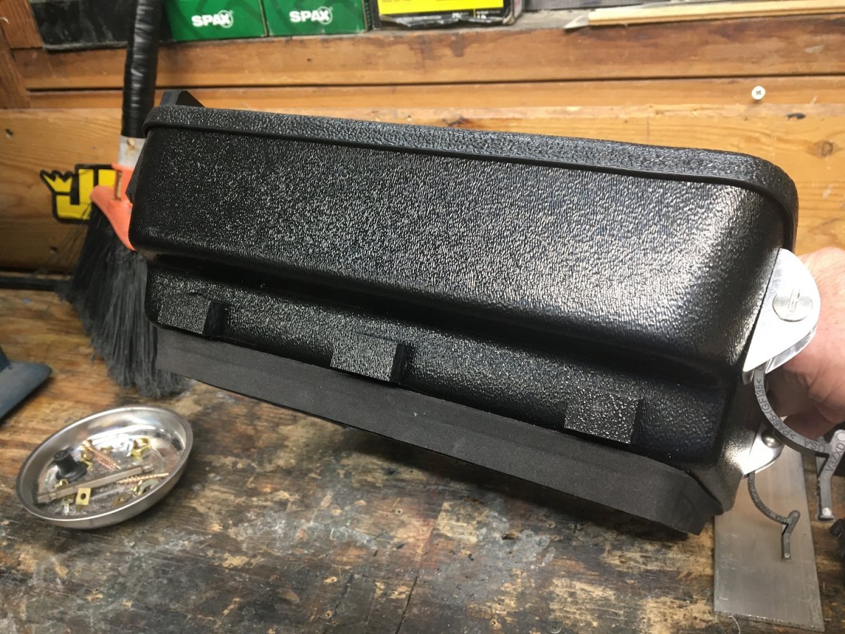

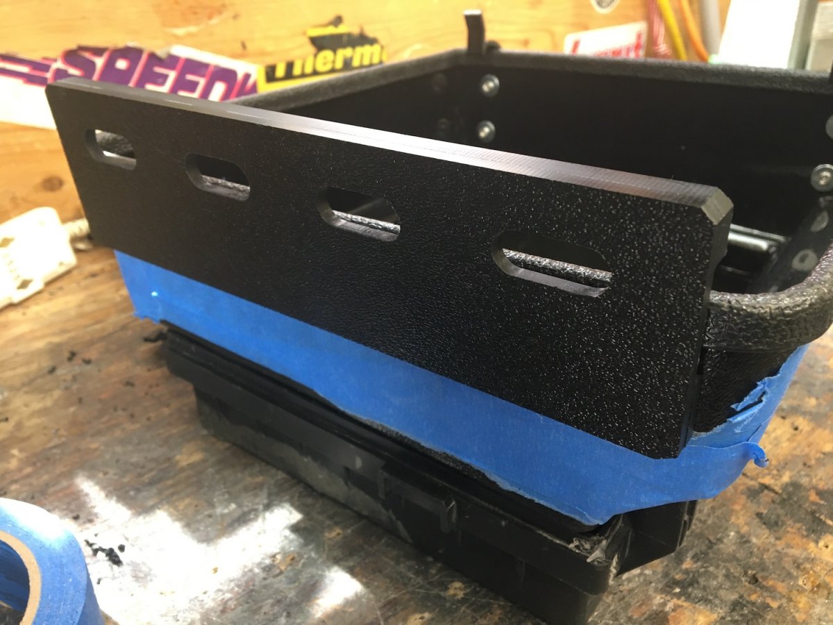

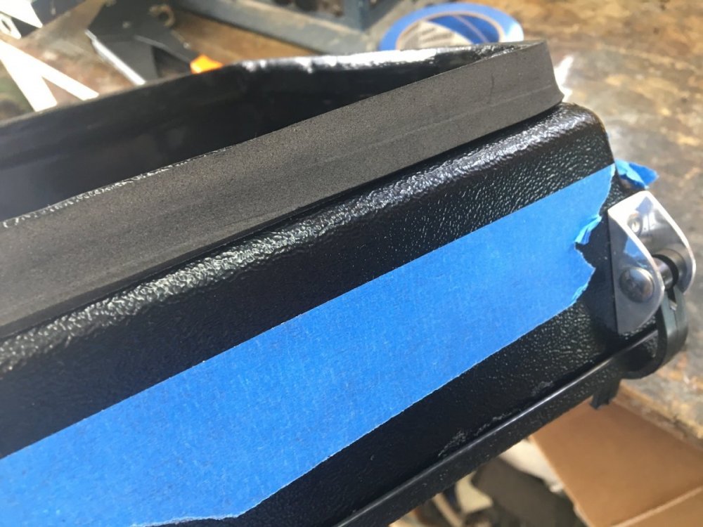

  6. Day Five working at my shop. These posts show what is involved in making just one V3 . Today work continues on the Adaptor. This is the high density foam gasket that seals the V3 Adaptor to he OEM air box bottom half. The latches and C-Clip complete the Lid side of the Adaptor. The latches are very tight on this V3 Adaptor and snap into place with authority. As the foam gasket on the lid compresses over time the latches will be easier to catch. Close up of the CNC machined C-Clip... Tomorrow work will continue on the OEM air box side of the Adaptor.

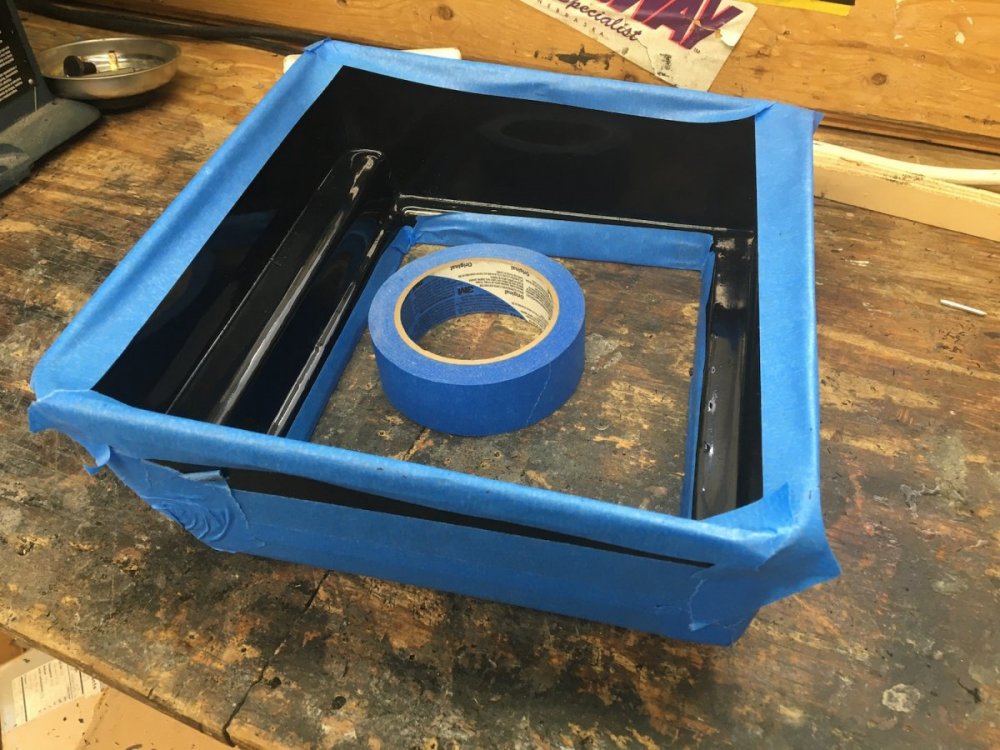

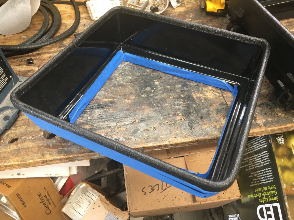

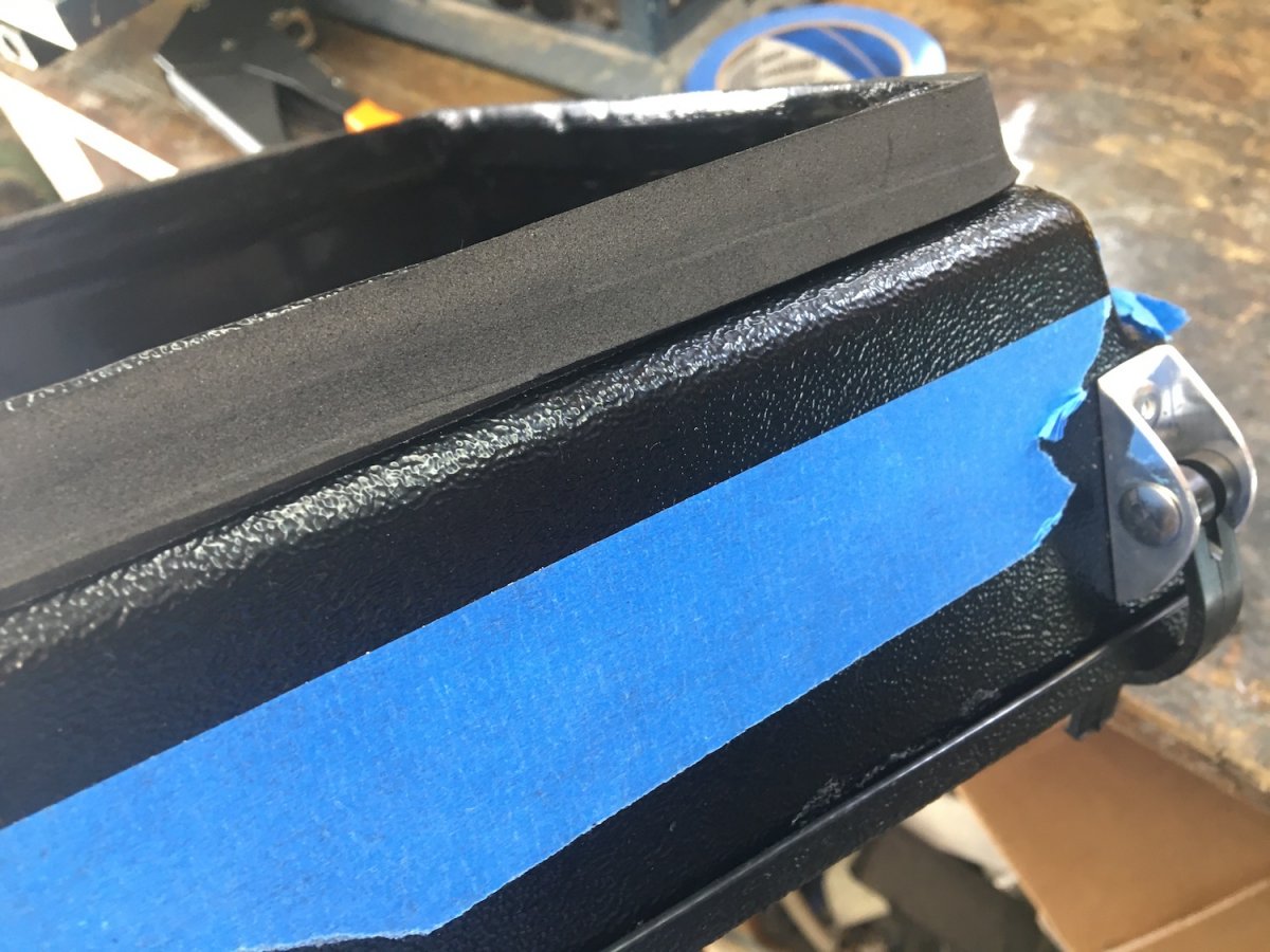

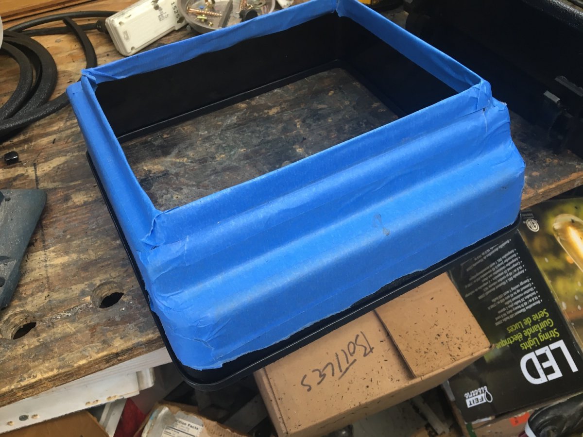

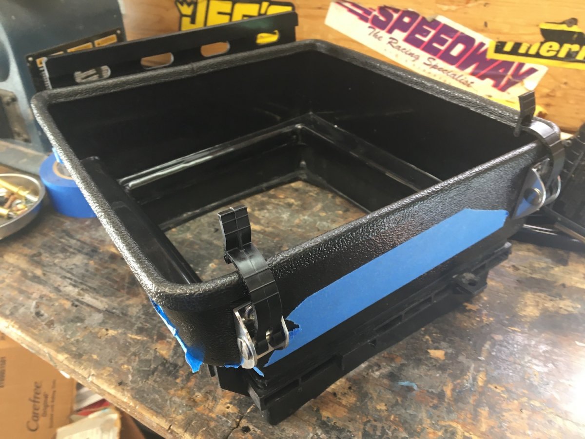

  7. Started work on the Adaptor today. Day Four. After cutting it out and trimming, more tape is added to protect the edges. The Adaptor is squared up to sit flat, and then the edge protector is added. This edge protector also helps seal the adaptor to the lid gasket . Once the edge protector is installed, more tape is added for protection.

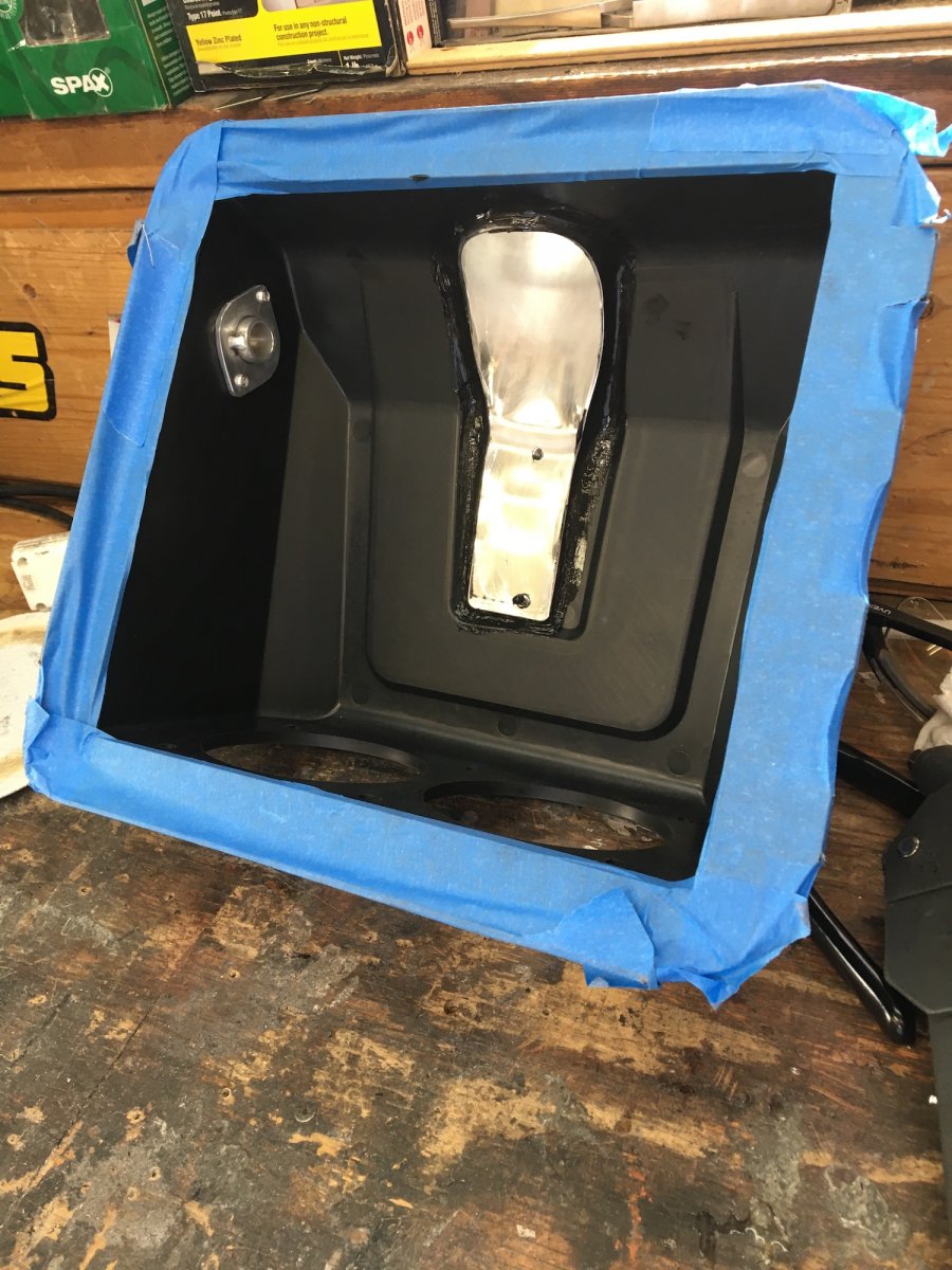

  9. Managed to finish up the mods to the lid for the Aux Aix Intake. Cut, shaped, bent, drilled and polished ready to assemble. Day Three. Sealed air tight, riveted Aux Air and Sensor port. All this lid needs now is for the RTV to dry, and a gasket.

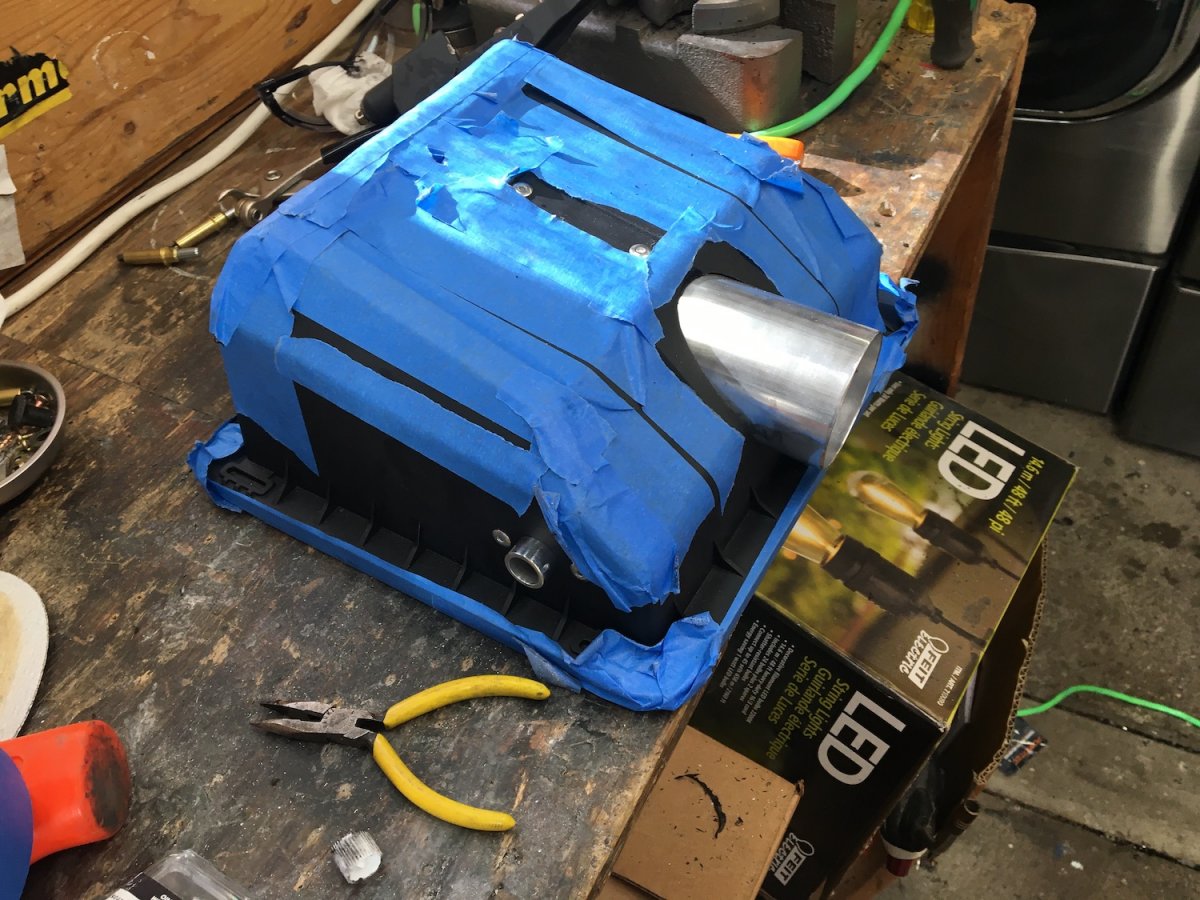

  11. Working on a lid with the Auxiliary Air Intake today. The Aux Air is a popular option along with the Oiled Washable Filter. Got everything fabricated and ready for polishing before final assembly. Day Two

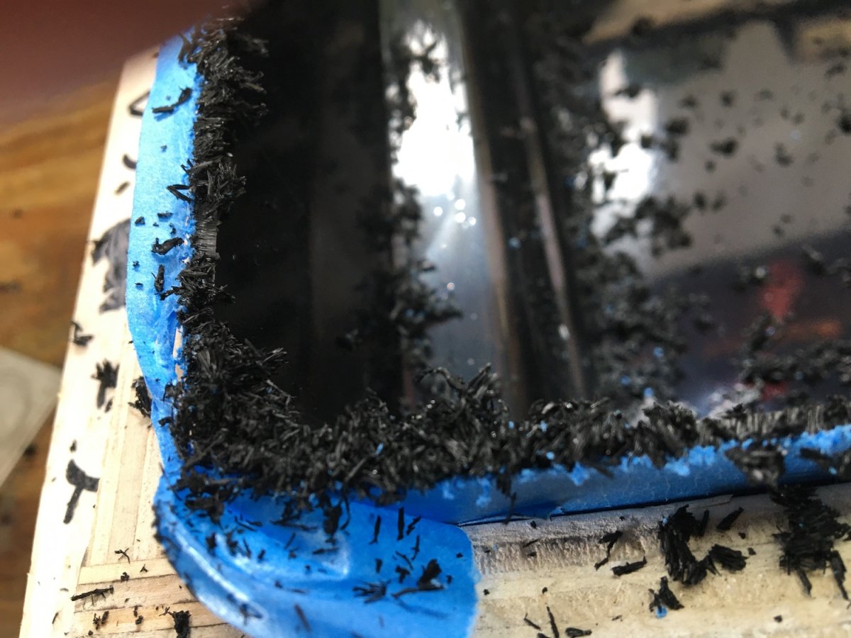

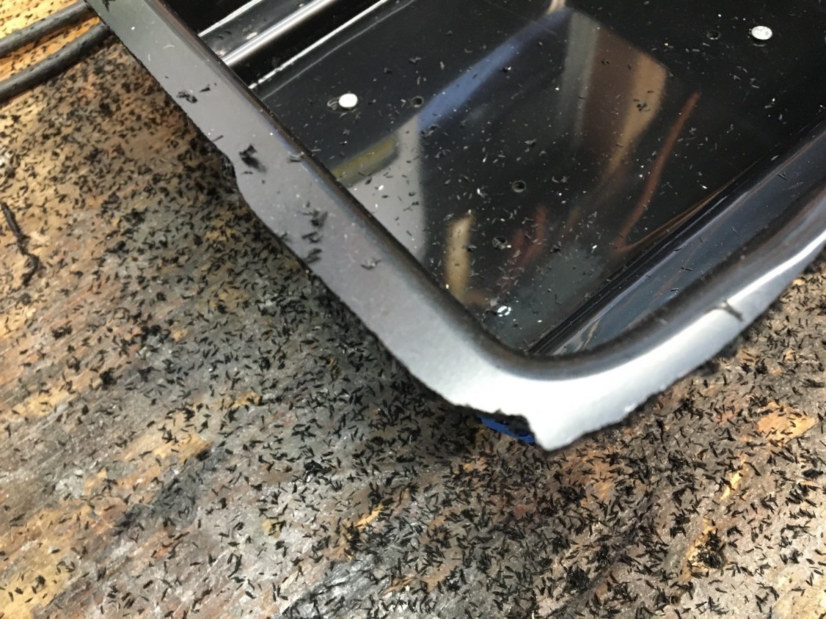

  14. The Rotozip makes a mess and perhaps some day I will discover a better way to cut this . Day One. After cleaning up the mess that sticks to the cut it looks much better. Precision on this cut is not necessary as this is trimmed away in the next cut. .
  15. Started the next step. In order to make it more manageable excess is removed. This is the first step . After set up, the RotoZip makes the cut.

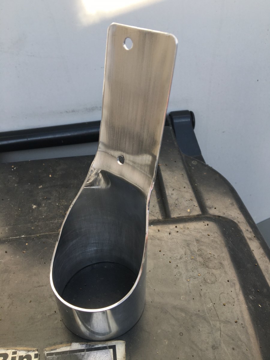

  18. This little aluminum part takes several steps to make. Cutting, drilling, shaping, de-burring, sanding, and polishing. Final assembly ready for mounting. Worth the effort ?

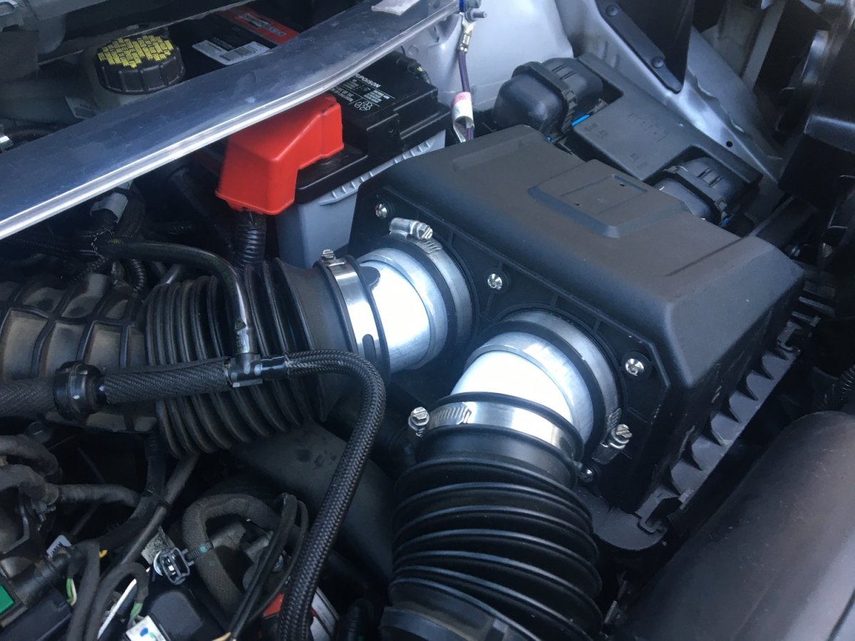

  23. Install both the V2 and V3 to create the ultimate Edge CAI System.

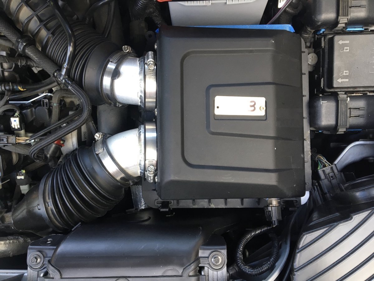

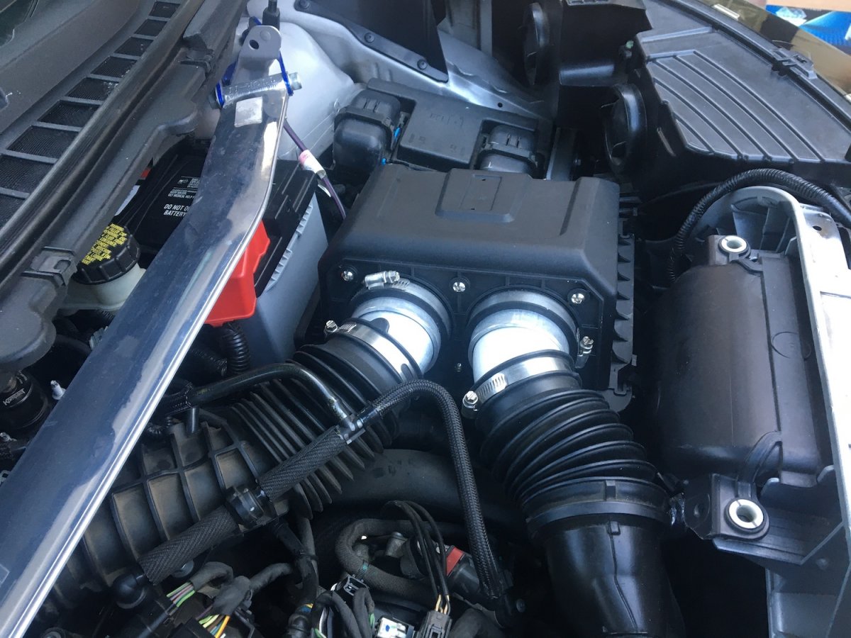

  25. I am so happy that you are please with the V3 and that that the install went smoothly. I also like the Ram Air approach that snmjim pioneered and believe that is a great way to go. Thanks for taking time to post and answer my questions. Feedback is very important to have, good or bad. ... Thank goodness it was good, lol I really like the look with the trimmed engine cover . Those are some great photos and kind words, I am honored Thanks!
