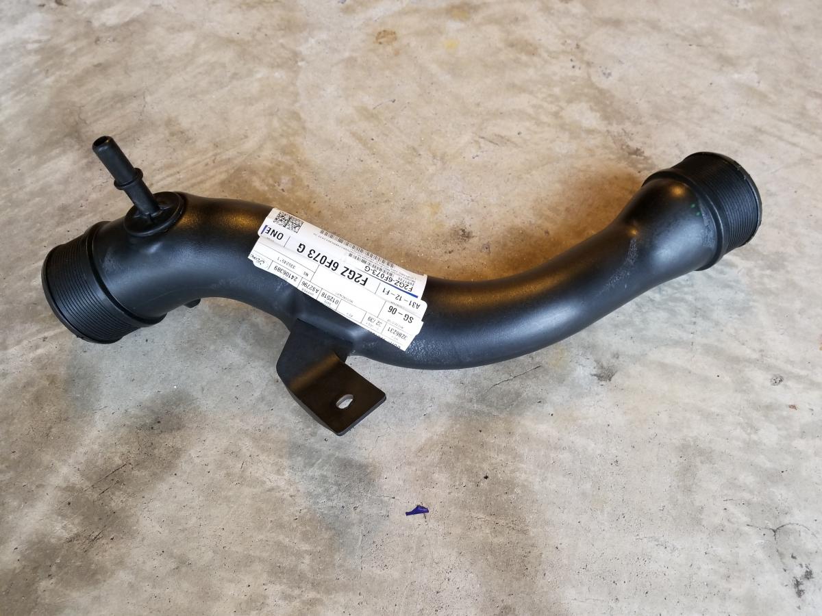

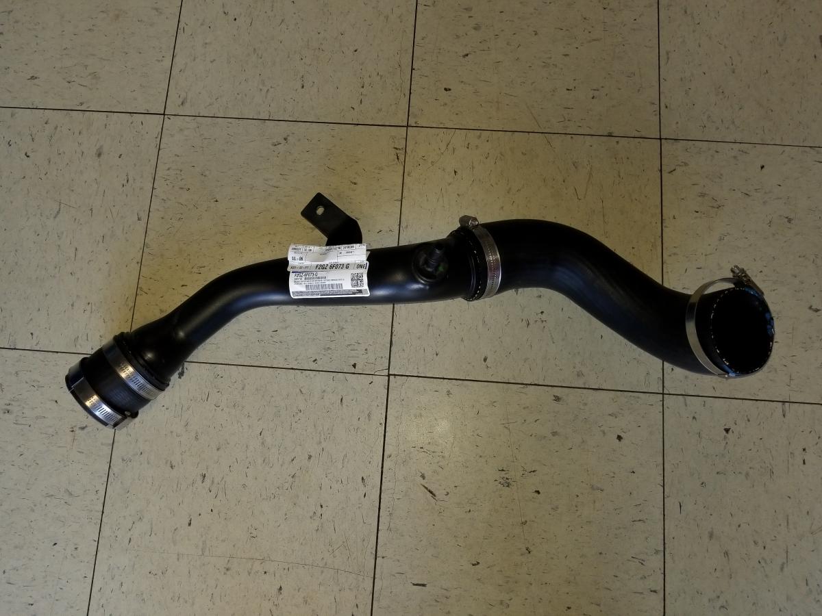

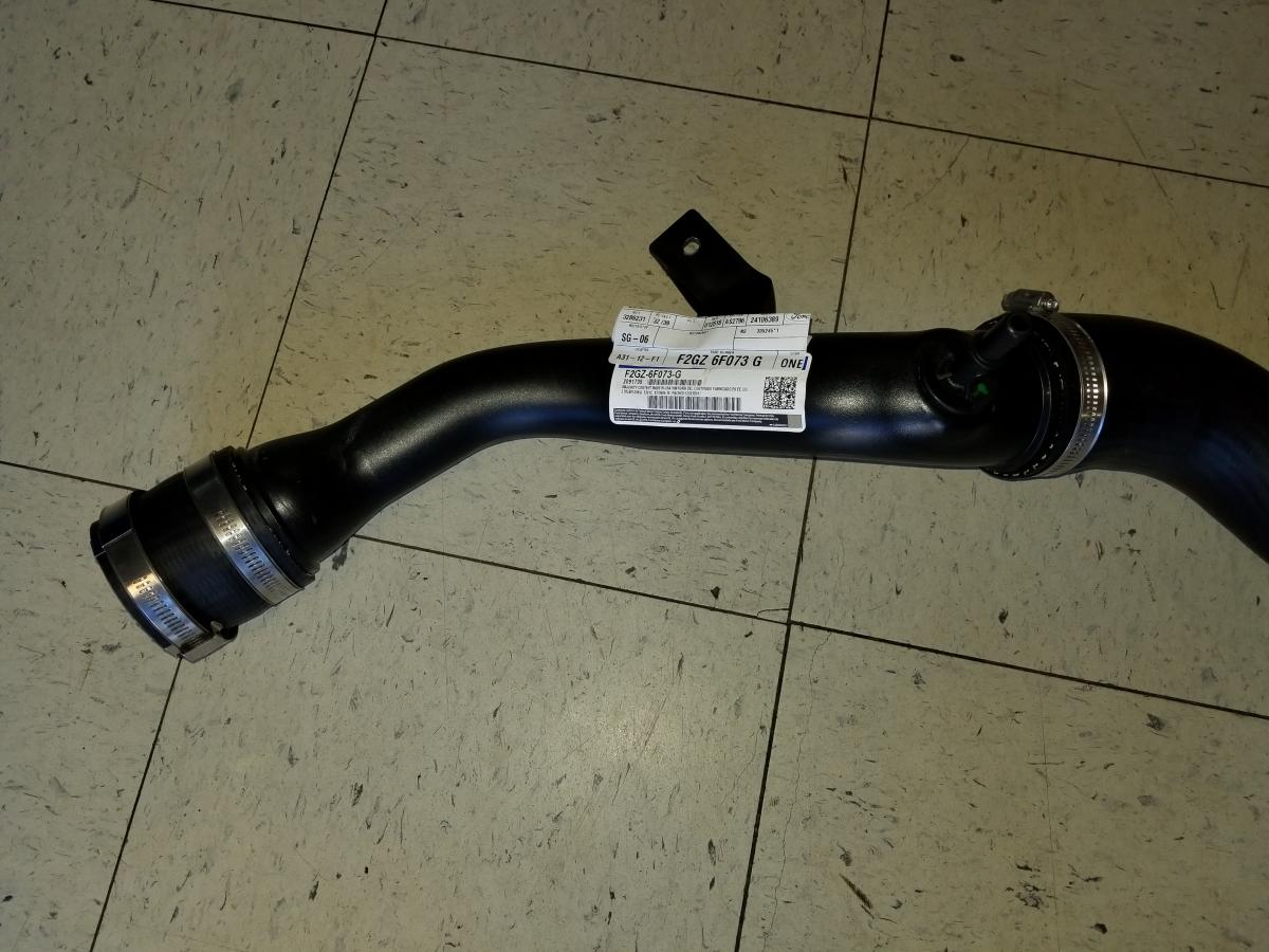

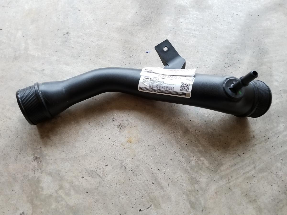

In an effort to get this topic back on track... While waiting on CPe to call us in sometime this month (Feb) we decided to attack the IC piping issue. The piping on the IC intake side we deemed as being adequate however, the outlet side is whole nother can of worms, check out the Pics, see any problem... Therefore, thanks to my awesome Ford parts guy... he was nice enough to provide a sample outlet pipe for us to ship to the piping modification fabricator in FL... :happy feet: :happy feet: :happy feet:

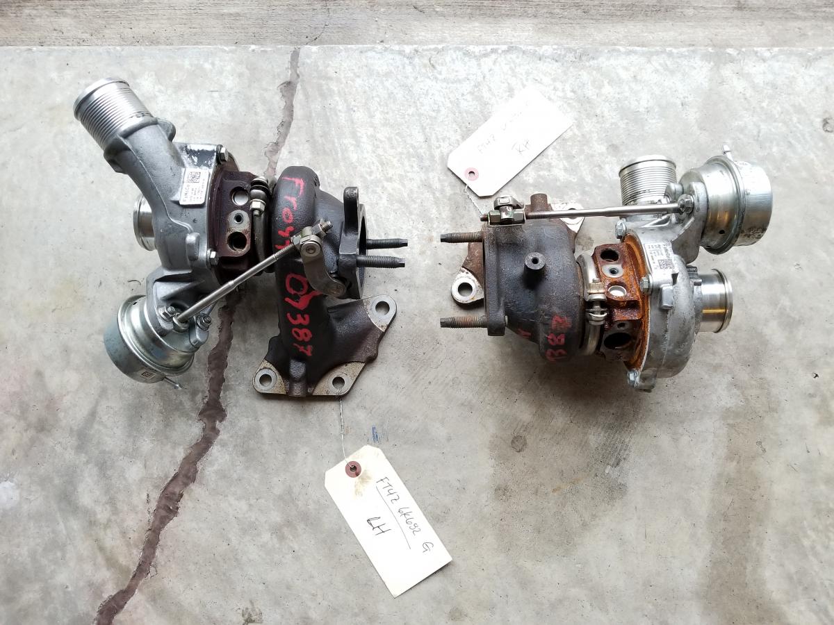

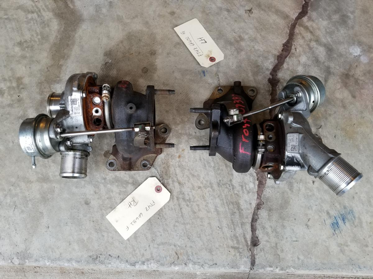

Found a pair of 2016 Edge Sport Turbos with 10k for $300, couldn't pass that up, now off to the MOD shop... Way too many out there totaling these nice rides, but makes for great pickings for us...
Found a pair of 2016 Edge Sport Turbos with 10k for $300, couldn't pass that up, now off to the MOD shop... Way too many out there totaling these nice rides but it makes great pickings for us... :happy feet: :happy feet: :happy feet:
