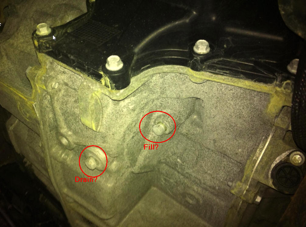

  6. OK. I changed the fluid, here is what I found.: I bought two quarts of Valvoline 80W90 gear oil. $4.99 a quart (that is what the manual says to use on my 2009 Limited AWD). I raised the vehicle up about 4 inches (level). Made it easier to get under. Let me comment on an easy way to do this. Grab a 2x6. Cut 4 3' lengths and 4 2' lengths. Screw the shorter ones on top of one end of the longer ones. Use a saw and taper the ends of each. There you have 4 ramps that are easy to drive up on. Put one in front of each tire. Drive up. Very solid. I then removed the plug using a 3/8" drive socket wrench. I took a small zip tie, bent the end at 90 degrees and stuck it in the hole. Looks to me like it was filled right to the top of the hole. Good news, it will be easy to tell when to stop when I am filling it. I have access to a vacuum sucker thingy. Common at marinas for sucking fluids (oils, etc.) out of places without drain plugs. Took a while (20 minutes) because the oil was so think. The manual says it holds 2.4 pints (2 pints to a quart). I think I got close to a quart out. The vacuum sucker thingy uses clear tubing so I could watch the oil drain. You have to keep pulling out the end of the hose and re-positioned it. Note, the oil looked quite clean. I then snipped off the end of a new quart. I had another chunk of clear tubing. Put it on the new oil. Had my son squeeze the oil while I held the other end it. Note, this is also a lengthy process since the oil is so thick. The easier job is holding the end in the differential, you get tired of squeezing the oil (we switched jobs half way through). You also laugh when the tube comes off the end and fresh oil squirts out. Another reason to buy two quarts. Once it was filled, I cleaned off the plug (note it is magnetic) and re-installed. I have attached a picture of the differential highlighting the drain plug for those that like visuals. Not a terribly tough procedure.

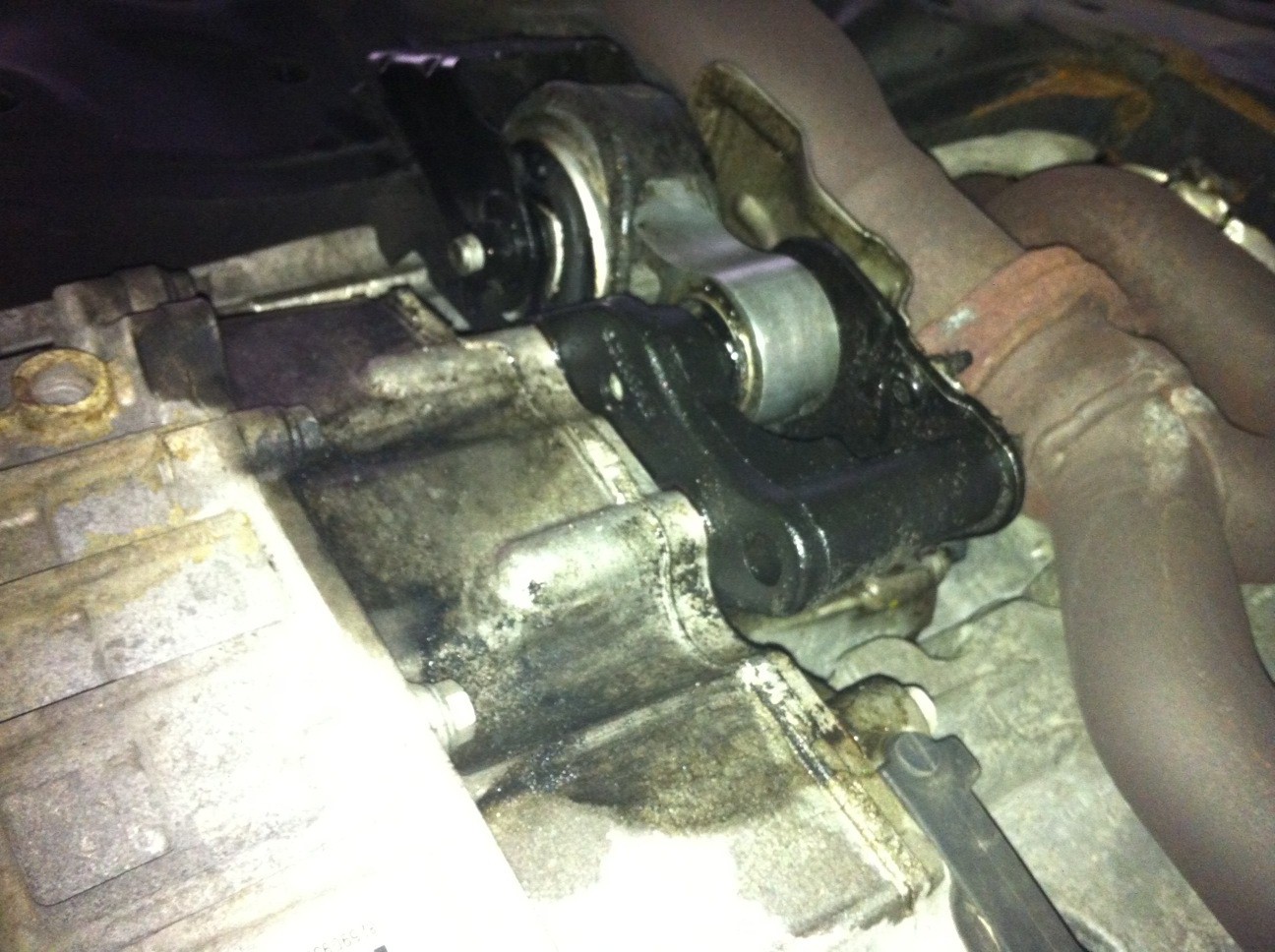

  10. Ok, did more searching on the net and found out: 1. My first picture I posted is a good example of a leaking PTU. 2. I don't think my second posting is how you change/check the fluid. A writer someplace else indicated that it is a "pipe" type plug and right above the "Y" in the exhaust. Also found the following on our fourm: "There is a pipe plug in the PTU directly above the "Y" in the exhaust. Removing this plug with a typical 3/8 drive ratchet allows checking the fluid level. Ford suggests taking a Zip-Tie, and bending it at a right angle, and trimming the short leg of the zip tie (after bending) to 1 3/4 inch.With vehicle level (I put it up on 4 ramps for convenience), insert the short leg of the zip tie down the fill hole. Fluid level should be between the bottom of the dipstick (1 3/4" below fill hole) and 1 1/2" below fill hole. On my car, it is overfilled by more than 1/2 inch, and I suspect this can be contributing to seal leakage. Because there is no drain plug, I have to pick up a suction gun to draw the level down. For those that are low on fluid, Ford recommends their synthetic 75w-140 gear lube (for topping it off, or replacing fluid). " Also found the attached TSB: PTU_TSB.pdf
  11. I have a 2009 Limited AWD with 63K miles on it. I looked under it and I see what I think is the PTU leaking. Can anyone confirm if the first picture is a leaking PTU and if the second picture shows the bolts to remove to drain and fill it?
