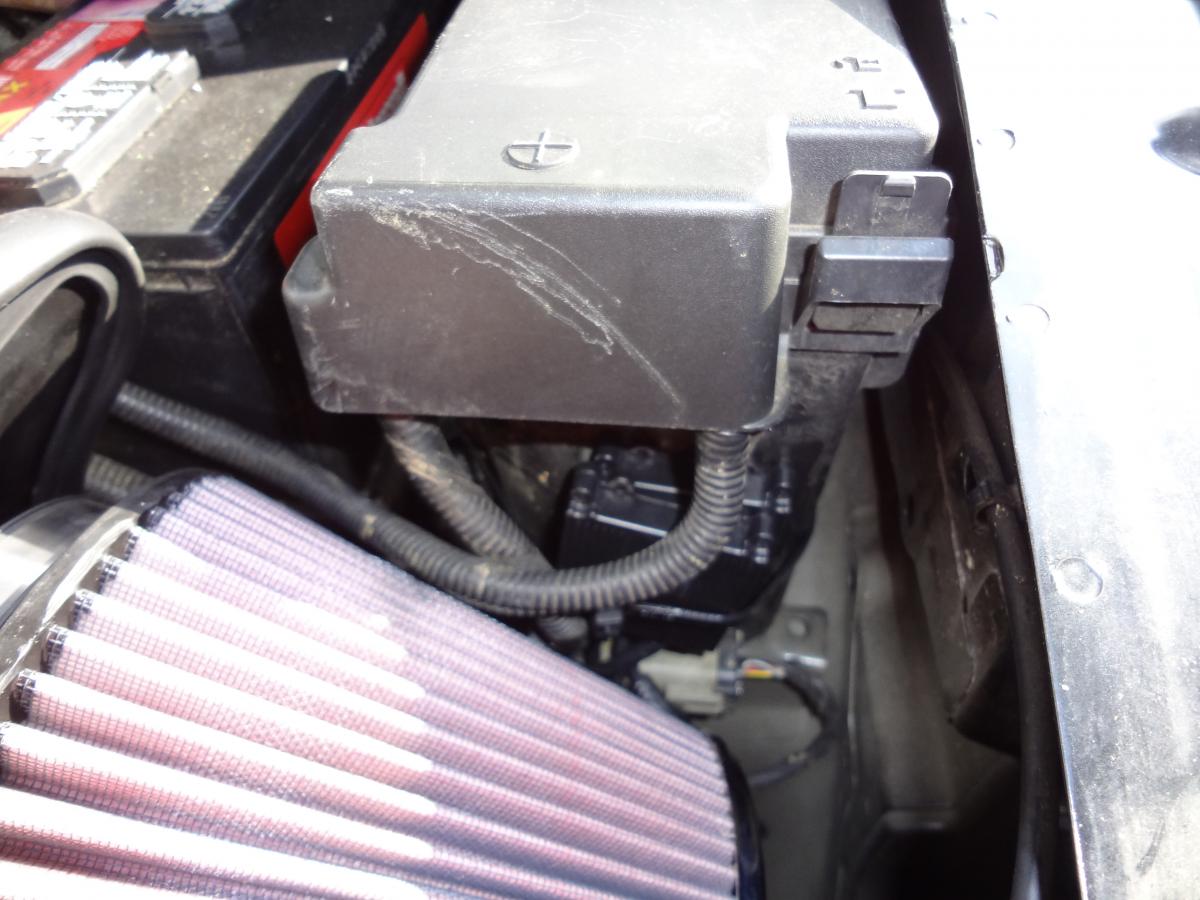

The first 3 photos are the passenger side HID mounts. I mounted the 2 ballasts on top of each other to thick wires that had like a heat wrap sleeve on them and where very secure and strong so i decided it was a good area to mount them. Also thought about windshield wiper fluid container but if u refill it and spill could lead to a problem and it ballasts can slide up and down and the coolant container (yellow container) gets hot-- i think thats coolant not sure. So those strong wires seemed to be the best spot i could see.
These 2 photos are the driver side HID ballasts mounts. I mounted these on the lower front side of the fuse box. Mounted the 2 ballasts on top of each other again and seems to work well. If theres any hazard of mounting the 2 ballasts on top of each other please do let me know so i can change it but i didn't see anything online saying it could cause any type of damage.
Hope this helps.
-Cruz

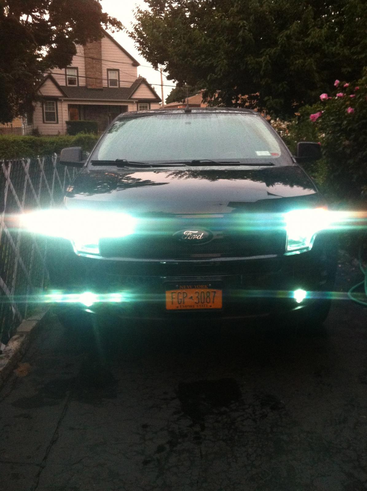

I didn't take before and after pictures of the beam patterns but the bulbs strew and lock into place so i wouldn't think they would be far off if even off compared to stock.. i could be wrong. I can take pictures of the low beam lights shining on a wall later tonight when it gets dark outside.
-Cruz
