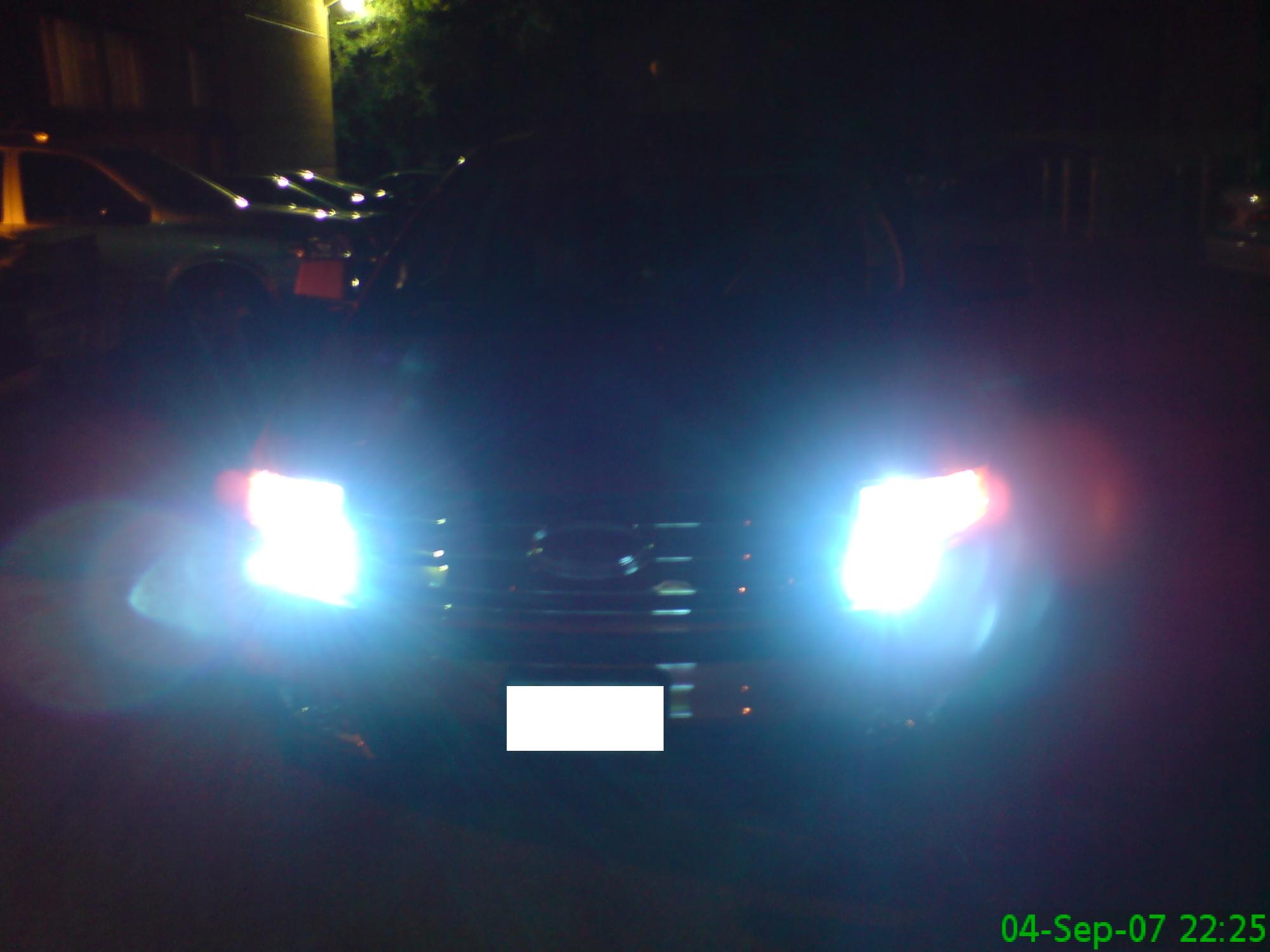

My HID!

Im using 4300s and there just right. I think the rest are a little too blue/purpleish. I use a relay kit on mine. 20 bucks from EBAY. Works great. Is anyone having problems. My left light keeps flickering when i first turn them on. Dont know if its the bulb or the ballast. Hopefully the bulb. What do you guys think? Other than that, my lights are great.

Those aren't HID bulbs.
Hid bulbs REQUIRE balasts, if it uses the factory sockets, its not a High Intesity Discharge system, HID's can not light using a simple bulb socket. Those are dangerous and should NEVER be used, any of the bullshit 'xennon' bulbs on ebay or autozone. Only name brand upgraded halogens like Sylvania, Hella or PIAA have been properly tested. As HID threads tend to breed more HID threads, check out the other one which refers to a proper aftermarket (as proper as putting HID in a reflector housing can be) that is part of an enormous Mustang thread on the VVME kits that hundreds of people have converted to-including my Mustang which were flawless solenoid tilting 6000K bulbs.
I may order a set of 6000k H11's for my Edge as I got used to looking at pure daylight from 30-200' in front of my car and the ability to light reflective signs and tape at up to 1/3 mile. HID's use their own protected power sources and are fused at the units and the power supply wire, and run much cooler then normal halogens at 3x the light output. Although in normal reflector housings cause excessive glare to oncomming drivers, some housings worse then others. The Mustang's were no worse then factory Acura HID's, but other designs may be worse.
