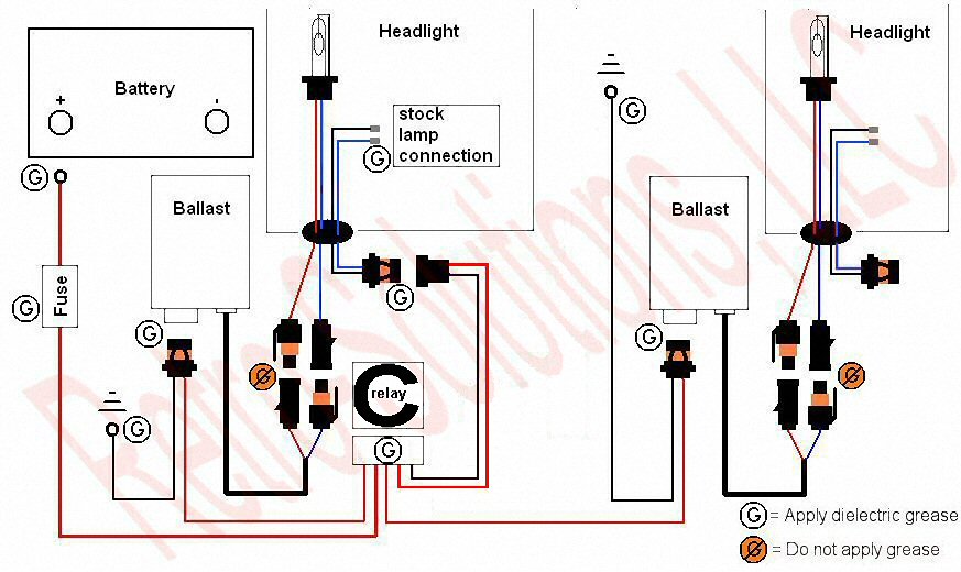

Hey guys, I'm hoping that someone here can help me out. Back in May, I installed a 3rd party HID kit (Retro-Solutions http://retro-solutions.net/product-info.php?55W_DIGITAL_HID_KIT-pid664.html ). It's been working just fine up until a week or so ago. Now only my passenger side light works. The driver side light does a quick flash at turn-on, but then fails to light. (I would assume this means the bulb is OK, but something is keeping it from loading. I checked all of the connections today and found nothing. Pulled down the wiring diagram (attached) from website and reviewed it, but don't see anything that I didn't already check. I did notice that there is only one fuse in use just before the battery, so there aren't fuses for each ballast. Is it possible that only one light would stop working due to a fuse issue? Here's why I ask. Just a couple of weeks ago, I was in the Ford Dealership and they detached my battery to reset my SYNC that was going haywire. That's all working now, but now I have this light problem. No clue if its related but thats the only possible connection that I can make as to why it may have stopped working. I have no evidence that it stopped working right after the battery detach, but it's kinda fishy that I noticed the light out a few days afterward. I haven't swapped the bulbs yet because I'm not that technically inclined on this stuff, but I'm guessing that's the next step. But I thought I'd check with you guys for any "experienced" input in case someone has had this very problem before. Thoughts?

I would suggest flip flopping the bulbs left to right, right to left to rule out the bulb. That is the easiest test.
From there you may want to confirm voltage IN to the ballast when the lights are switched to on (DO NOT TOUCH THE OUTBOUND TO BULB BALLAST WIRES).
Assuming good voltage to the ballast on the side not lighting then trade ballasts to see if the problem follows the ballast.
You are looking at four possible faults basically:
The bulb is bad.
The ballast is bad.
No power is making it to the ballast.
No power is making it from the ballast to the bulb.
Various wiring issues may lead to either of the last two. Frayed wires causing arcing may keep power from making it to the ballast or bulb.
The last one is something you DO NOT want to find out bare handed. The voltage coming out of most ballasts is 25 thousand Plus volts and hurts like you wouldn't believe. The ignition sequence of a HID bulb REQUIRES lots of amperage but once burning they use very little amperage.
Adding:
If you have no capacitor this could be signaling a charging/battery system problem but that is a long-shot.
I know some people will suggest capacitors if you don't have them but honestly, if you are connected directly to the battery that is the ultimate power capacitor in this situation already. They may help but I am skeptical.
If the lights worked when you left the dealership I would not think their work had anything to do it. Has their been a sudden temp change/drop?
I used to run an auto shop and I am VERY familiar with the customers "last touch" perspective when a new problem occurs regardless of how long after the service it occurs.
