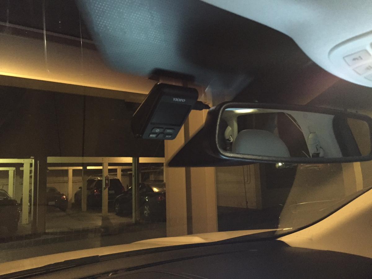

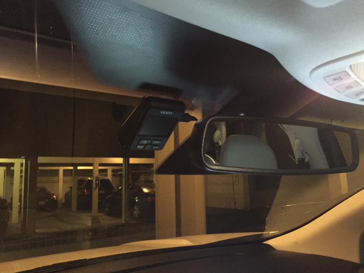

t0lkman Posted January 27, 2017 Report Share Posted January 27, 2017 Is there anywhere around the mirror 5V for usb dash cam? I don't want to use cigarette lighter charger and run the cable on the sides. Quote Link to comment Share on other sites More sharing options...
enigma-2 Posted January 28, 2017 Report Share Posted January 28, 2017 (edited) I use a harness wired into my mirror (MirrorTap) for my radar detector, turns on and off with the ignition. But that's 12 volt, not 5 volts. Everything in the mirror (dimming, speaker, etc.) runs on 12 volts as far as I know. Suppose you could tap 12 v.and use an in-line resistor to drop to 5 volts. This is the harness I bought, price took a huge jump over the last couple of years, believe I paid $25. https://www.amazon.com/gp/aw/d/B01LBKR2SA/ref=mp_s_a_1_fkmr0_2?ie=UTF8&qid=1485588233&sr=8-2-fkmr0&pi=AC_SX236_SY340_FMwebp_QL65&keywords=mirrortap%2Busb&th=1&psc=1 Edited January 28, 2017 by enigma-2 1 Quote Link to comment Share on other sites More sharing options...
t0lkman Posted February 2, 2017 Report Share Posted February 2, 2017 @enigma-2, I've done something similar, took 12V from the rain sensor and converted to 5V using the usb charger that came with the camera. Everything is stored under the radar plastic cover so no wires/cables are visible. P.S. share your photo too. Quote Link to comment Share on other sites More sharing options...
