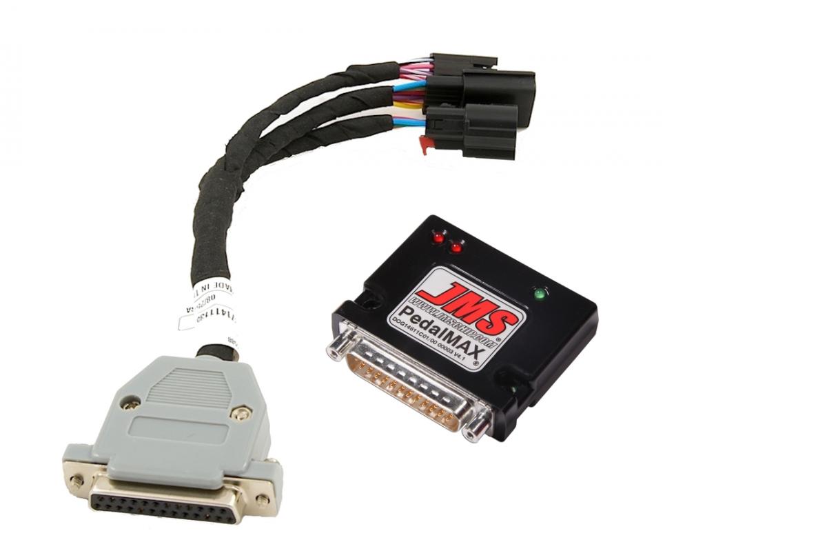

Xtra Posted May 16, 2017 Report Share Posted May 16, 2017 (edited) Just installed a PedalMax on my G2 Edge Sport Ecoboost. The install is very easy and quick with only a 10mm open end wrench needed to disconnect the negative post on the battery. It took me about 7 minutes to install including the control knob. I did not permanently install the control knob I just ran the wire through the tray under the center console and wrapped a loop around the transmission stick and thats where it sits. The cost is around $300 depending if you get the control knob or not. I would recommend the knob as it gives you adjustment of the PedalMax, from off to 100%. Once installed I could tell the defferance instantly, turbo lag was gone and I had tons more bottom end. The car flys off the line now and every touch of the gas pedal is answered instantly. The PedalMax does not mess with the stock computer settings like a tune does and leves no trace that it was ever there when removed. It comes out just as easy as it goes in. I love the way it unleashes all that horspower instantly and puts me in control of it. After running the PedalMax for a while then turning it off, Off is back to stock settings, I can say that stock has a very disconected feel to it and the turbo lag is disturbing and power takes forever to kick in. Though the PedalMax gives tremendous bottom and mid range it does nothing for top end. It does not increase HP or TQ output it just gives you instant access to it . If you want to make your 315hp G2 Edge Sport feel as though it has 400HP PedalMax is the answer. I would recomend it . Edited May 16, 2017 by Xtra 2 Quote Link to comment Share on other sites More sharing options...

Xtra Posted May 16, 2017 Author Report Share Posted May 16, 2017 Why not a tune? Then it will actually be a 400HP Edge instead of a wish I was a 400HP Edge. Ā Ā I have run a LMS tune and it does not give the same feel that the PedalMax does. The PedalMax responds to the smallest movement of the gas pedal with reduced turbo lag. Though the tune does give you more HP and TQ it does little for turbo lag . The Pedalmax gives instant throttle response something a tune alone does not do. And some people are reluctant to tune a car as it messes with the stock settings and can have warranty issues by leaving a footprint. The PedalMax leaves no footprint. Quote Link to comment Share on other sites More sharing options...

Nick Halstead Posted May 16, 2017 Report Share Posted May 16, 2017 Ā Not true acording to JMS. You just made that up about the PedalMax. there's a HUGE discussion about this same product on the fusion page, yes it's gonna improve throttle response as it changes the voltage for the drive by wire and puts it all in the beginning of the pedal depending upon your setting. Though using this and a tune is a better option. Quote Link to comment Share on other sites More sharing options...
Xtra Posted May 16, 2017 Author Report Share Posted May 16, 2017 yes it's gonna improve throttle response as it changes the voltage for the drive by wire and puts it all in the beginning of the pedal depending upon your setting. Though using this and a tune is a better option. Ā In this we agree. The effect is better throttle response And I can tell you from experience it is much better than the stock throttle curve. Unless you drive one you will never know how much better. I have run both together a LMS tune and the PedalMax Fun stuff! But for those who don't want to tune their car the PedalMax is a great option. Quote Link to comment Share on other sites More sharing options...
akirby Posted May 16, 2017 Report Share Posted May 16, 2017 It doesn't reduce "turbo lag" because it doesn't change the engine parameters. It just fools the system into thinking you hit the pedal harder. The delay is in the pedal itself and/or the software interpreting the pedal response. Ā Besides, there really isn't any turbo lag to speak of with ecoboost engines. 3 Quote Link to comment Share on other sites More sharing options...
Xtra Posted May 16, 2017 Author Report Share Posted May 16, 2017 It doesn't reduce "turbo lag" because it doesn't change the engine parameters. It just fools the system into thinking you hit the pedal harder. The delay is in the pedal itself and/or the software interpreting the pedal response. Ā Besides, there really isn't any turbo lag to speak of with ecoboost engines. Ā I can tell you have you never drove a car with one. If you had you would have a different opinion. Though in some ways you are correct, but the reality is turbo lag really is reduced when you have it set at 60 and above. Regardless of how it is accomplished. Quote Link to comment Share on other sites More sharing options...

Nick Halstead Posted May 17, 2017 Report Share Posted May 17, 2017 My thing is, if you think Fords internal logging can't detect that the throttle angle and voltage don't match, your falling into the marketing trap. Yes this product does exactly what it's designed to do, fool the cars computer system. which is exactly why I mentioned the 02 foulers statement earlier 2 Quote Link to comment Share on other sites More sharing options...

TheWizard Posted May 17, 2017 Report Share Posted May 17, 2017 To refute the claim that nobody else has one... I have one. Or rather, I had one on my Mustang but removed it. It doesn't impact turbo lag despite the manufacturer's claims. What it does is change throttle response by eliminating a built-in lag in throttle response of the drive by wire system (this was deliberately programmed into the system and is not considered a fault). It also ramps up the rate-of-change signal more quickly. That's why even stomping harder on the accelerator still won't produce the same response without the device. The device will give the impression that it changes turbo lag when it's actually changing throttle position sensor lag. Turbo lag is a function of the time it takes to physically wind up the turbine impellers and it simply cannot be changed electrically. As akirby said, turbo lag on Ecoboost engines is small because of the design of the turbos so making the throttle respond quicker gives the impression of reducing turbo lag. As long as you understand what it's doing, it does make a noticeable difference in throttle response so it can be an alternative to tuning if throttle response is the only improvement you're looking for. Ā I removed mine because the throttle response was too quick for use with a stick because it made it very difficult to match engine revs when downshifting. A slight blip of the throttle produced what felt like a disproportionate response. So I went to a tune instead and have been much happier with the overall results. That means I have a PedalMax sitting in my tool box that I would be happy to sell to anyone who's interested. It's supposed to work with all 2011 through 2017 Ford vehicles. 5 Quote Link to comment Share on other sites More sharing options...
