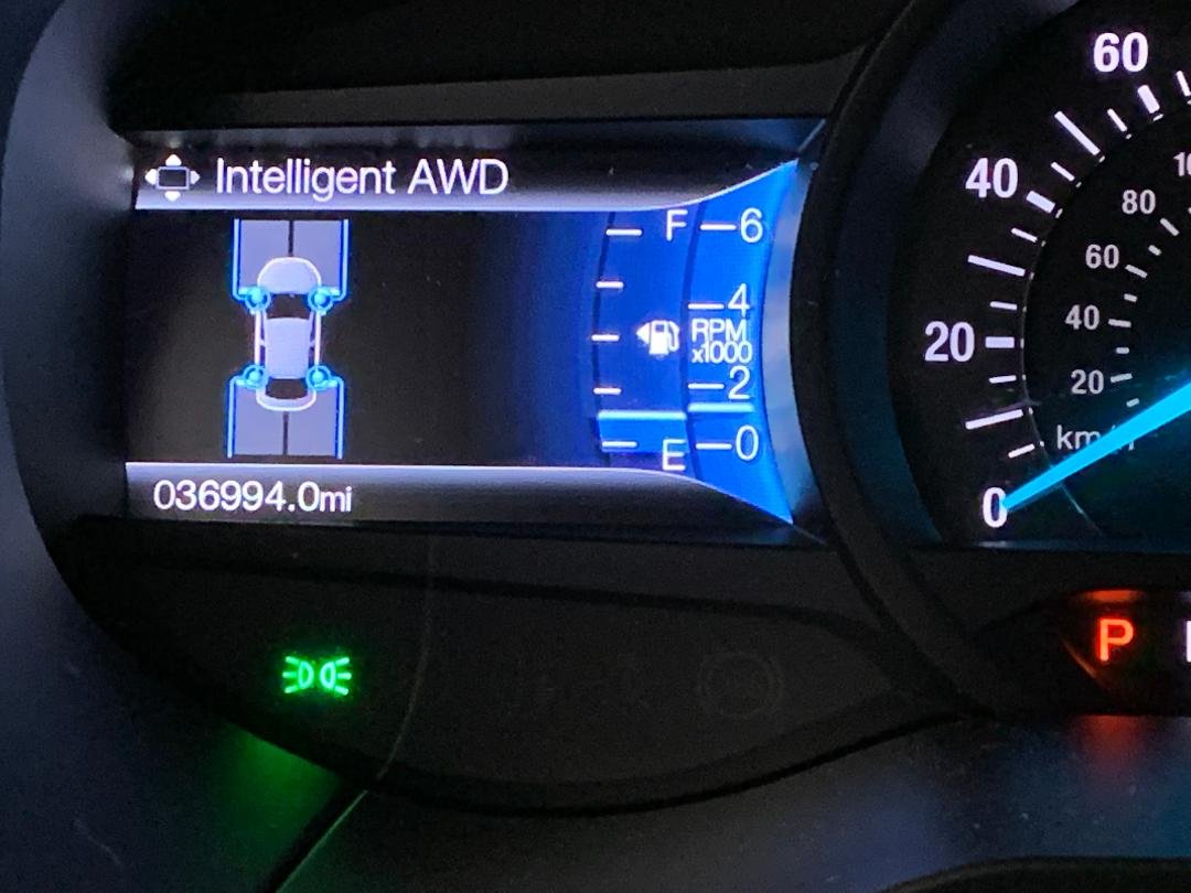

I got the LMS 93 aggressive tune. It really makes a difference. The vehicle is much more fun to drive. I like the quicker 0-60. I was watching some videos online of the tune. How does this person take off like this? I tried many times boosting to around 2000 rpm, but I spin my front tires and it is bumpy sometimes because it feels like I am hopping the wheels. How is this person able to turn off traction and get zero tire spin. A completely smooth take off. Are my tires shot? lol. They look to have decent tread still. They are scorpion verde 21 inch tires.

Yeah I am going with he most likely has AWD.  My ST will spin the fronts a little but not enough for wheel hop to occur before it shifts the power to the rear as well as the fronts.
Here is mine from when I first got the tune.
Edited by jamie1073
Yes, that is about the amount of tire spin I get most times. But I have to kind of ease into it. If I mash the gas to the floor at 2000 rpm about releasing the brake I get alot of spin.
