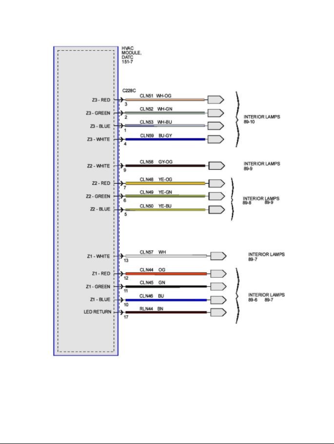

omar302 Posted March 10, 2021 Report Share Posted March 10, 2021 The touchscreen is called the APIM. The faceplate with the touch buttons is the FCIM. As far as i know, the HVAC module is not related to, and does not control, the ambient lights. maybe check the fuses if there is a common circuit for both. Quote Link to comment Share on other sites More sharing options...
stevie Posted March 10, 2021 Author Report Share Posted March 10, 2021 Quote Link to comment Share on other sites More sharing options...
