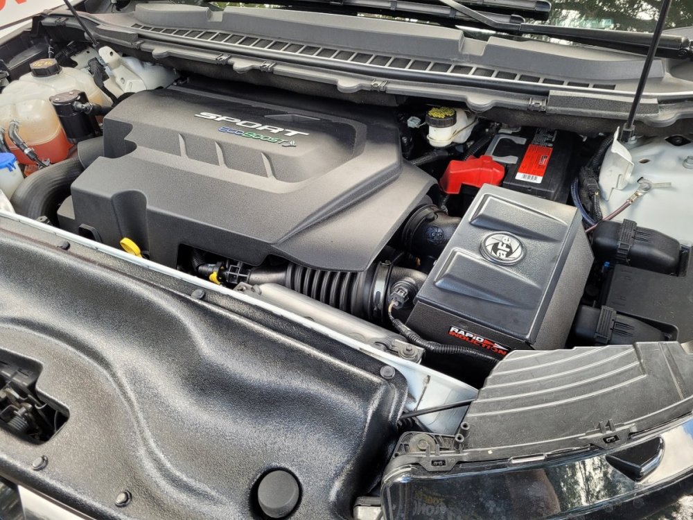

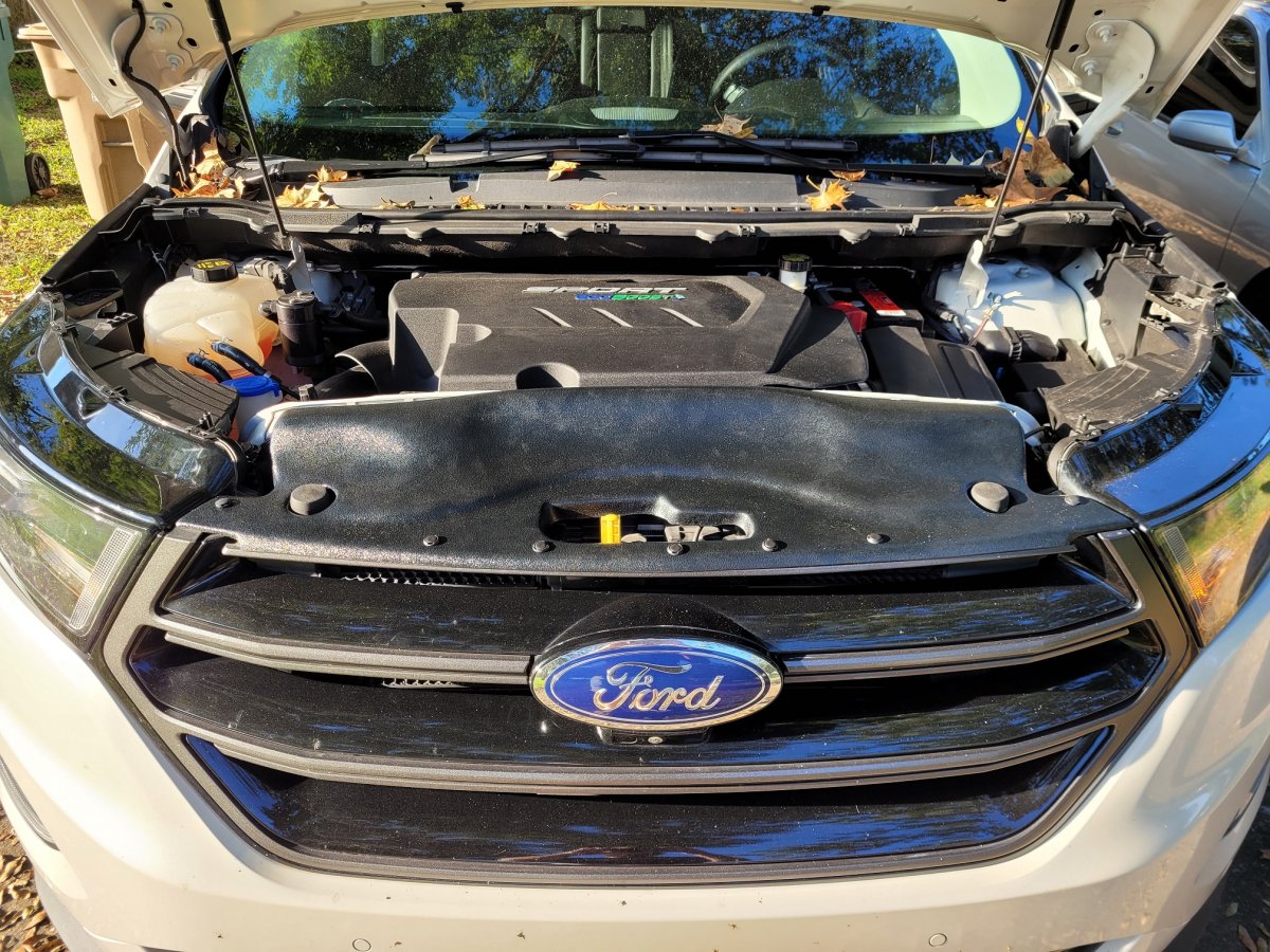

The fresh air intake mod from @Xtra came in recently. It's amazing what this person can design in their spare time. The fitment wasn't perfect but with a little wiggling, all fasteners snapped right in. Also included where 5 longer fasteners that were needed for the front.  Hood needed to be pushed down, I assume that gets easier after a few heat cycles. It will be interesting to see what this does for IAT's. I will be able to data to see if there is any difference.

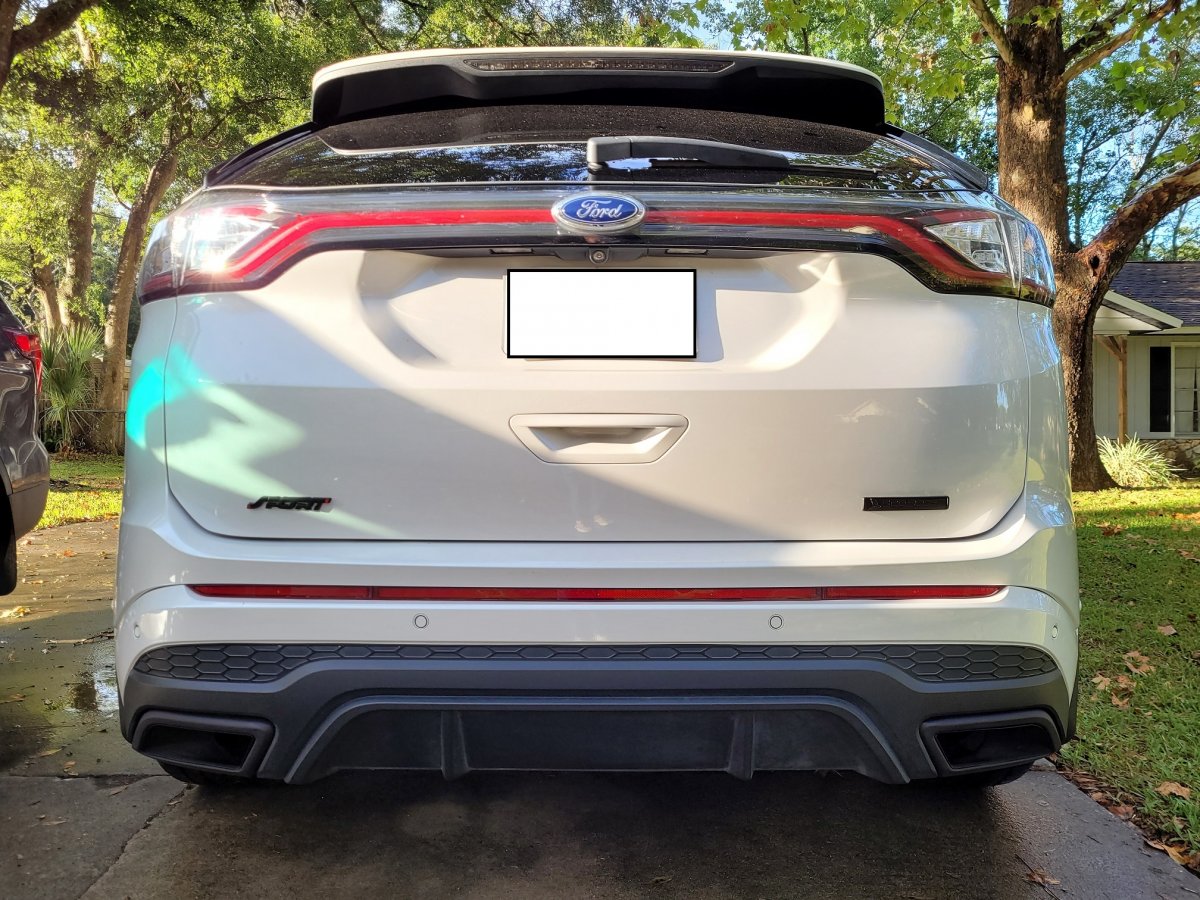

I pulled the badges and exhaust tips off. Painted the exhaust tips with flat black header paint and replaced the badges with some options from amazon. Amazon has a metal "Sport" badge similar to the explorer sport. I do not recommend this badge as its smaller than factory and is hollow making the double sided tape have little surface area to stick to. The other badge is a blacked out ecoboost badge 5 1/4" in length. Overall turned out great. I will probably replace the sport badge in the future though. The picture isnt great but I'm more than happy with how it turned out.

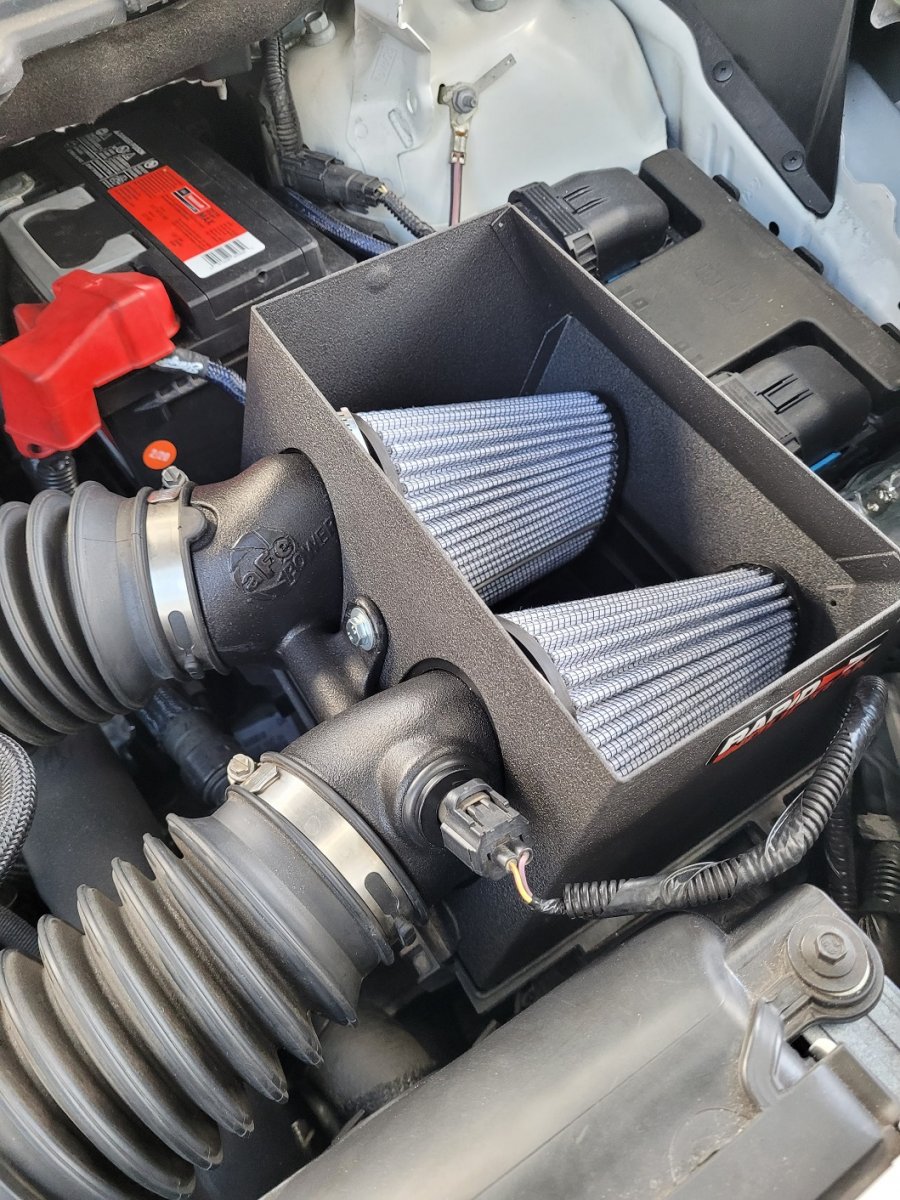

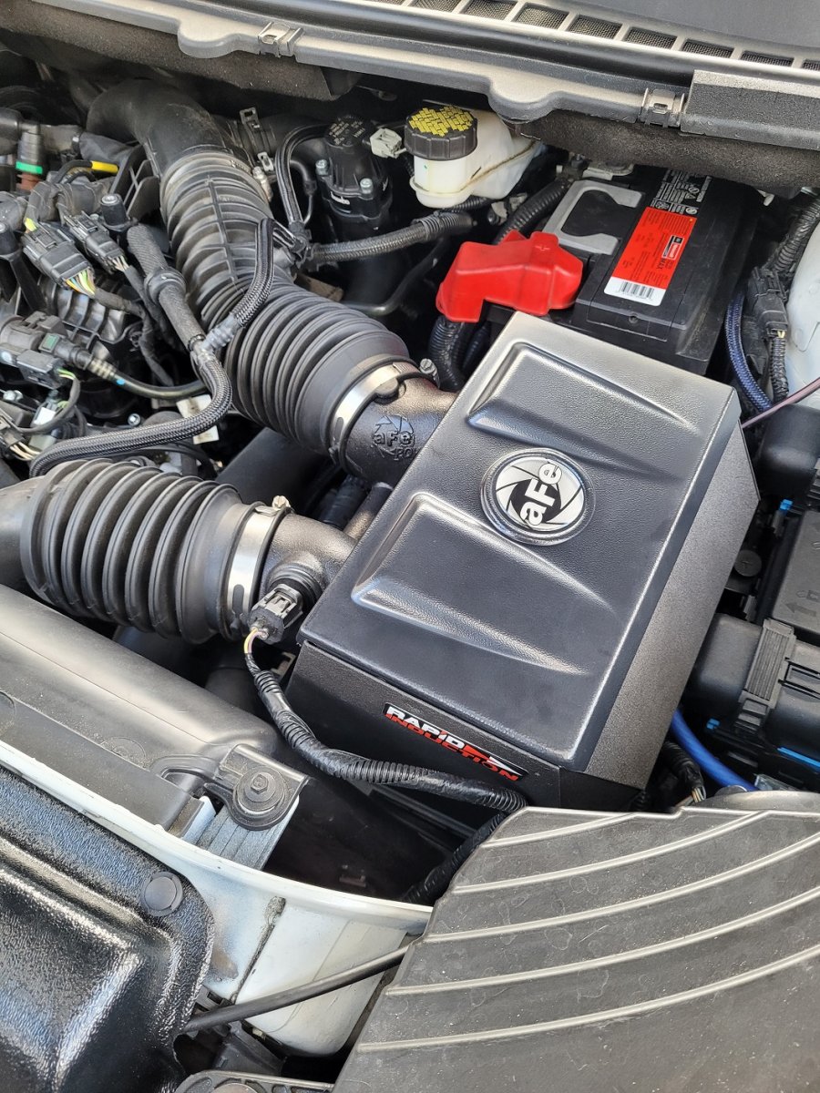

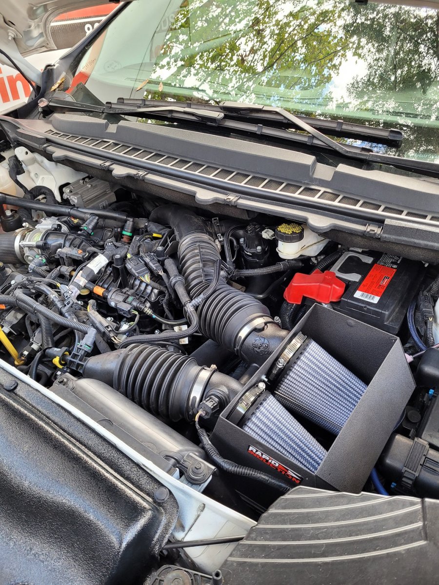

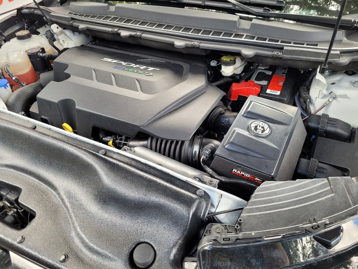

The intake finally arrived after a couple month wait. This was a test fit really since AFE stated that the intake only fit 2019+ Edge ST. Luckily for me it was a bolt-on fit with no issue or modification. This a metal upper airbox with plastic cap that replaces the factory upper airbox. It's latched in with the factory latches. With the cap on, there is no difference in sound and I haven't datalogged intake temps. I doubt temps change much with this setup since the intercooler is the weak link.

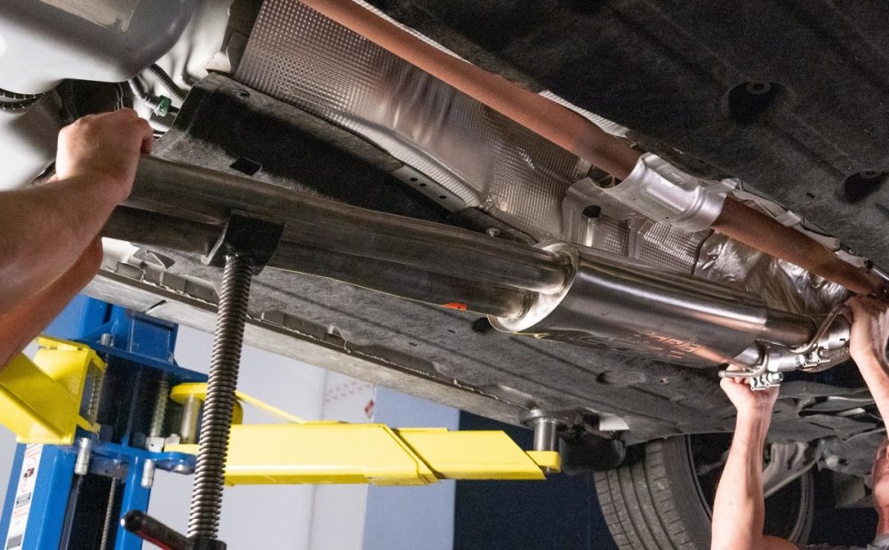

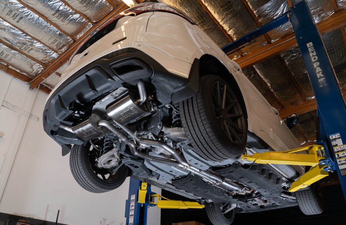

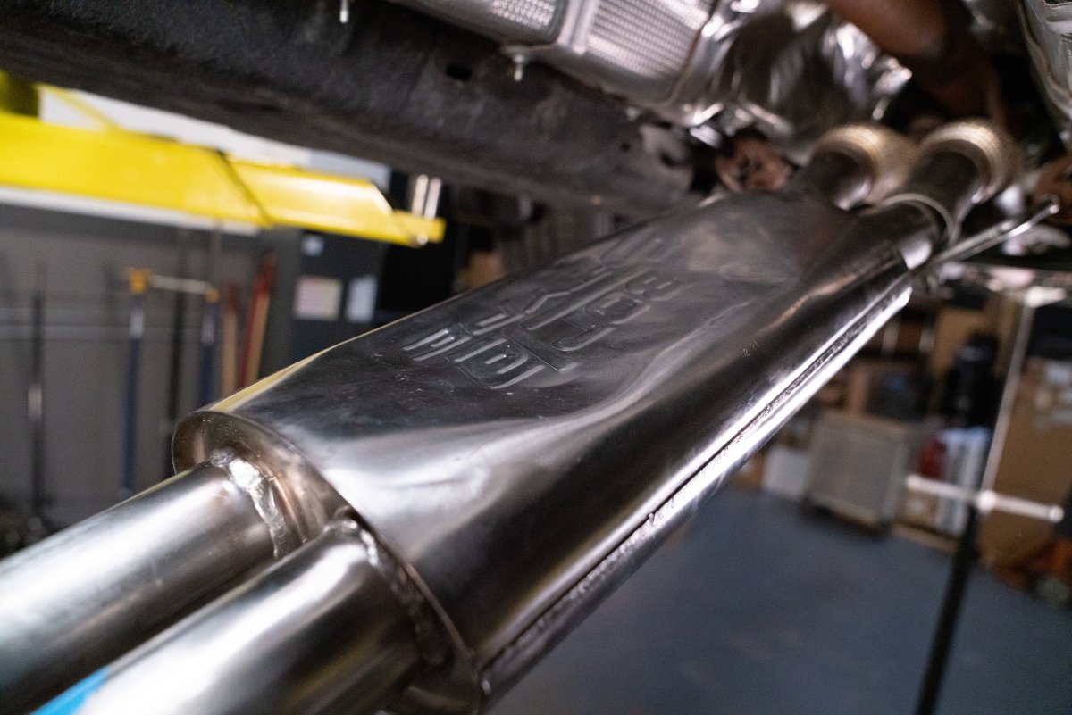

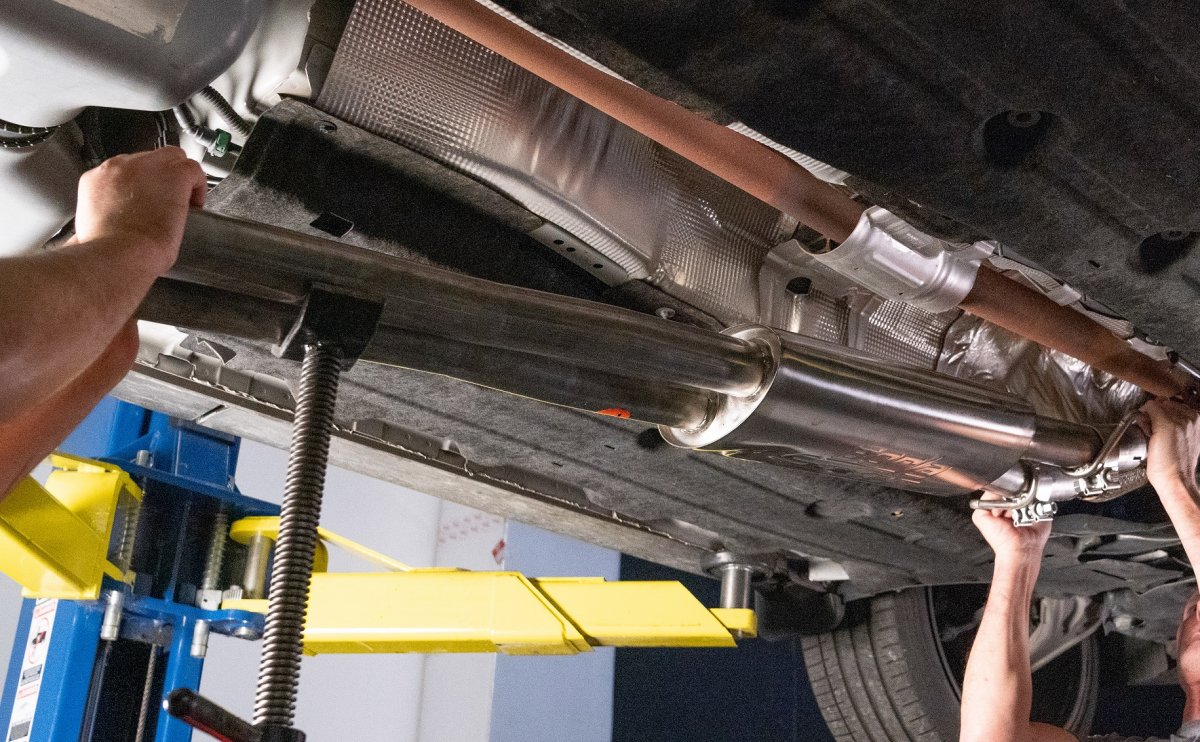

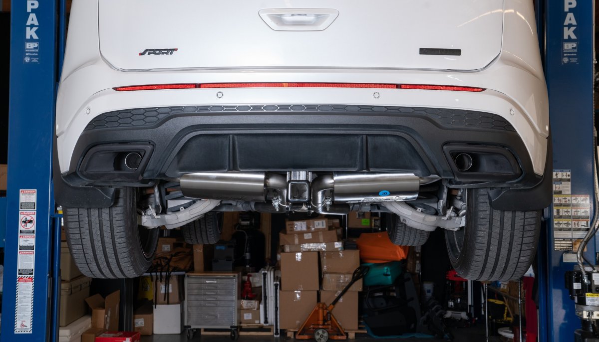

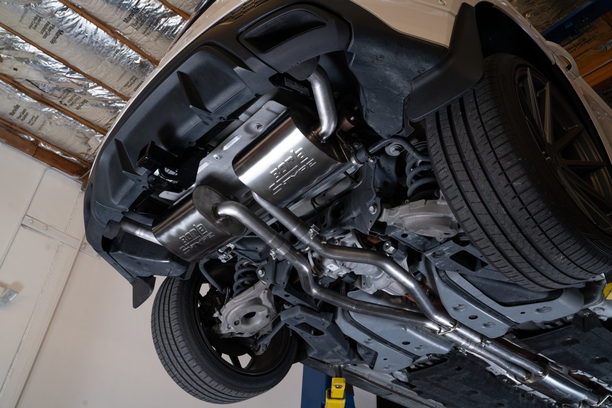

The Borla exhaust is now installed. There are some points of concern.
1- The connection from the factory downpipe to the exhaust is very tight. I suggest heating the pipe or widening the pipe a tad before installation. Not a big deal.
2- The exhaust tip lines up fine but its not dead center of the fascia. Its on the inner side of the fascia.
3- The exhaust pipe is the same size as factory - 2 1/4". I was a little surprised stock pipe would be that big. No performance gains expected after learning this.
4- The deal breaker - the resonator makes contact with the driveshaft carrier bearing. I actually crushed the resonator a bit to make it fit. It was a sloppy job but I knew this wasn't going to be a guaranteed fit.
With all that said, this is an exhaust for a 2019 Edge ST going on a 2018. My recommendation would be to modify the factory exhaust if you're looking for more sound/flow. Either delete the stock resonator or stock muffler. Since there is no upgrade in pipe diameter, it's not worth going with an aftermarket exhaust since there is no performance increases to be had.

1 hour ago, Cookiemonster117 said:
Have you noticed the intake lid coming off while driving? I know there were issues with the clear one.
Yes the cap has come off on mine already. There are small detents on the upper airbox that are supposed to hold the cover in place but the cover barely puts any pressure on them to fasten it. Easy fix is to drill a small hole in the upper airbox and throw a small panel fastener in there to hold it in place. I could post a picture but anyone with the intake will know what I mean. it's a small issue, but an issue none the less.
