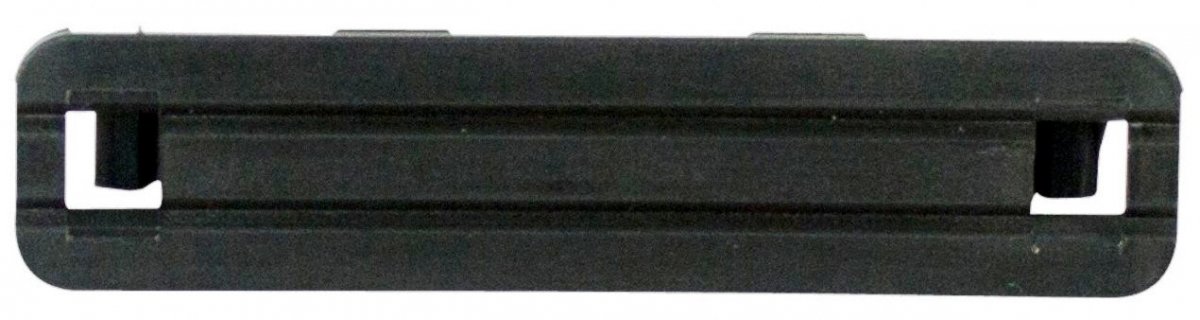

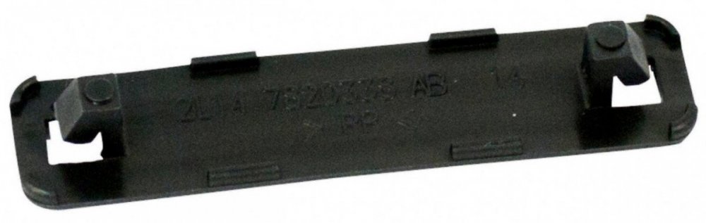

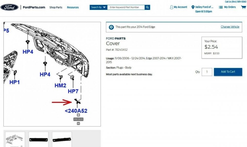

Haz Posted September 21, 2022 Report Share Posted September 21, 2022 Ford's online parts site lists the black plastic strips, which are also in place on the liftgate of our 2015 MKX, but the site offers no comparable covers for side door drain holes... For what they are, the one-piece design is surprisingly elegant, with retaining ears that facilitate quick assembly-line installation and also provide slits of openess when in place... The cover's backside includes eight molded lugs that stand the installed cover off the liftgate sheet metal and allow water & air flow through the liftgate drain holes... Due to the cover's design, and the fact that replacements being sold on FordParts.com, I expect the cover is intended to remain in place after the vehicle is delivered. Below is a PDF download link to the 2014 Edge Pre-Delivery Inspection (PDI) checklist showing tasks the Service technician must complete toward the vehicle being ready for its new owner. 2014 Edge Pre-Delivery Service Record.pdf While removing external & internal covers is mentioned under 'Appearance' in the document, these are typically plastic films and overlays that protect trim and upholstery during the assembly process and shipment to the dealer. Good luck! 2 Quote Link to comment Share on other sites More sharing options...
