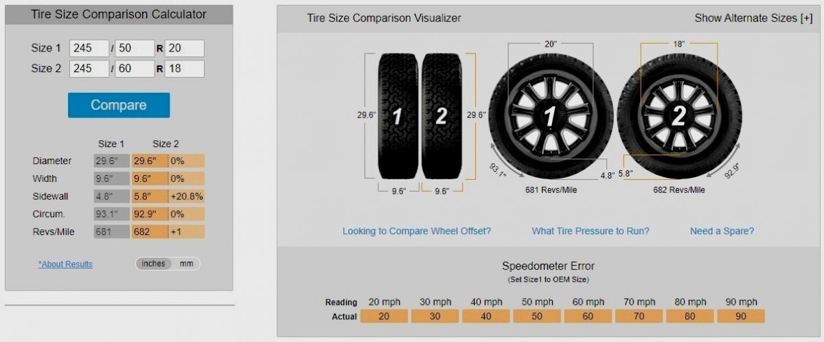

According to Wheel-Size.com, the 2015/2018 bolt circles (5 x 108 mm / 5 x 4.5 in), center bores (63.4 mm), and stud sizes (M14 x 1.5) are identical.
The following tire dimension & speedometer error comparisons are from TireSize.com (click on image to enlarge and/or save)...
Standard 2018 Edge Sport 20" tire versus 2015 Edge 18" tire

Good luck!

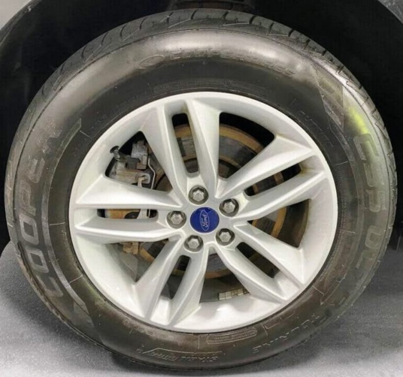

For visual reference of caliper-to-rim clearance, the following are images of the Edges from the vehicle sales website..
2015 Edge SEL AWD with 18" painted aluminum wheel and 245/60R18 tire (front)
124825577_2015FordEdgeSELAWD-18inchrim-tire.thumb.jpeg.f415e0a992b4069871e4873ce95060b1.jpeg
2018 Edge Sport AWD with 20" alloy wheel and 245/50R20 tire (rear)
817865737_2018FordEdgeSportAWD-20inchrim-tire.thumb.jpeg.7c250e710046647056010c323c49d9ac.jpeg

Just to close this one out, yes, the 18" wheel from 2015 fits a 2018 sport.
I bought wheels and checked one of them on the front, 'miles' of clearance.
As Haz mentioned, pretty sure the brakes on all gen 2 AWD models are the same.
