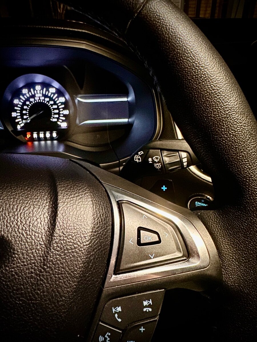

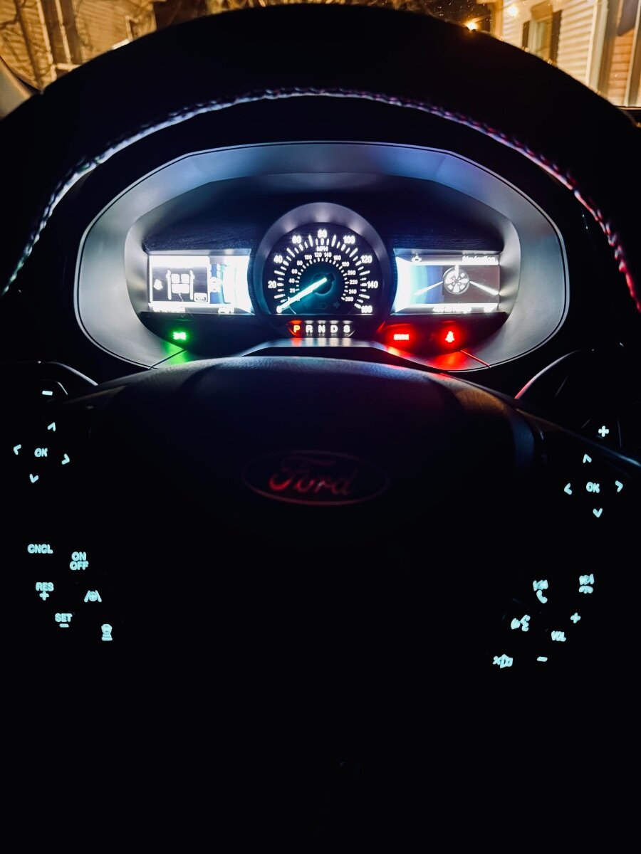

It took me a while, but I finally added the paddle shifters. I bought a used wheel off ebay for $100 and made sure it had the shifters. Some of the buttons were different and the wheel itself wasn't the nicest. So, I decided to swap the components I needed to my factory wheel, the shifters, rear trim piece and the wiring harness. After getting everything swapped over and re-installed, I hoped for the best but expected the worst. (Warning lights, it not working, etc...) but everything works perfect!
A while back I checked the transmission parameters with a scanner and it said "select shift up input high" "select shift down input high" this had me hoping the ecu was able to see a manual shift command if I added the paddles.
I'm very happy it all works!
