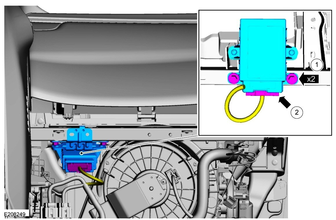

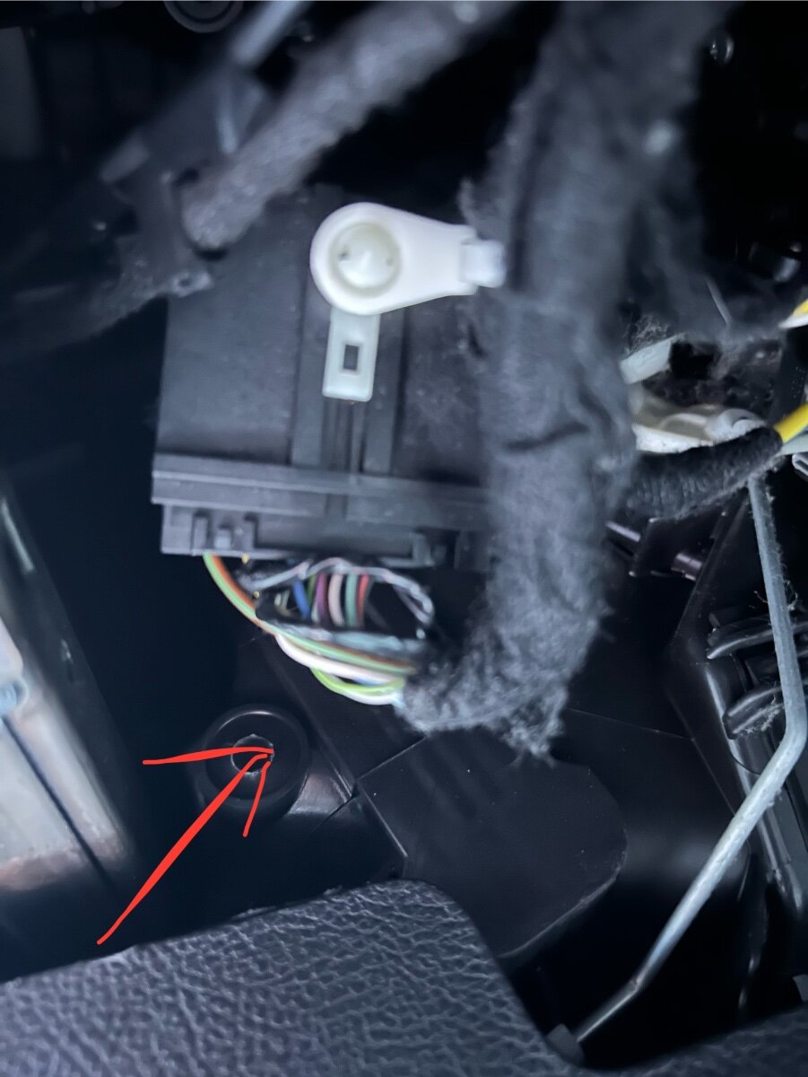

Wubster100 Posted January 7 Author Report Share Posted January 7 (edited) I searched around the glove box area, and I was able to find one unused connector. This connector is located underneath the ac blower fan. I am not sure if it is some kind of splice or what it is used for. Edited January 7 by Wubster100 Quote Link to comment Share on other sites More sharing options...

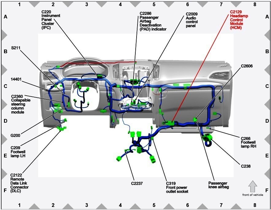

Haz Posted January 7 Report Share Posted January 7 If your Edge is not equipped with Automatic Headlamp Leveling... The mid and high series headlamps may be equipped with automatic headlamp leveling. The headlamp beam height is automatically adjusted according to vehicle load, speed, acceleration and braking. Automatic headlamp leveling is activated when the headlamp switch is in the HEADLAMPS or AUTOLAMPS position. ...then it may be Connector C2129 for the Headlamp Control Module (HCM), which is only installed on vehicles equipped with automatic headlamp leveling... Good luck! Headlamp Control Module (HCM) - Connector C2129 Pinout - 2021 Edge.pdf 2 Quote Link to comment Share on other sites More sharing options...
Wubster100 Posted January 7 Author Report Share Posted January 7 Yes, it is definitely for the HCM. I don't have the fancy headlights. If necessary, I may be able to use the HCM connector to allow the new IPMB to connect to the HS2-CAN network. Quote Link to comment Share on other sites More sharing options...

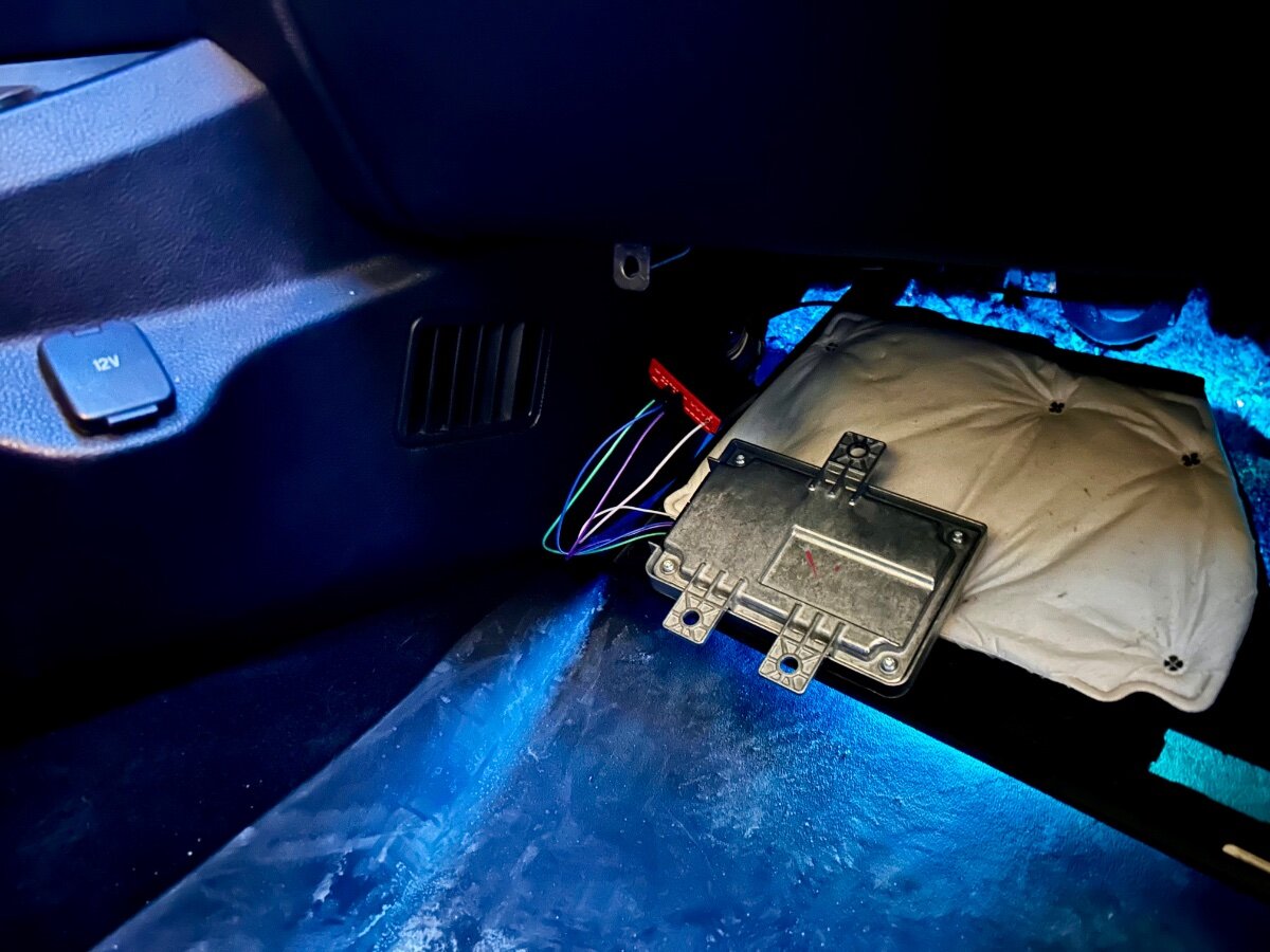

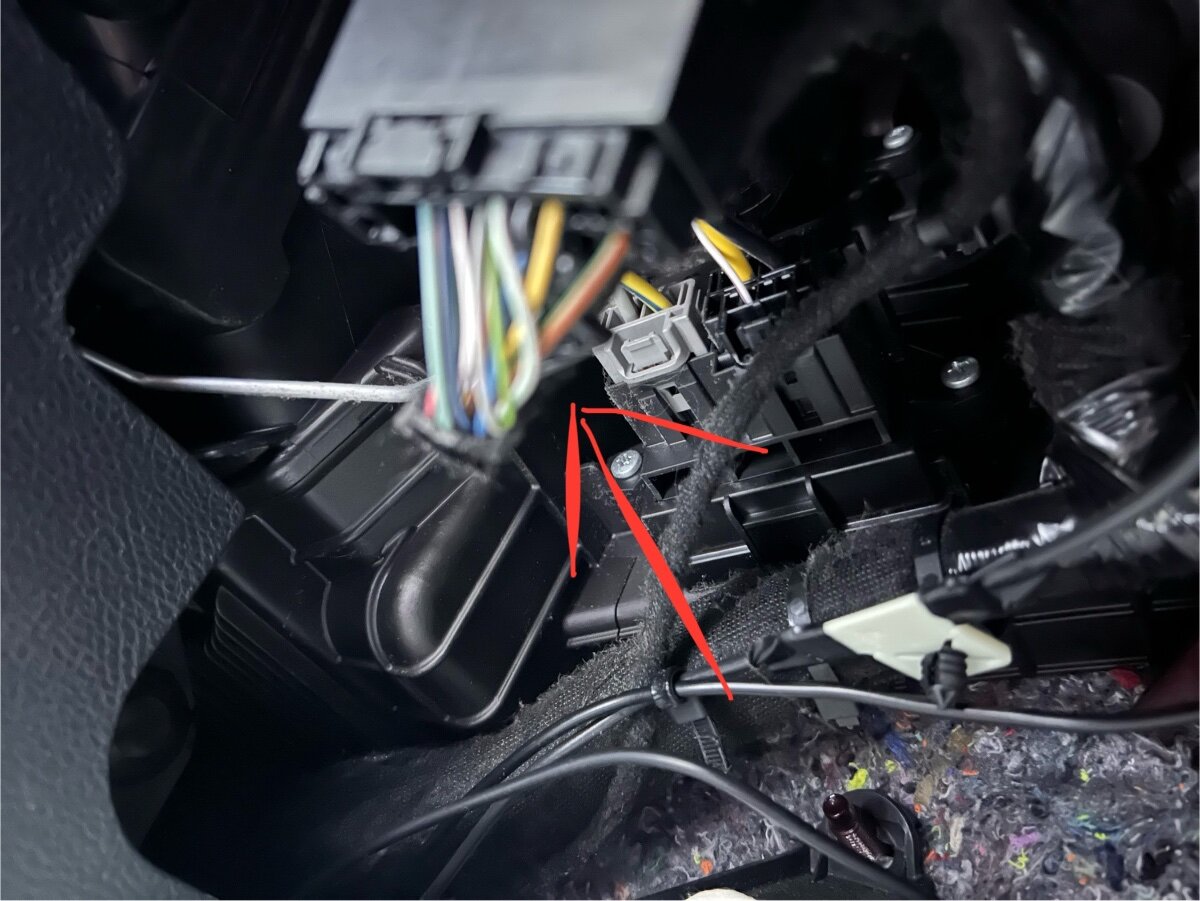

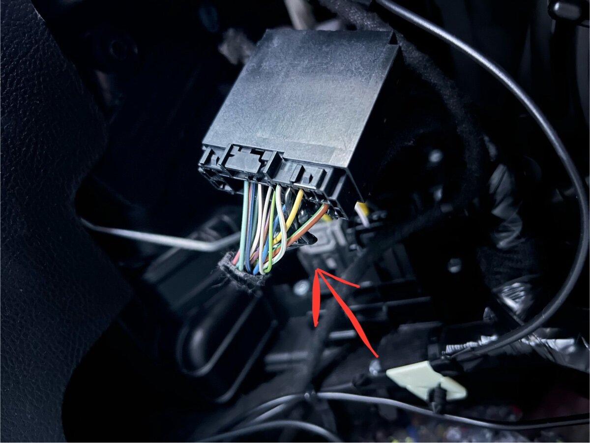

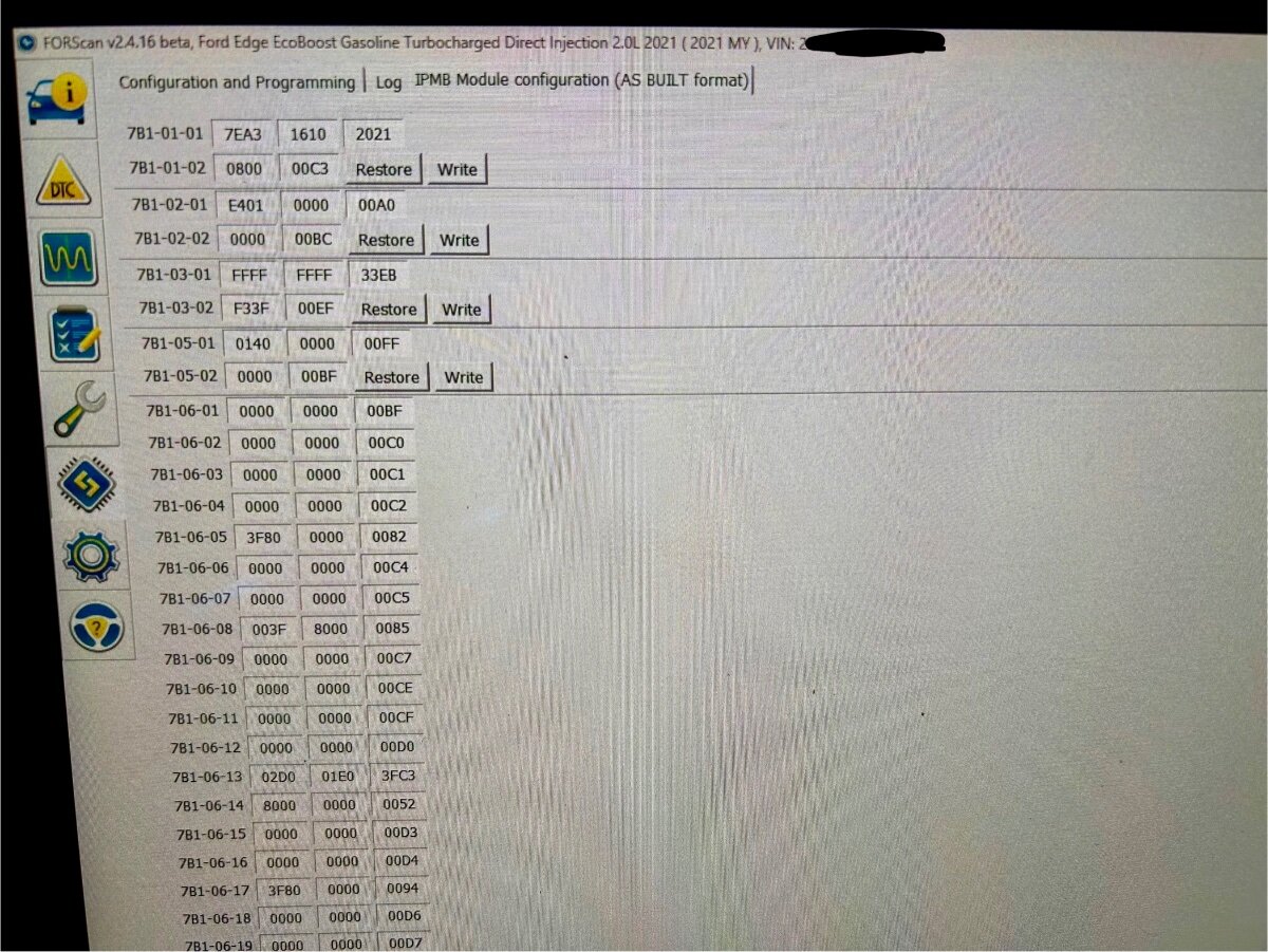

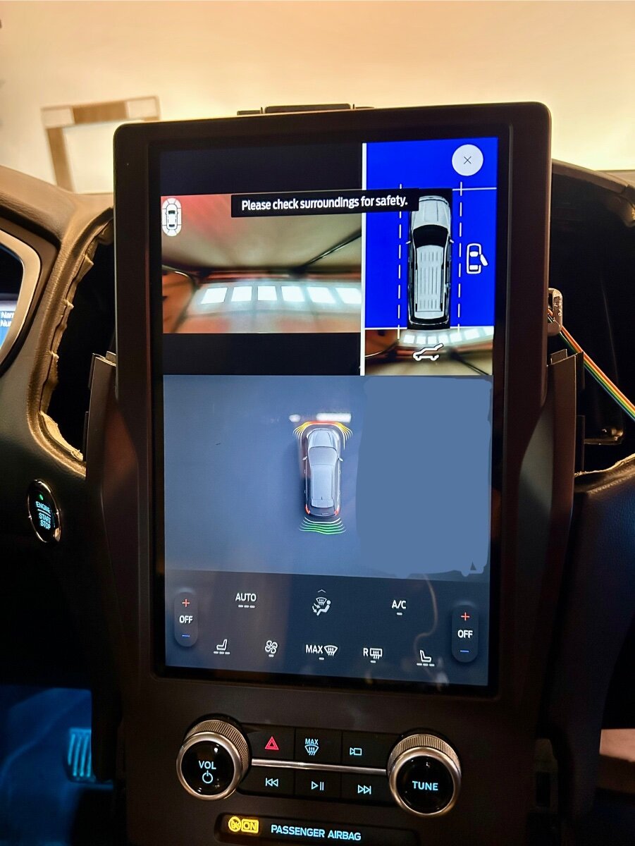

Wubster100 Posted February 15 Author Report Share Posted February 15 Hello everyone, An update to my progress. I was able to take the BCM connector apart for the rear camera LIN circuit. I added a loop of wire to it, so that I can easily connect to the LIN circuit it in the future. I connected power and CAN bus to the new IPMB using the HCM connection, and it works. The new IPMB is able to be seen in FORScan. My next steps will be to remove the touchscreen display to get access to the APIM connector. Then, I can connect my rear camera to the IPMB and test. Quote Link to comment Share on other sites More sharing options...
Wubster100 Posted February 15 Author Report Share Posted February 15 (edited) THE IPMB ACTUALLY WORKS!!!!!!!! Edited February 15 by Wubster100 Quote Link to comment Share on other sites More sharing options...
Wubster100 Posted February 15 Author Report Share Posted February 15 Quote Link to comment Share on other sites More sharing options...
