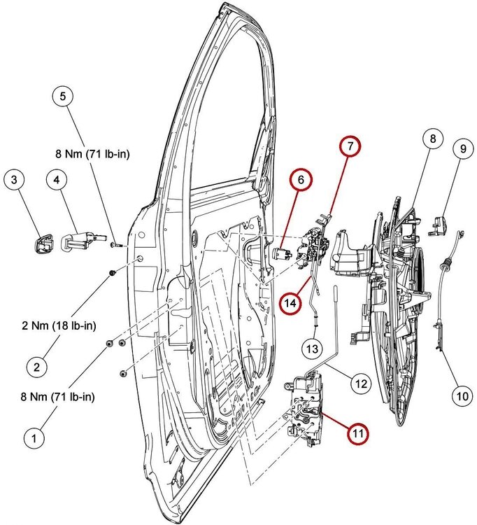

Haz Posted April 1 Report Share Posted April 1 Per the sections of the 2013 Edge Workshop Manual attached below as PDF documents, and the following illustration: The door lock cylinder (item 6), mounts into the door handle reinforcement (item 7), and a D-slot in the back of the door lock cylinder engages with the D-shaped end of the door lock cylinder actuating rod (item 14), which translates the door lock cylinder rotation into a lock/unlock effect in the door latch (item 11)... Only the door lock cylinder (item 6) is removable from the door's exterior, allowing inspection of the door lock cylinder's D-slot rotation, and, the position & condition of the D-shaped end of the door lock actuating rod (item 14). If these items appear good, then removing the interior door panel will be necessary to assess the other components. The following YouTube video provides a beginning-to-end glimpse of what may be involved in that subsequent inspection... Good luck! Exterior Door Handle - Removal and Installation - 2013 Edge Workshop Manual.pdf Door Lock Cylinder - Removal and Installation - 2013 Edge Workshop Manual.pdf Front Door Handles, Locks and Latches — Exploded View - Removal and Installation - 2013 Edge Workshop Manual.pdf Front Door Latch - Removal and Installation - 2013 Edge Workshop Manual.pdf Door Handle Reinforcement - Removal and Installation - 2013 Edge Workshop Manual.pdf 2 Quote Link to comment Share on other sites More sharing options...
customturnings@comcast.net Posted April 1 Author Report Share Posted April 1 21 minutes ago, Haz said: Per the sections of the 2013 Edge Workshop Manual attached below as PDF documents, and the following illustration: The door lock cylinder (item 6), mounts into the door handle reinforcement (item 7), and a D-slot in the back of the door lock cylinder engages with the D-shaped end of the door lock cylinder actuating rod (item 14), which translates the door lock cylinder rotation into a lock/unlock effect in the door latch (item 11)... Only the door lock cylinder (item 6) is removable from the door's exterior, allowing inspection of the door lock cylinder's D-slot rotation, and, the position & condition of the D-shaped end of the door lock actuating rod (item 14). If these items appear good, then removing the interior door panel will be necessary to assess the other components. The following YouTube video provides a beginning-to-end glimpse of what may be involved in that subsequent inspection... Good luck! Exterior Door Handle - Removal and Installation - 2013 Edge Workshop Manual.pdf 334.89 kB · 0 downloads Door Lock Cylinder - Removal and Installation - 2013 Edge Workshop Manual.pdf 103.79 kB · 0 downloads Front Door Handles, Locks and Latches — Exploded View - Removal and Installation - 2013 Edge Workshop Manual.pdf 443.07 kB · 0 downloads Front Door Latch - Removal and Installation - 2013 Edge Workshop Manual.pdf 401.8 kB · 0 downloads Door Handle Reinforcement - Removal and Installation - 2013 Edge Workshop Manual.pdf 867.35 kB · 0 downloads Thanks, I did take the interior door panel off and saw the D slot on the back of the lock Cylinder. I did not see any linkage on the D slot. I now suspect that the linkage wasn't secured properly when the dealer replaced the latch under a recall. Looking down through the window slot I couldn't see anything obvious. Going to watch the video and see if I can figure it out. Thanks again, 1 Quote Link to comment Share on other sites More sharing options...
enigma-2 Posted April 2 Report Share Posted April 2 On 3/31/2025 at 9:39 PM, customturnings@comcast.net said: I now suspect that the linkage wasn't secured properly when the dealer replaced the latch under a recall. Ahhhh ...... yup. That would have been a good thing to mention during the original write up. 🤔 1 Quote Link to comment Share on other sites More sharing options...
Haz Posted April 2 Report Share Posted April 2 Historical references attached below as PDF documents... Good luck! Customer Satisfaction Program 19N09 - Left Front Door Latch Extended Coverage - 12-12-2019 - Dealer Bulletin.pdf Customer Satisfaction Program 19N09 - Left Front Door Latch Extended Coverage - 12-12-2019 - Technical Instructions.pdf TSB 18-2013 - Door Ajar Lamp Remains Illuminated When Doors Closed.pdf 2 Quote Link to comment Share on other sites More sharing options...
