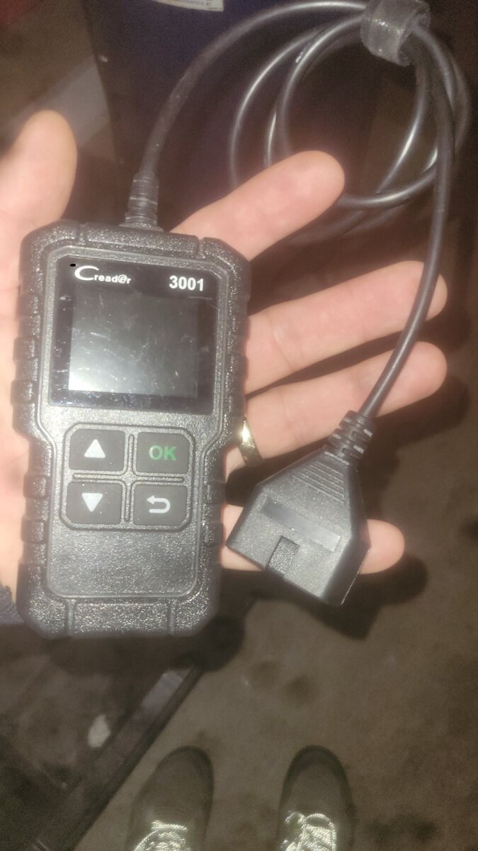

Wubster100 Posted September 16, 2025 Report Share Posted September 16, 2025 What kind of scan tool did you use? What were the other intermittent codes? Quote Link to comment Share on other sites More sharing options...
2015 Greygoose Posted September 23, 2025 Author Report Share Posted September 23, 2025 Only the 2 code came up. I use a Creader 3001 Quote Link to comment Share on other sites More sharing options...

1004ron Posted 20 hours ago Report Share Posted 20 hours ago Keep it to one thread. Use an OBDII dongle and Forscan to scan for codes. 1 Quote Link to comment Share on other sites More sharing options...
