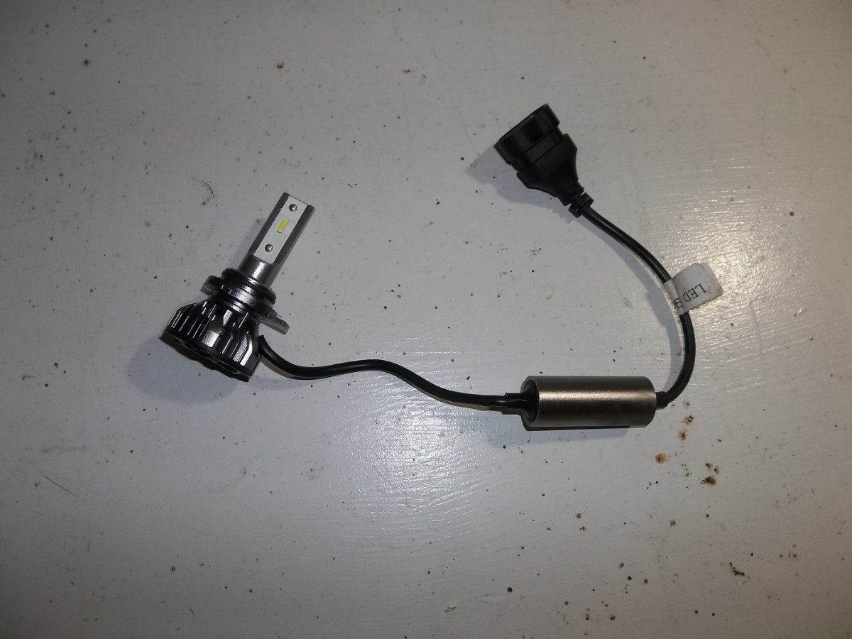

Recently, I wanted to replace the halogen bulbs since I thought that the drivers side one was burned out due to poor headlight pattern.
When I took out the old drivers side bulb, I discovered that it was LED instead of halogen.  I went ahead and replaced it with the halogen bulb anyway on both sides since I did not want to have halogen on one side and LED on the other.
Now- with halogens on both sides, there is nothing on the drivers side- no DRL (daytime running lights) or high or low beams.
I should mention that after I removed the LED on the drivers side, I turned on the lights with the LED bulb lying on the front grill, it lit up but there appeared to be smoke coming from it. I turned the lights off immediately.

If we can assume that the LEDs were aftermarket, there's a possibility that the LED were installed with an external driver box (a small metal/plastic rectangle attached to the wire.) If so, did you also remove this adapter from the factory housing as well? (This additional harness must also be removed.)

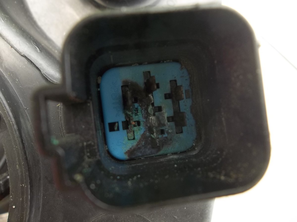

Many thanks for the reply.  There is evidence that the wiring has been changed from OEM- heat shrink tubing.... I don't see anything more inside the headlight assembly but will take a closer look when able.

Depending on the type and brand of LED that the previous owner installed, it may have needed resistors so when you're digging into the wiring be on the lookout for that.
