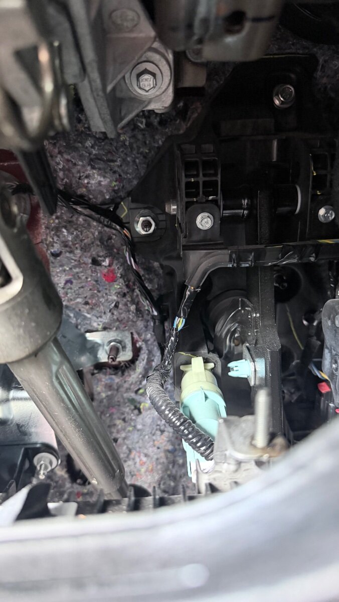

Hello all.  I have a 2021 Edge Titanium and am trying to install the Ford Alarm ML3Z-19A361-A.  I am suppose to install a T harness in between the vehicle harness and the Gateway Module.  I found a YouTube video for a 2020 showing the module just right of the steering, however, the two bolts holding the module in the video are empty in my Edge.  Please help me locate the Gateway Module.

Look for the OBD-II port. (Where you plug in a scan tool.) This port is physically attached right to the bottom of the Gateway Module assembly.
If you follow your OBD-II port up behind the plastic trim, your hand will go straight to the GWM.
To access the module you need to remove the lower plastic trim panel located underneath the steering wheel. (It's held in place by a few plastic clips and 7mm or 10mm screws.)
Once the panel is removed, look up to the right of the steering shaft. You will see a rectangular plastic module box with multiple prominent wiring harnesses plugged into it.
This is the exact location where you will perform the "T-harness" pass-through installation.

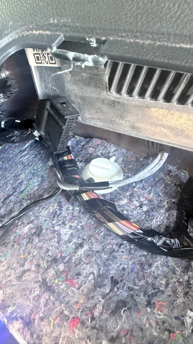

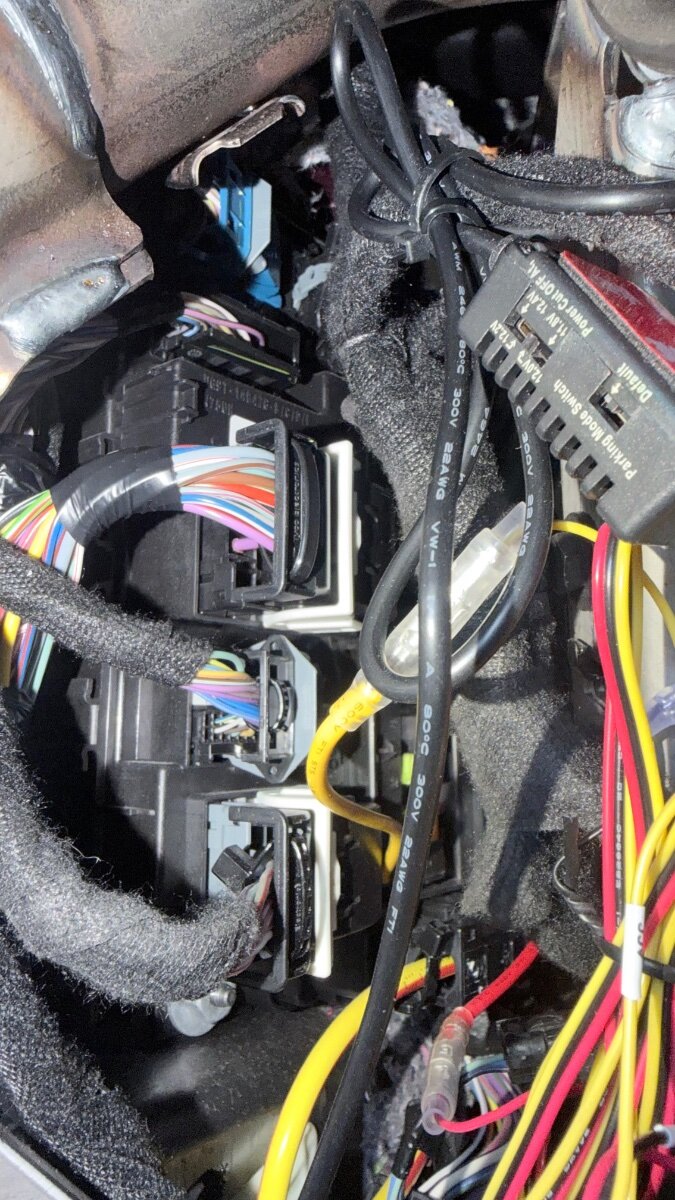

Is there any chance it could be part of the fuse block on the 21?  If so, it is tucked up to the left side of the dashboard. Also, this black plug is not the same size as the one in the kit.

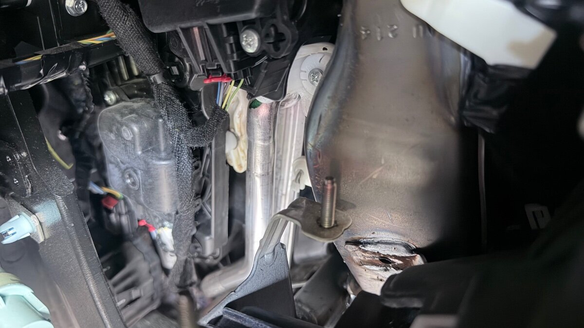

I follow the OBD-II harness up along the metal dashboard support, other smaller harnesses combine into it, then it goes up to the bottoms of the cluster and is fastened across a support all the way to the center display area. I lose it when it gets into there.

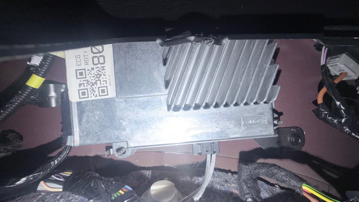

Definitely not the case on this edge.  I have a feeling it might be behind the screen. Are there videos on how to remove the big displays? All I’ve found are the small display removals.
Oh my, right rear quarter panel. Quite a ways from the OBD2 plug. Are we talking about the same gateway?  I will take the carpet down on Sunday to look for it.  I have a 8 hour drive home tomorrow then a wedding on Saturday.

Sadly, the main harness doesn’t have the correct size plug.  Anyone else have an idea where the correct gateway is located?

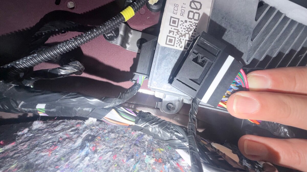

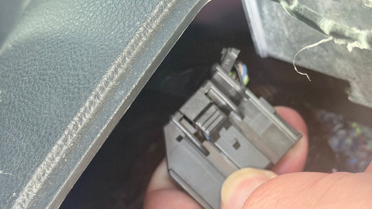

Did you try to unplug the connector from the Gateway and try to plug it into the other end of the T-Harness, the side not shown in your picture?
Even through the plugs look different from the outside, the the one on the T-Harness being straight and the vehicle's sideways (or L-shaped), from online photos, the actual connectors look to be the same and probably should plug in.
Edited by omar302
  • Thanks 1

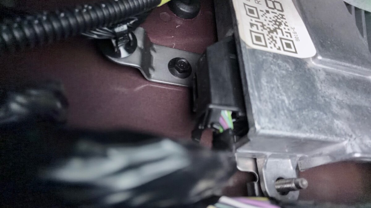

Thank you for being persistent in pulling the plug. It was the correct plug!  Amazing how much of it was hidden inside the module. The tab was tricky to release. The module is installed and working as expected. IMG_0433.thumb.jpeg.9a315f996f1c458e288ad353324a0d5a.jpeg IMG_0434.thumb.jpeg.66db8feab7fad04445cce7d5c3755a43.jpeg
