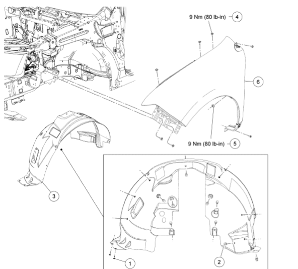

Two screws from where? There are many screws under there. Looks like all the screws at the front half portion of wheel well needs to be removed and pulled back, down, or at an angle, away from the inner well.
The 2 screws are from the ---> Fender Splash Shield. See the attached photo. [basically the shield inside of the tire well] NOTE: You do not have to remove all 8 screws to the Fender Splash Shield. Just the 2 closest to the bumper in the diagram its labeled #1 that way you can have access to the fog lamp. However, theres nothing wrong with removing all 8 screws from the splash shield in order to have more access/convenient
Edited by k_m
yep, remove a few of the offending fender well screws local to just the bulb being changed, peel back the cover and then have small hands as it is brutal to get up in there, and very awkward placement and other plastic pieces in the way when you do get up in there. replacing those bulbs is like a 30 minute job. read up on some of the fog light threads about it.
