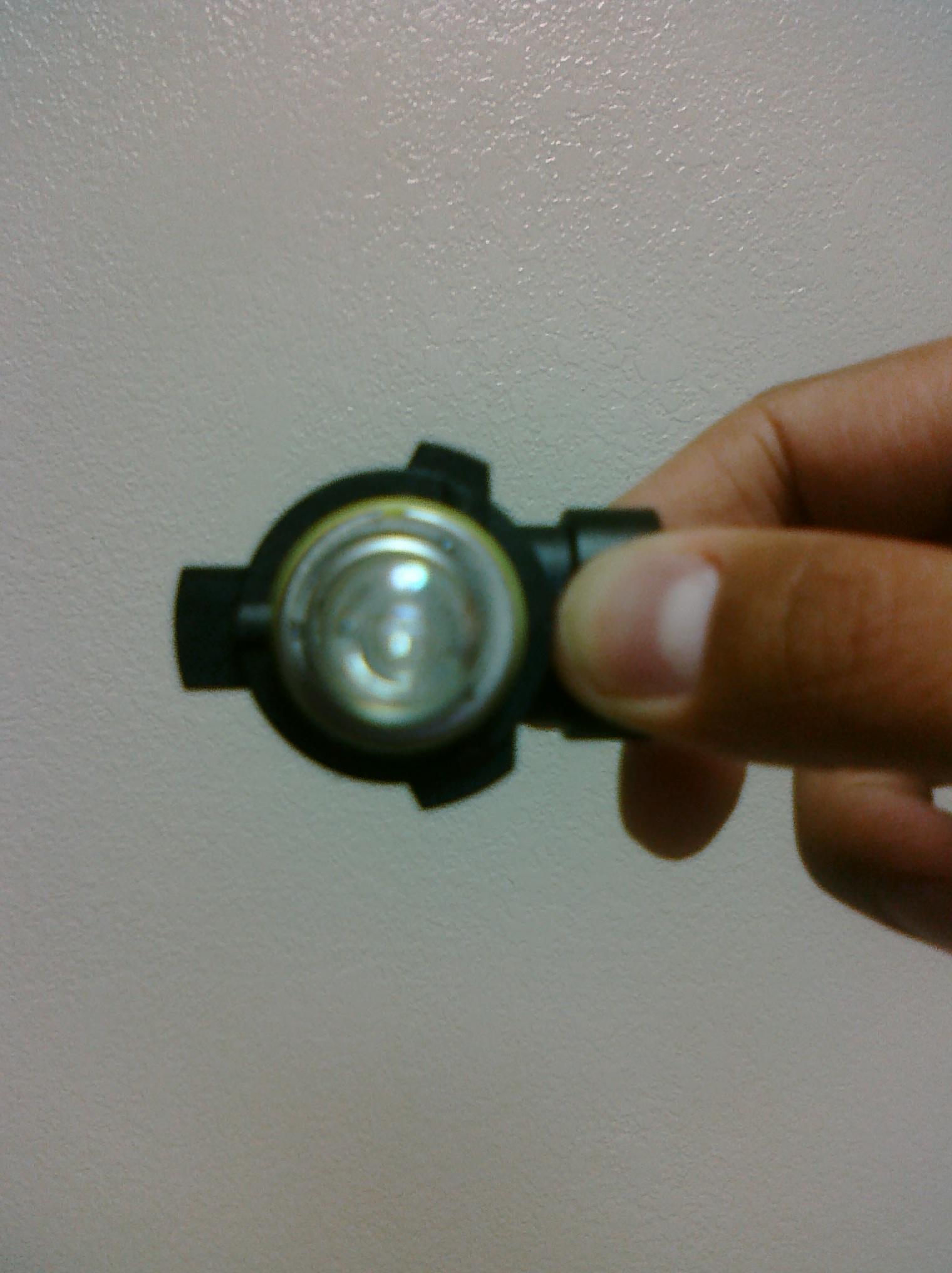

Since I've seen a few posts from people asking about the 9012 (2011 Ford Edge Sport) HID kit currently offered from Retrosolutions.com, I'll go ahead and give my experience:
Quick facts:
- I have a 2011 Ford Edge Sport
- I bought the following kit that was recommended by Retrosolutions: http://www.retrosolutionsllc.com/servlet/the-480/DIGITAL-HID-XENON-CONVERSION/Detail
- I have installed 9 different HID Kits in the past that include a Mazda3, Cobalt, Escape, Camaro, and Civic.
- Take a look at the photos and compare the tab pattern of Retrosolution's bulb(diagram picture) and the tab pattern of my bulb.
Installation:
I couldn't get the kit's bulb to fit perfect, flush, or reasonably secure into the housing/socket. Retrosolution's tab pattern simply doesn't match my sport's tab pattern. I would accept two tabs fitting, but for the price they charge, only one tab being able to fit doesn't make sense. When securing only one tab into the socket, it results in the bulb to sit slightly crooked, which can possibly lead to aiming issues.
Conclusion:
I'm currently discussing the issue with their customer service, but it seems that I'm the only one to report the issue with the 2011 Sport's. I could have made a mistake on my part as far as installation is concerned, but I doubt it since I've installed a few kits on different vehicles. In my opinion, their kit requires cutting to make it fit, which is what they advertise as "not needed." Like I mentioned, I'm still discussing the issue with them, but I'll provide updates as soon as I get them. I'm just trying to save members from possible headaches, unless they want to try give it a try and make it fit. I'm hoping someone does, just for my sake.
As a side note, the kit does seem to be good quality, and their customer service reply's have been within a reasonable time frame. I'm not putting down the company or their kit's, but I would hold off before purchasing their 9012 kit for a 2011 Sport model. I can't speak for any other models.

I dont have the retrosolutions kit.. but i installed the DDM kit (with the wiring harness) and i modified the bulb by shaving off the tab on the right. The bulb fits in the housing theres little no play.

Based upon the photo published earlier it looks like the HID bulbs are not ideal for this application in that the scatter is unreasonable and the high beam pattern is way out of compliance with any existing standard for uniformity and shape. It all looks like the point of light in the bulb is not properly located. Perhaps this is why such conversions are not recommended by anyone in the lighting industry.
