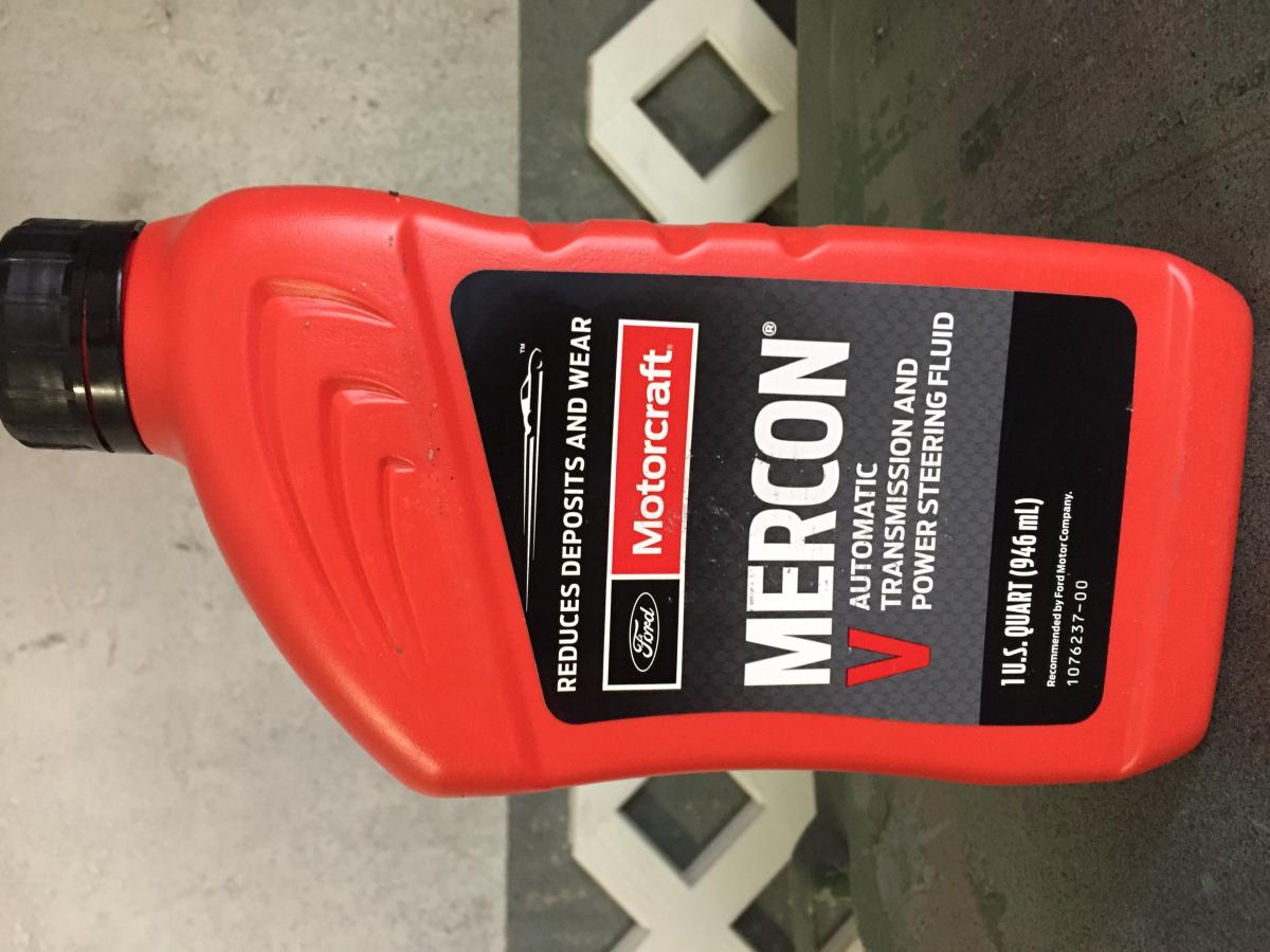

If you doing a single drain/fill, best to stick with Motorcraft brand Mercon V for your 2009.  I like the Castrol Mercon V also, but am leery of mixing product chemistries even when certified by Ford.  If you plan on fully exchanging out the fluid, then Valvoline (as mentioned) is a great alternative.
