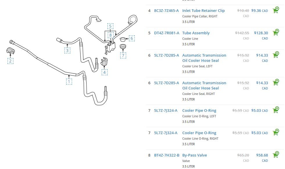

	I'm alittle confused. You are mentioning trans fluid leaks but say they told you to replace your a/c condenser? Are you looking for O-rings for the trans cooler lines?

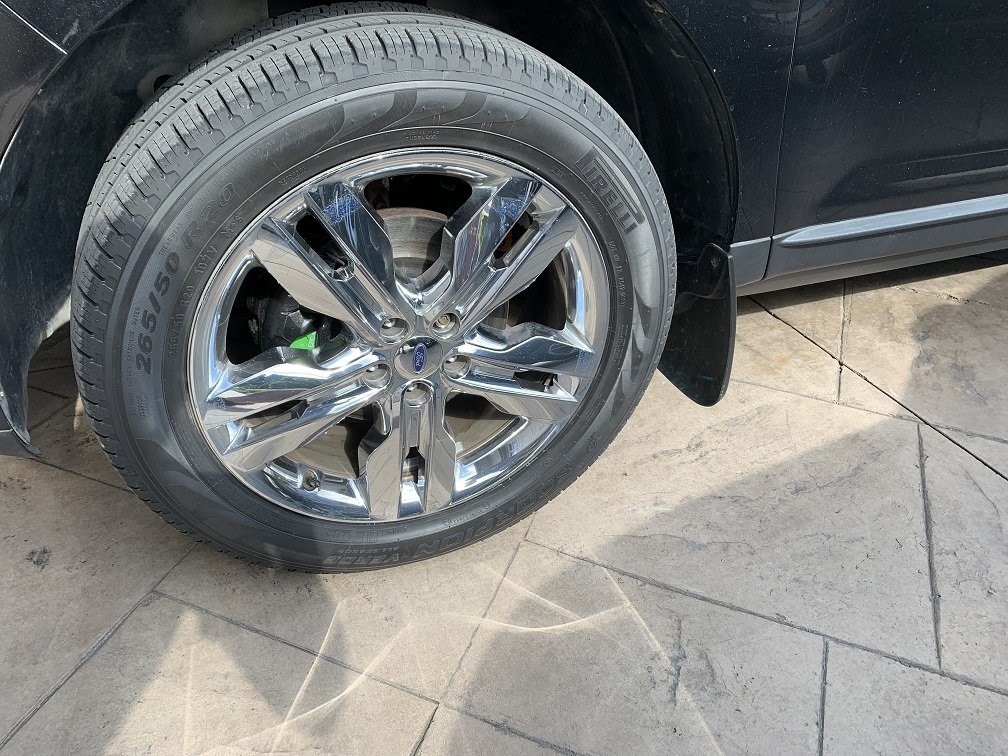

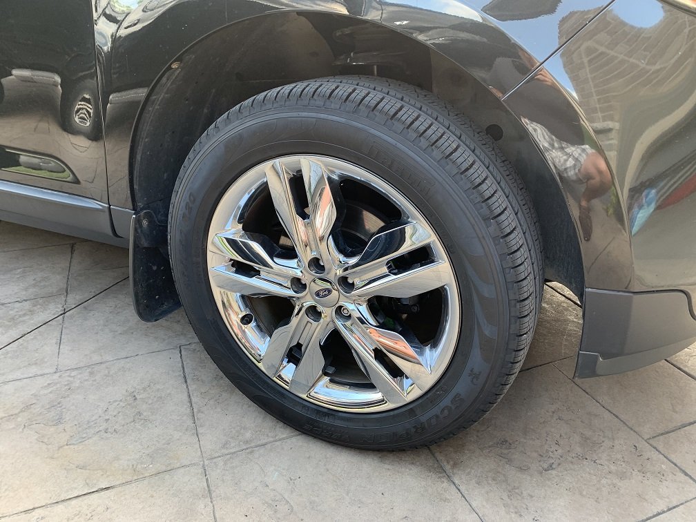

	I've been hunting for new rubber for awhile now and deals on 245/50R20 which is factory sizing on the 2011 Edge are non existent so I figured why not fill out the fender wells alittle more. Today I had 265/50R20 installed on the factory 20x8 wheels and it looks much better. I've read some say 8" is too narrow but I now daimler uses 265/50R20 on 20x8 for the grand cherokee and durango. I scored a great deal on brand new Pirelli scorpion verde all season from kijiji.
