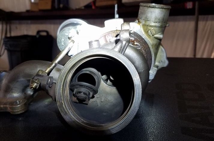

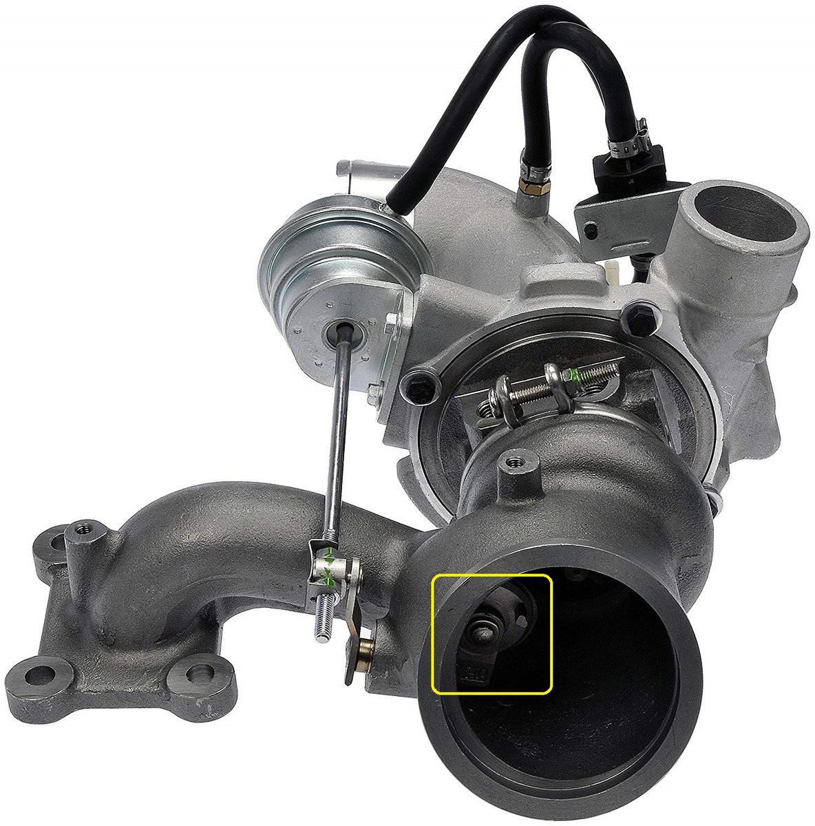

The linkage for the actuator, the part inside the turbo housing is typically what breaks. Are you perhaps referring to the wastegate/BOV itself? I am not familiar with the F-ST turbo setup, but generally EB turbos have integrated actuators. Here is a pic from Turbosmart The linkage that breaks is highlighted in the attached pic

Hello & welcome! What is the code you are getting? Most likely you will need to replace the turbo because of wastegate actuator failure.
