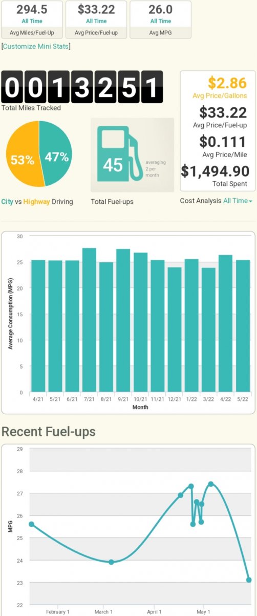

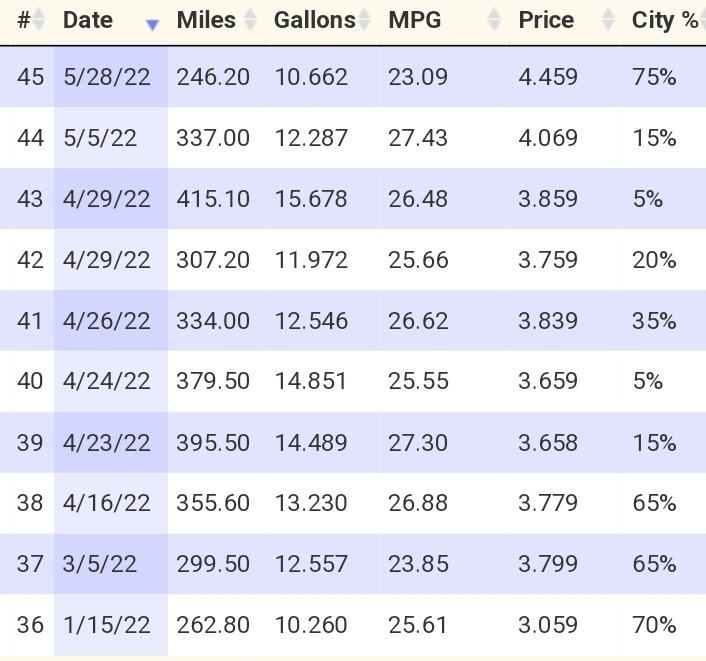

Did some errands tonight and the auto start/stop worked as it should. My trip mpg, which I reset after every fill up, shows me at 27.3 mpg for this tank ? -

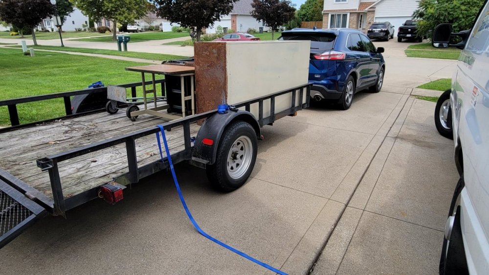

I just remembered something that it also has to be AWD to get 3500lbs, FWD is limited to 2000lbs. I think that it has something to do with bigger brakes & when you take off the weight transfers to the back, so having AWD helps there. All 2016 - 2018 Sports are AWD (2015 they made some FWD versions) & all ST's are AWD. If I could go back in time, I would have bought my 2020 SEL with the towing package so I wouldn't have to install the hitch & wiring, but I have a better hitch & don't have a hole in the bumper. If you want to continue towing near the max towing, I'd recommend changing fluids much earlier than recommended, upgrading your pads & rotors & look at helper springs to deal with the sagging. I bought Air Lift Springs & they definitely help with sagging when towing heavier things or when I have passengers in the back or lots of cargo. -

You sure that it wasn't the previous Gen? Because there's no oil cooler or trans cooler part of the towing package for the 2015+ edge. The Sports didn't have a factory towing package & you'd have to go after market for a hitch & wiring, but limited to 3,500lbs. I also have a Curt class 3 hitch & after market wiring for a 4 pin connector. I usually just pull a ZTR, but I can pull a more if I want to. -

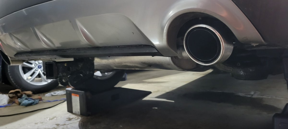

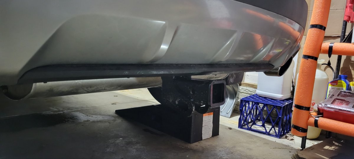

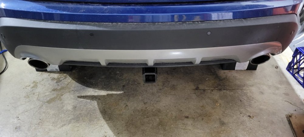

I can say that the Curt & other units like it aren't plug & play. You do have to wire to a power source, either the battery or the interior fuse panel with an add a fuse/quick fuse. They're not difficult to install, but definitely aren't plug & play. I used the Curt Class 3 hitch on my 2020 SEL AWD & the Curt T harness wiring. The only downside from the factory hitch is that the hitch sits 3-4 inches lower than the OEM one as it comes from under the bumper instead of through the bumper. The Curt Class 3 hitch probably took me ~2 hours to install by myself. Would have been less if I had help. I also installed Helper Springs to keep it level while towing. -

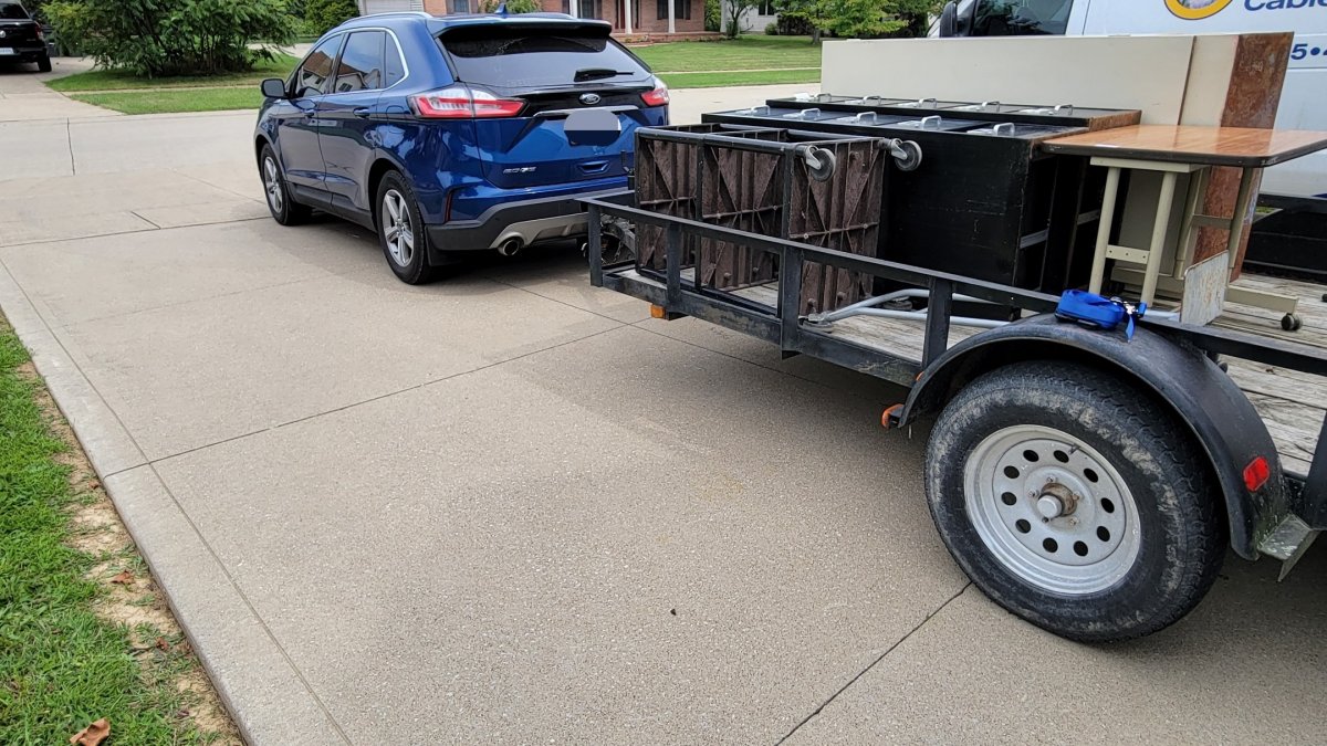

Definitely rides better while towing with the Helper springs installed. In the dual pic, the latest pic is the top pic -
City driving / short trips kill my mpgs on my 2020 SEL AWD. Fuel quality & tire pressures play huge in these vehicles. Gas isn't the same, look for top tier fuel & I keep my tire pressures around 38psi in the front & 39psi in the rear.

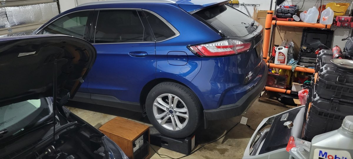

OLM said 42% & I usually change it around 50%, so past due in my book.
