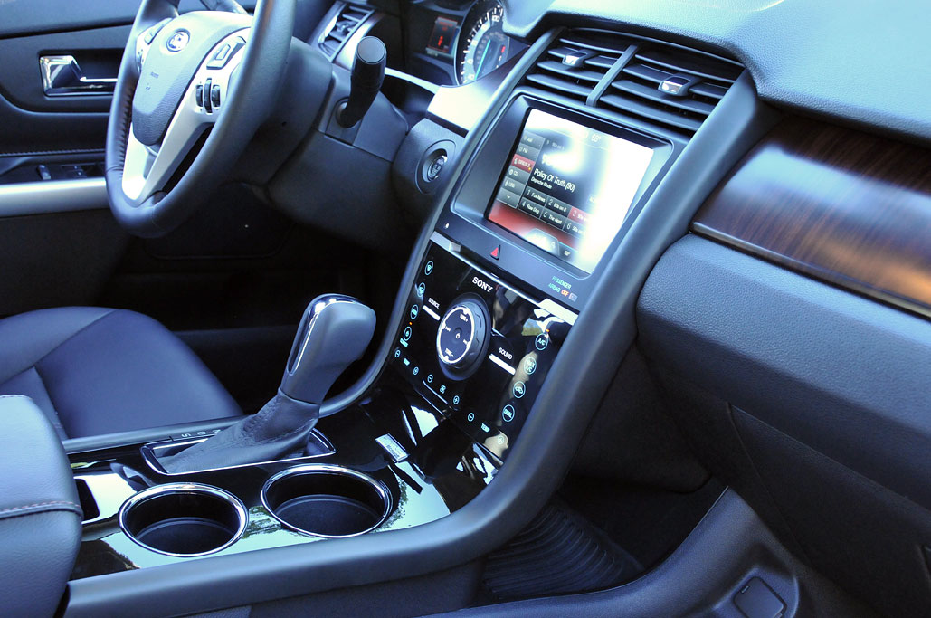

Has anyone taken the silver molding off on their edges?
The upper portion comes out very easily, but the bottom is much more difficult. I've taken the window switch out and I'm still unable to figure it out.
I'm covering all of that trim in 3d carbon. So far the center console molding is done, as well as the upper door handle molding. I wasn't sure if it will look too cheesy, but it surpassed my expectations.
Any help is appreciated.
Edited by DmitrySychev
Thanks for the compliment!
This is the stuff I got. http://www.ebay.com/...984.m1497.l2649 It's 3M GLOSS Black Di-NOC Carbon Fiber. Looks really nice in person and has a nice textured feel.
If you're thinking of doing it, that 12x48" sheet is more than enough to cover all of the silver trim except for the steering wheel. A heat gun or a blow dryer is an absolute must. What's nice is when you heat it up to work with it, it doesn’t deform or stretch in any way that ruins the pattern.
As for the trim I couldn't take off in the pictures, it seems there's no way to take it off without taking the door panel off. I think I'll just try to apply the vinyl with the trim pieces on the car. Don’t really have the time to take the whole door panel off.
So far, I've used the 3m gloss black Di-Noc on each side of the center stack and on the trim piece located above the glove box. It looks awesome. Now I need to figure out how to remove the two trim pieces (same color as above the glove box) on each side of inst. panel. Looks like you have to remove trim around 'Start' button to get to the piece above it that I want to cover with carbon fiber. Worked on this for awhile but gave up before I broke something. I moved over to the left side and tried to remove the panel that has 3 switches in it so I could get to the piece above it that I wanted to cover. Gave up on that side also. Anyone with tips on how to remove these trim pieces? I sure would appreciate it.
