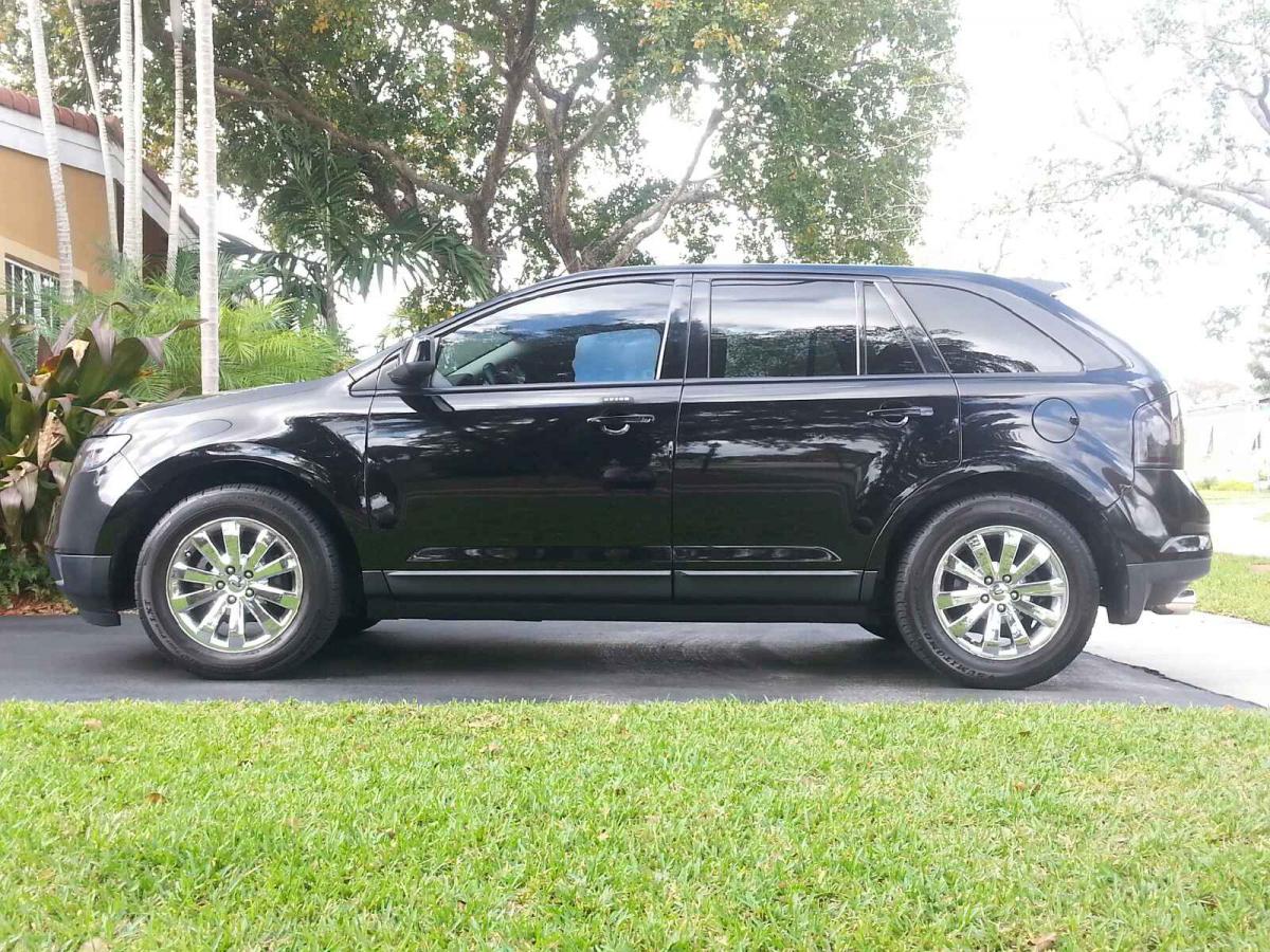

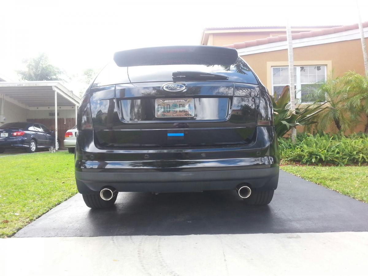

lowered my edge but dont know how to fix camber on rear tires
