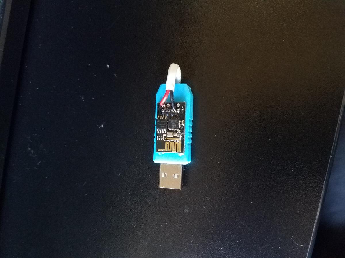

luxpow Posted July 30, 2016 Author Report Share Posted July 30, 2016 (edited) I feel so silly for not thinking of ESP8266 for taking akirby's idea to fruition. Its a tiny $6 WiFi module which supports both client and AP (access point) modes. I should be able to build a quick circuit that plugs into one of the USB ports in car. When Car turns on, so will the circuit which creates a WiFi network my cell can detect to turn BT on or off. Or I might just make it a battery powered circuit and recharge/replace batteries when needed. Now I am feeling smart again :-) Edited July 30, 2016 by luxpow Quote Link to comment Share on other sites More sharing options...

luxpow Posted August 22, 2016 Author Report Share Posted August 22, 2016 Built it finally ! I keep this plugged in car's USB port. When car starts, it emits a WiFi network SSID. Mobile phone use app called "Tasker" to turn BT on/off if this SSID is seen/notseen. Quote Link to comment Share on other sites More sharing options...
