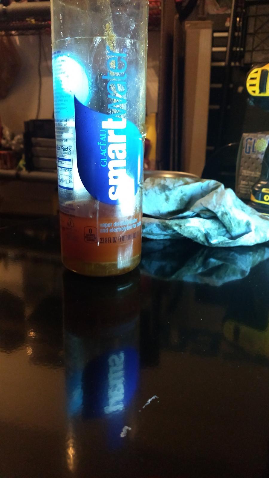

Ask & ye shall receive. Roughly 700 miles since the last time the can was drained. There's a little bit still in there, but i think that it's some residual stuff that i couldn't get clean before. Not the very best pics, but definitely less oil/crap in the intake manifold & Throttle Body.
Thanks for this! I will be interested to know how much will be in the intake tract the next time you check it.
That might be awhile. The tube from the intercooler that connects to the bottom of the intake manifold is a pain in the arse to get back on. Didn't take too long to get off, just a pain to get back on, at least for me.

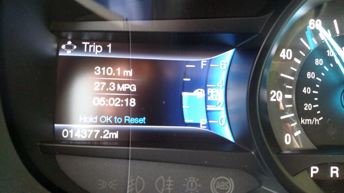

Mileage is pretty decent, the hills of West Virginia & Virginia & North Carolina took their toll overall though.
Mileage on the way back was better. Last picture is right after i filled up, but didn't reset the trip odometer. Calculated was 28.4

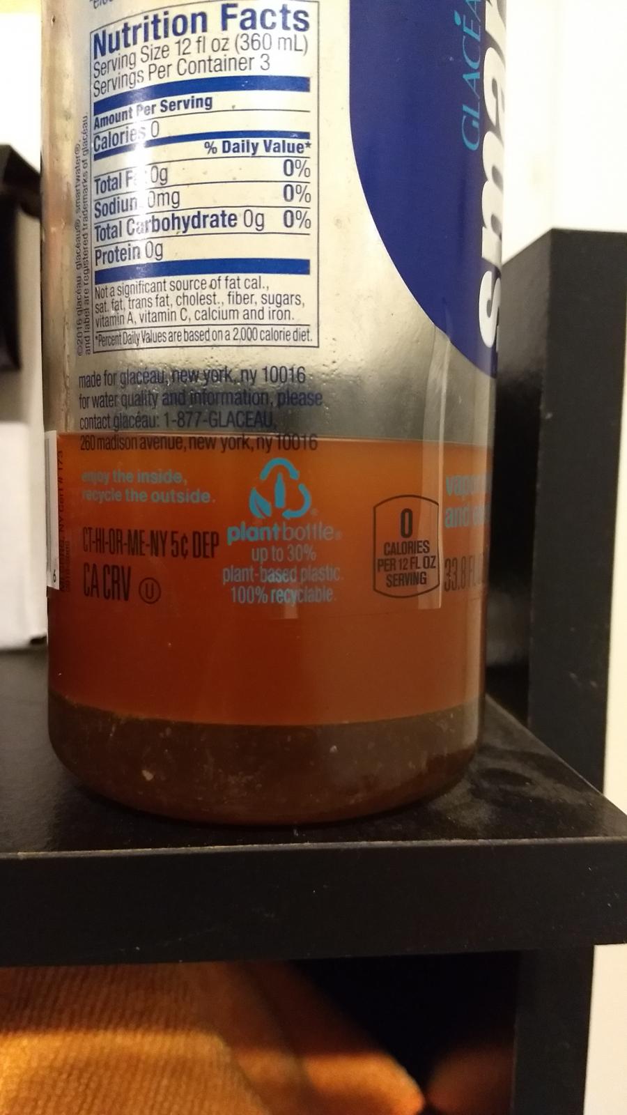

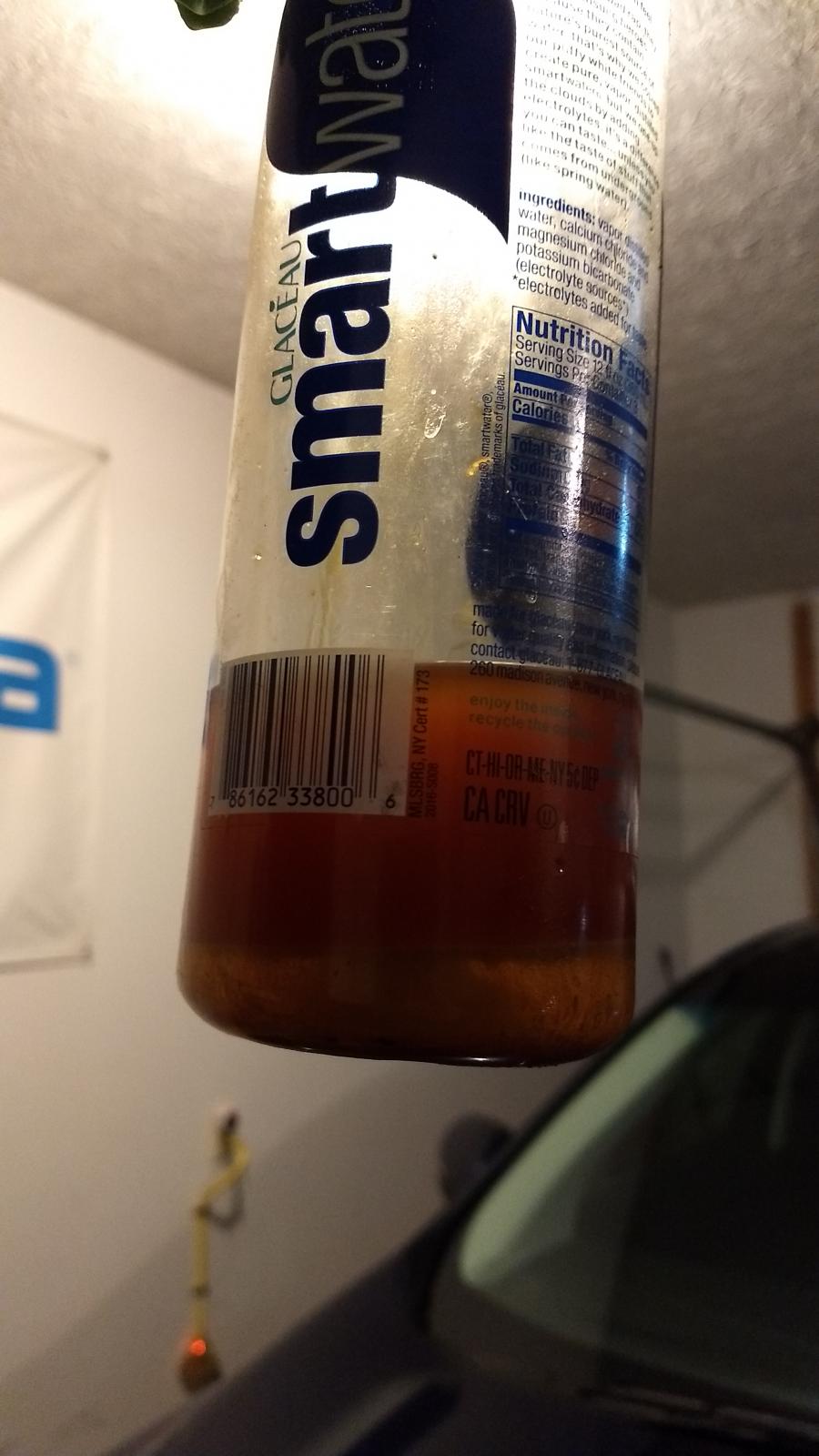

Just a tad below 2100 miles since it was last drained (11/2/17), i decided to drain my Catch Can. I was quite surprised by how much came out. The weather has been in the single digits the last few 2 weeks (some nights/mornings in the negative) & this was the result. Very glad that I have a can to catch this junk:
So what is the consistency of that liquid? Watery or more like oil? Looks like motor oil.
Are you running full synthetic?
It's a mixture of condensation/water, oil & gas. Been running Mobil 1 & do oil changes approximately every 5,000 miles. Note that i DON'T get nearly this much during the summer months (well, I've officially had the oil catch can a year now). I get very few drops, maybe 5 or so all summer long. Temps drop below freezing, i get what's in the pics above.

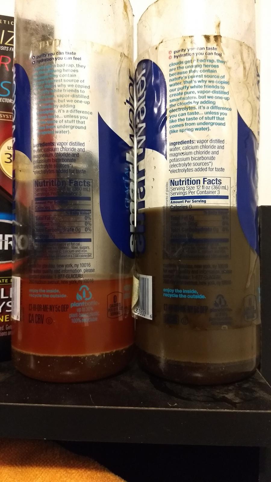

I'd day for about the last month, the temperature has averaged about 38 degrees & the month prior was around 30,i think. Here's a comparison to my 2008 Mazda CX7 w/80,633 miles on it. The CX7 has about 5,000 miles on its oil change
