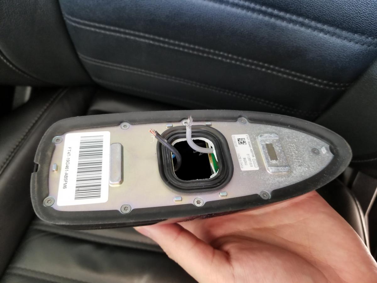

Shark fin antenna comes off. How should I fix it?
bwuzhang
You'll need to replace it (part number should be GT4Z-18936-ACPTM).

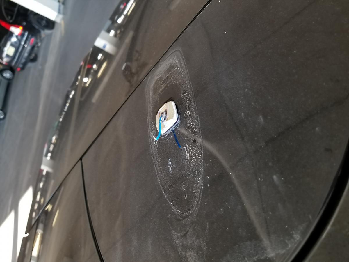

You can see where you snapped the mounting stud/bracket off the antenna (it's still sticking out from your roof).
You'll need to drop the headliner to remove the old/broken bracket and then install the new antenna.
I suppose with enough epoxy and soldering you could repair it, but I would just replace it (potential leaks, etc).
Not sure if the painted cover can be salvaged, as the replacement wouldn't be color matched.
You can order paint matched antennas
