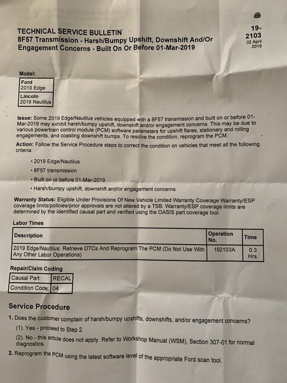

I did not notice it when I test drove it. Just jumped out on the highway and it was 50-60 mph up the road and the same back. As soon as we got it back to our community and slowed down to 20-30 mph it started. I give it a tank of gas thinking maybe it just needed to get broke in a little. Of course, it didn't get better and when I took it back to the dealer I was told it was just normal for this vehicle and there was nothing they could do. I now have a new vehicle that upsets me every time I drive it.

3
I was going to give you a link to a forum post that had several people reporting the same problems I'm having but for some reason, it won't let me. There has been a technical service bulletin issued for the 2019 edge SE model that is doing the exact same thing. I guess the titanium model has a slightly different eight-speed transmission and there have been no upgrades for the software at this time. The dealership service manager went as far as to tell me it was normal.
