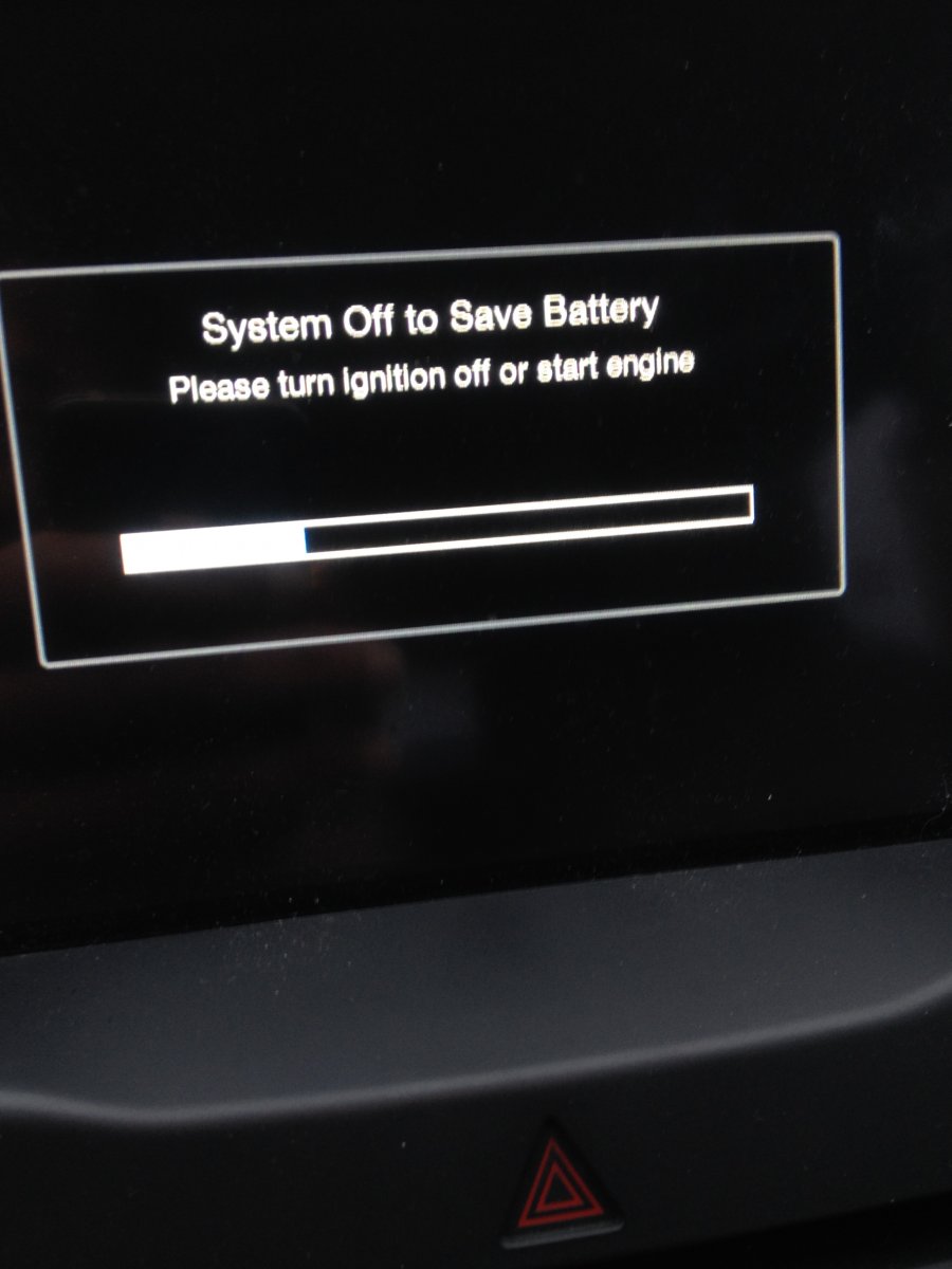

Anyway, I will start for illustrating the problem described by the OP.  Please see pictures below, and then please read my comments.  Hopefully they will generate a respectful and productive discussion:
The picture below was taken on February 14th, 2018 (yeah, a Valentine gift from my Edge  ;), two years ago)
The picture below was taken on January 1st, 2020 (two years later). A happy new year present from my Edge ?  But I have received similar "presents" in between lol.

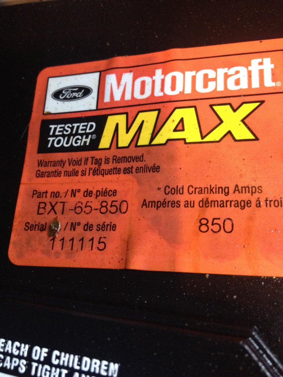

Bac, you did mention that happens when you turn the engine off.  I didn't read it properly; my bad.  And yes, it also has an AGM battery (please see attached picture)

Taking my ex for a Dr's appointment, I dropped her off and then I went to the parking lot to sit in my car and wait while listening to the radio.  As soon as I turned the engine off the audio when off and got the already known warning display.  I then pressed the "Volume" button to turn the radio on: no audio but instead a similar warning message.  Anyway, I decided to do again what I have done before: toggling/cycling the system pressing the "Volume" button several times:
1.- first press of the Volume button results in no radio (a warning reading "System Off to Save Battery" is displayed in the console). NOTE: Please notice that the second line of the message shown in the previous picture ("Please turn ignition off or start engine") does NOT appear again after the engine had been shut off before.
2.- pressing the Volume button again (second time) I got the dashboard lighting on with a warning reading "Accessory Power is Active" (but nothing shown on the console display),
3.- and then pressing the Volume button for third time I got a big square warning on the dashboard reading "Check Charging System" (because all electrical components are on, but the engine is not (of course); nothing shown on the console display).
1.-  Next pressing of the Volume button again (fourth time) takes us back to square one: warning displaying "System Off to Save Battery" (No message second line; no radio on).  So, I decided to start playing with my phone instead while still sitting in the car waiting...

Just to pin point something else: if you folks look at the first picture I posted, you will see the second line reading: "Please turn ignition off or start engine".
Well, the ignition is actually OFF.  Why are we getting that message then?  I think the first line of the message is what makes people think it's a battery problem.  Maybe we should focus on the REASON for the second/bottom line of the message to see where it leads us to look at, if somewhere else...
