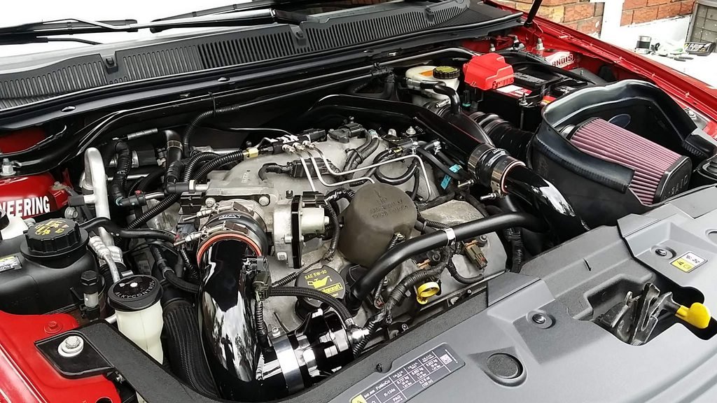

Tunatime1 Report post Posted October 13, 2020 ADDING UPGRADED INTERCOOLER FROM UNLEASHED, WITH RAMBO COLD AIR TUBE + METHONAL INJECTION TO MY 2018 EDGE SPORT. SWAPPING PLUGS, THERMOSTAT + MOTOR MOUNT IN SHOP NOW, TORRIE WILL BE UPDATING TUNE SHORTLY ANYONE ELSE GO THIS ROUTE ? RESULTS ? ISSUES ? I CURRENTLY HAVE CAT BACK CUSTOM EXHAUST , K +N + UNLEASED 93 TUNE ART 1 Share this post Link to post Share on other sites

Special_K Report post Posted October 15, 2020 18 hours ago, Tunatime1 said: WAITING TO SEE WHAT TORRIE AT UNLEASHED COME UP WITH. HE IS RUNNING SAME SET UP ON A FUSION SPORT THANKS ART WHY ARE WE YELLING SO MUCH!?!?!? okay got that out of the way, meth is great on most ecoboost platforms. afterrunning it on the edge we found out it starves cylinder 1&4 and floods 3&6. do not recommend if you like your motor 😉 4 Share this post Link to post Share on other sites
