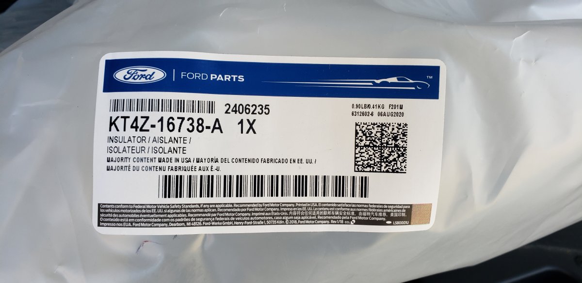

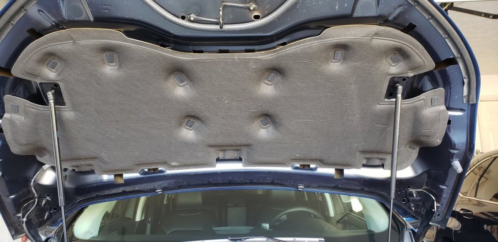

CVCashmere Posted October 31, 2020 Report Share Posted October 31, 2020 Edger's I was able to order the correct hood insulator for the 2019 ST this week and attach it today! For master mechanics, such as myself, it took 6 minutes. The rest of you should be able to do it under 5 minutes...it's that easy! The clips are already attached...just hold up to the hood, and "push and play". I have enclosed a picture of the actual part # on the bag. The engine has always been quiet, this pad absorbs some of the road noise and sounds closer to a Lincoln inside than before. Cost is about $115 plus tax from your local dealer. I received a Mustang Club discount plus they knew I was going install it myself. Thanks CVCashmere 4 Quote Link to comment Share on other sites More sharing options...
lildisco Posted October 31, 2020 Report Share Posted October 31, 2020 Sweet! Ordered tonight, should be here next week! Quote Link to comment Share on other sites More sharing options...
lildisco Posted November 6, 2020 Report Share Posted November 6, 2020 Can confirm that this fits a 2020 SEL. It did take less than 5 minutes to install & came with the clips needed for installation. 2 Quote Link to comment Share on other sites More sharing options...

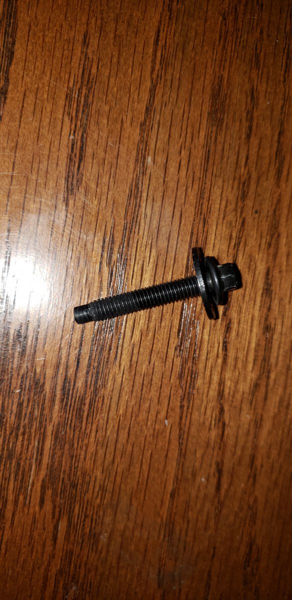

2FAST4U Posted November 15, 2020 Report Share Posted November 15, 2020 (edited) Here: https://www.fordedgeforum.com/topic/27999-engine-cover-for-2020-edge-titanium-20l/?tab=comments#comment-206949 Claude. P.S: The engine cover for the 2.0L engine is # K2GZ-6A949-A The passenger's side stud for the cover is # AG9Z-00812-D ... --> but there seems to be another stud on the driver's side but I haven't found the correct part #... Someone suggested # YF1Z-96P686-AA but I'm not sure this is correct... Does someone here could confirm please? Edited November 15, 2020 by 2FAST4U 1 Quote Link to comment Share on other sites More sharing options...
lildisco Posted November 15, 2020 Report Share Posted November 15, 2020 I can tell you that AG9Z-00812-D isn't the correct part #. These look like bolts for the engine. Not for the engine cover. Quote Link to comment Share on other sites More sharing options...

IcyFridge Posted November 16, 2020 Report Share Posted November 16, 2020 5 hours ago, lildisco said: I can tell you that AG9Z-00812-D isn't the correct part #. These look like bolts for the engine. Not for the engine cover. In the other thread, he says it is a bolt. It shows a bolt sticking through the cover in one of the pictures as well. Quote Link to comment Share on other sites More sharing options...
lildisco Posted November 16, 2020 Report Share Posted November 16, 2020 (edited) What is pictured is in this post what I wanted to order. The above pictures are what was delivered. The bolt that I received looks nothing like the engine grommet that I ordered. Edited November 16, 2020 by lildisco Quote Link to comment Share on other sites More sharing options...
IcyFridge Posted November 16, 2020 Report Share Posted November 16, 2020 2 hours ago, lildisco said: What is pictured is in this post what I wanted to order. The above pictures are what was delivered. The bolt that I received looks nothing like the engine grommet that I ordered. id definitely be asking for the correct part from Autonation. Show them the pics. Quote Link to comment Share on other sites More sharing options...

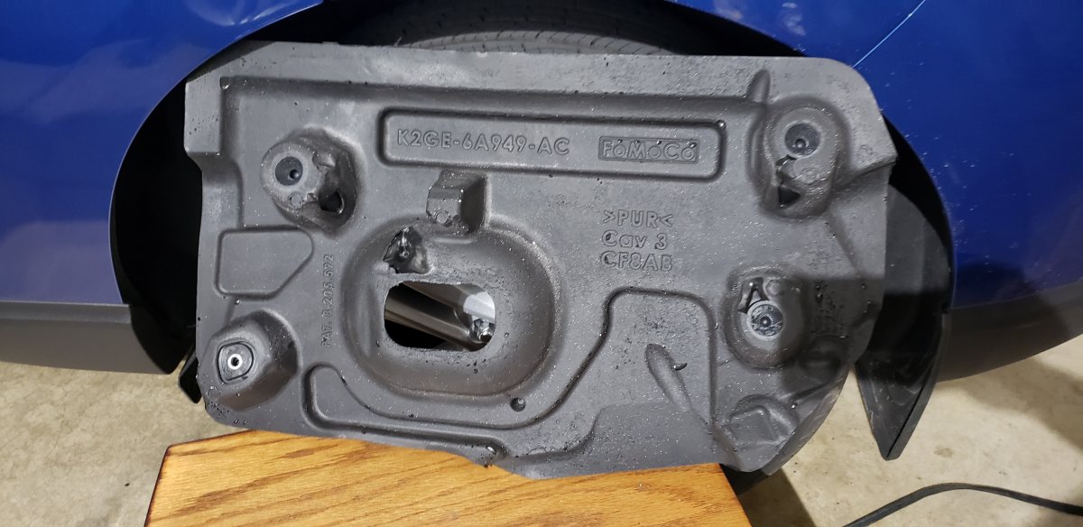

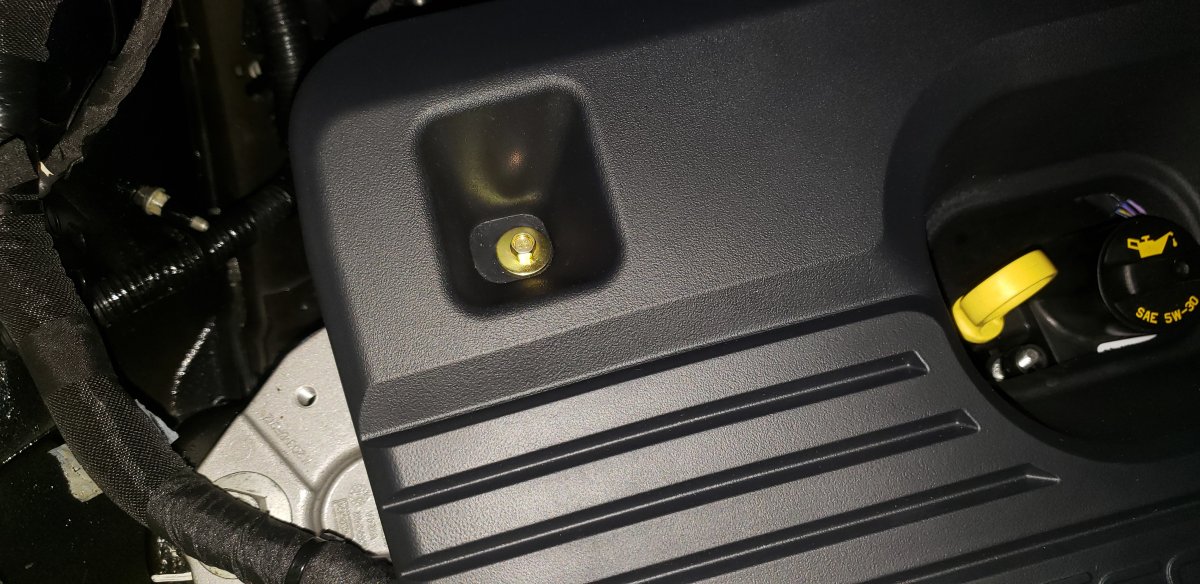

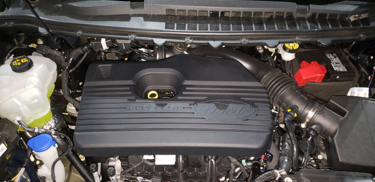

lildisco Posted December 5, 2020 Report Share Posted December 5, 2020 (edited) Engine cover arrived today & promptly did a test fit. There appears to be 3 groment locations. 2 in the front on the intake manifold (already there) & 1 on the drivers side part of the valve cover (threaded bronze location, you can't miss it). Then on passenger side part of the valve cover, there's another location for a washer bolt & an indent in the cover. I was able to take the 7mm bolt off of the intake snorkel & it threaded in perfectly, just slightly too long. Now to visit either an auto parts store or hardware store & see if I can make something work. The cover material isn't anywhere close to the same hard plastic material as the previous generations. This is like a rubberized foam, kinda like a harder version of the Nerf Footballs from 20 years ago. Edited December 5, 2020 by lildisco 2 Quote Link to comment Share on other sites More sharing options...

2FAST4U Posted December 5, 2020 Report Share Posted December 5, 2020 (edited) 1 hour ago, lildisco said: Engine cover arrived today & promptly did a test fit. There appears to be 3 groment locations. 2 in the front on the intake manifold (already there) & 1 on the drivers side part of the valve cover (threaded bronze location, you can't miss it). Then on passenger side part of the valve cover, there's another location for a washer bolt & an indent in the cover. I was able to take the 7mm bolt off of the intake snorkel & it threaded in perfectly, just slightly too long. So if I understand correctly, the three "studs" are already on the engine and there's only one bolt to add, right? ... and one detail i just noted: the part number under your cover is "K2GE-6A949-AC" but the number I found earlier was "K2GZ-6A949-A". Are both number the same or is one made of plastic and the other one (like yours) made of "nerf" foam? Claude. Edited December 5, 2020 by 2FAST4U Quote Link to comment Share on other sites More sharing options...
lildisco Posted December 5, 2020 Report Share Posted December 5, 2020 (edited) There's 2 grommets that are there as they're part of the intake manifold. There's 1 grommet (on the valve cover on the drivers side, bronze colored with nothing in it) & 1 flanged bolt missing ( on the valve cover on the passengers side, also is bronze colored with nothing it). I don't think that the 3rd grommet is really needed, but i can't find it anywhere on Ford's website or aftermarket sites. I'm going to try & stop at a hardware store & see if I can find a flanged bolt to hold the passenger side of the engine cover down. Part # that was ordered was K2GZ-6A949-A. I ordered it back on 10/21/20 & just received it yesterday. This part feels more like a Nerf ball than the hard plastic engine cover for our 2016 2.0 Ecoboost. Edited December 5, 2020 by lildisco 1 Quote Link to comment Share on other sites More sharing options...
lildisco Posted December 6, 2020 Report Share Posted December 6, 2020 Found a $.79 piece at the local hardware store & fits perfectly. Has an 8mm head, but the threads are the same. Slightly shorter than the bolt for the intake snorkel. Don't remember the length. 1 Quote Link to comment Share on other sites More sharing options...
